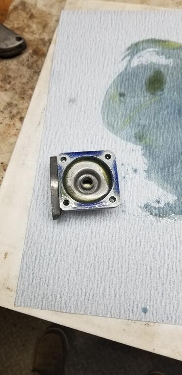

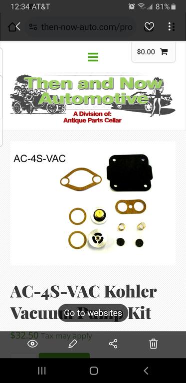

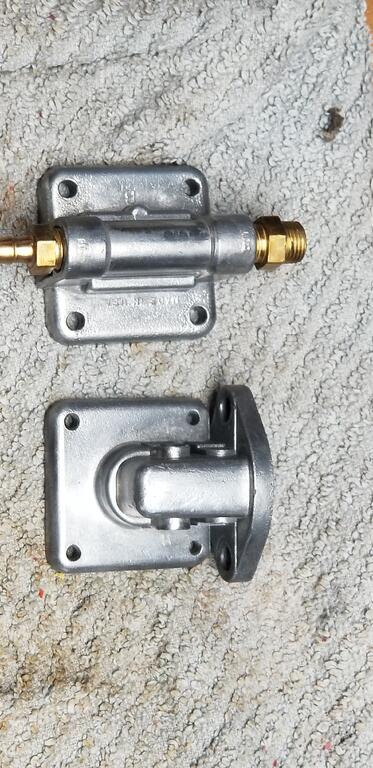

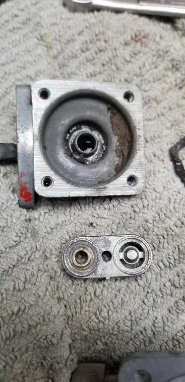

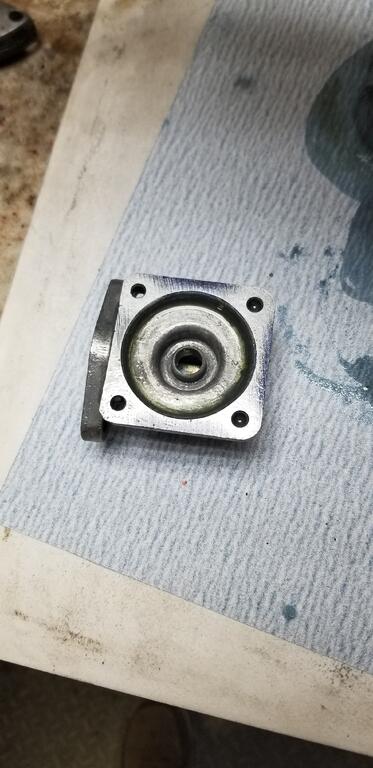

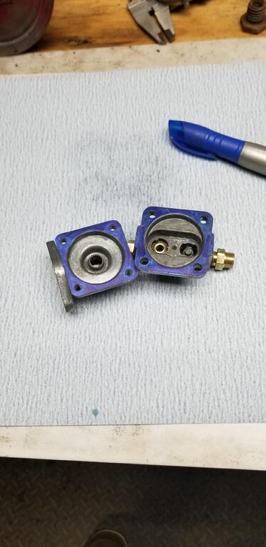

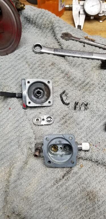

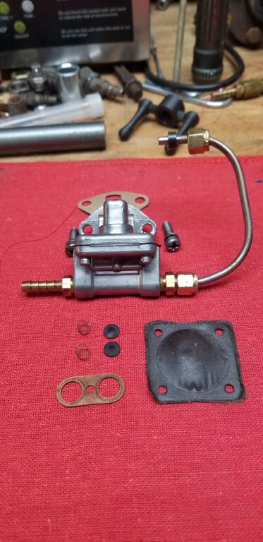

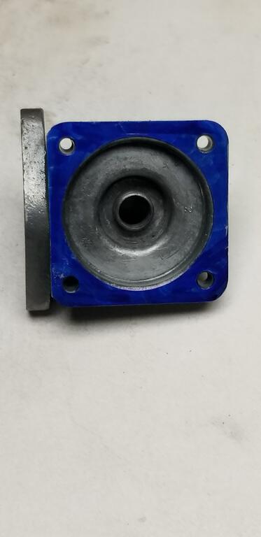

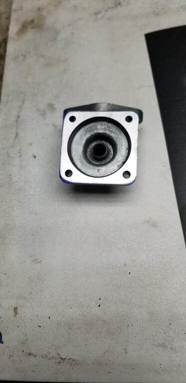

gt14rider 1,278 #1 Posted June 15, 2025 (edited) Hi all, Happy Father's Day, cleaned up the fuel pump for my 856 . Ordered a kit from Now and Then . Had a bunch of crud in it, couple cycles in ultrasonic cleaner and then put both halfs of housings on glass and sandpaper, 220 grit. Put some blue marker on and moved it around in figure 8s you can see the progress in pic's. Put more marker on last pass on 800 grit , cleaned up nicely,. Used 220, 400, 800 grit sandpaper Edited June 15, 2025 by gt14rider Adj pics 1 8 Share this post Link to post Share on other sites
