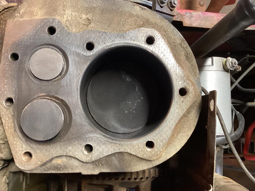

Easton Rich 792 #6 Posted June 12, 2025 Ok, I pulled the head off and I see nothing. I do know it runs really rich because I just rebuilt the carb and haven’t fully adjusted it. Share this post Link to post Share on other sites
nylyon-(Admin) 8,638 #7 Posted June 12, 2025 Maybe it’s just me or the angle of the photo, but that intake valve doesn’t look right 2 Share this post Link to post Share on other sites

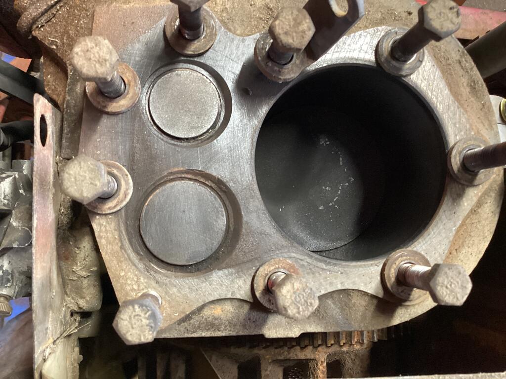

Easton Rich 792 #9 Posted June 12, 2025 But I’ll check it Share this post Link to post Share on other sites
RED-Z06 2,700 #10 Posted June 12, 2025 Did you lift the gasket off the head? Share this post Link to post Share on other sites
Easton Rich 792 #11 Posted June 12, 2025 Here it’s down. You’re right, it’s kinda cock-eyed Share this post Link to post Share on other sites
Easton Rich 792 #12 Posted June 12, 2025 Yes it’s off Share this post Link to post Share on other sites

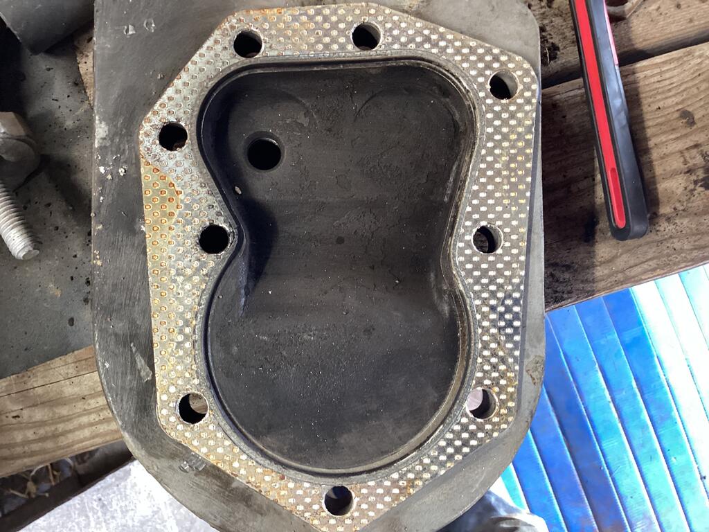

RED-Z06 2,700 #13 Posted June 12, 2025 34 minutes ago, Easton Rich said: Yes it’s off There wasnt any sign of carbon tracking on the head side? Share this post Link to post Share on other sites
Easton Rich 792 #14 Posted June 12, 2025 Explain carbon tracking for me Share this post Link to post Share on other sites
RED-Z06 2,700 #15 Posted June 12, 2025 8 minutes ago, Easton Rich said: Explain carbon tracking for me Evidence left behind by combustion gasses escaping where they shouldn't. You'll see black (carbon) in places where you shouldn't Share this post Link to post Share on other sites
Easton Rich 792 #16 Posted June 12, 2025 I’ll check Share this post Link to post Share on other sites
oldlineman 1,626 #17 Posted June 12, 2025 bent valve stem? Share this post Link to post Share on other sites
Easton Rich 792 #18 Posted June 13, 2025 I pulled the valve and it isn’t bent. I’ll put the head gasket on and see. We’ll see I guess! Share this post Link to post Share on other sites
kpinnc 16,515 #19 Posted June 13, 2025 9 hours ago, Easton Rich said: Ok, I pulled the head off and I see nothing. I do know it runs really rich because I just rebuilt the carb and haven’t fully adjusted it. You pic doesn't show the part of the head under the gasket. While you have the head removed, it may be a good time to resurface the head to make sure it's flat. Even if that isn't the issue it's one thing you can rule out. @ebinmaine has put up a few posts about gently sanding the head flat on a panel of glass. 2 Share this post Link to post Share on other sites
ebinmaine 76,504 #20 Posted June 13, 2025 6 hours ago, kpinnc said: You pic doesn't show the part of the head under the gasket. While you have the head removed, it may be a good time to resurface the head to make sure it's flat. Even if that isn't the issue it's one thing you can rule out. @ebinmaine has put up a few posts about gently sanding the head flat on a panel of glass. I use a particular piece of known flat steel. Definitely agree that it should be done with every cylinder head. Share this post Link to post Share on other sites
oliver2-44 11,137 #21 Posted June 13, 2025 Place you head on a known flat surface (kitchen glass top stove works good). Hold it down firmly and check if a or 0.003 feeler gauge will go under it in any areas. 1 Share this post Link to post Share on other sites
