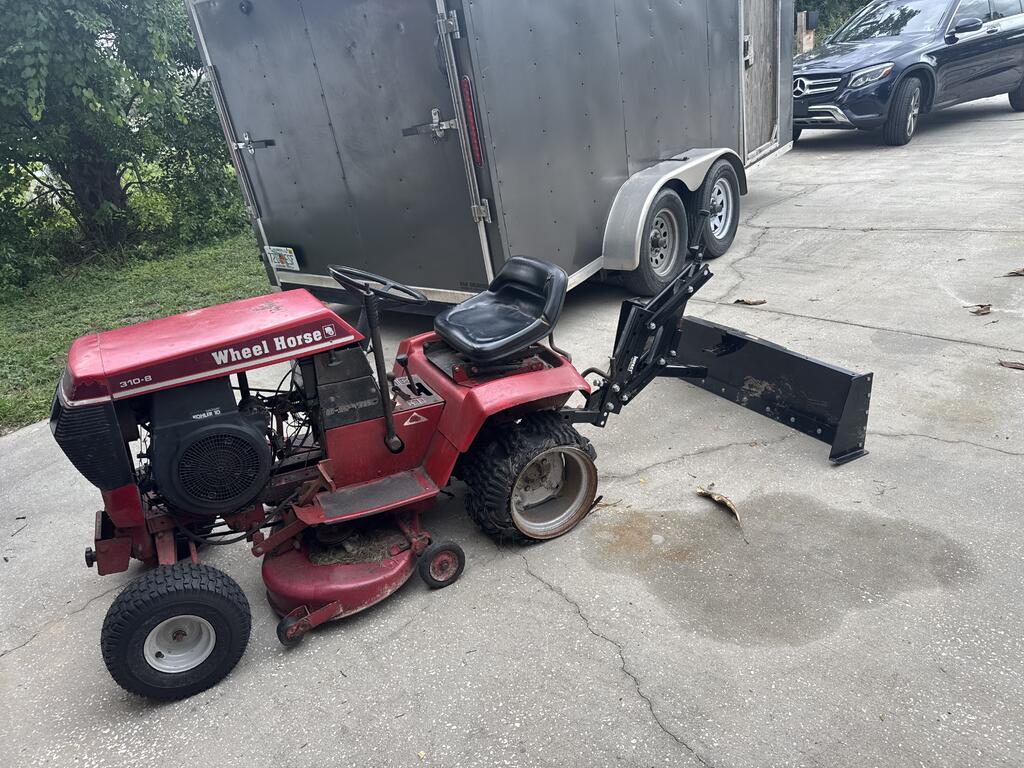

Anderson-310-8 5 #18 Posted September 8, 2025 Hey guys! Just got a 310-8 a few days ago and wanting to restore it. Little rough but runs drives and seems all original. Was kept outside unfortunately for a few years but still used here and there. I am going to do the flush on the trans and wanted to know how it went for OP. Checking the dipstick I can See it’s milky. Getting fresh tires in the mail tomorrow so wanna get it drained today and do the run with diesel tomorrow afternoon. thanks! Very excited for this machine and love this forum seems super positive and informative 😎 2 Share this post Link to post Share on other sites
Handy Don 17,186 #19 Posted September 8, 2025 310-8 is a “base” model, but is tough and strong. It’ll handle that 37” deck without strain and do a credible job with the box blade. Seeing the shreds of rubber remaining on those rims, I’d give a careful check before mounting new tires--no dents, bead seat smooth and clean, valves well sealed to the rim? 310-8 was my first WH some years ago. It has moved on but is still in service. Share this post Link to post Share on other sites
Anderson-310-8 5 #20 Posted September 8, 2025 Got a (good buddy) local tire shop throwing them on now actually, just finished a oil change, dumping trans fluid and added diesel to do a flush run once I get the call the tires are ready, he said he’d round the rims back out if needed. blades are beyond shot gonna get a new set soon. For $275 with the blade I can’t complain! Also gives me a new project to strip it down and rebuild it up 😃 2 Share this post Link to post Share on other sites
