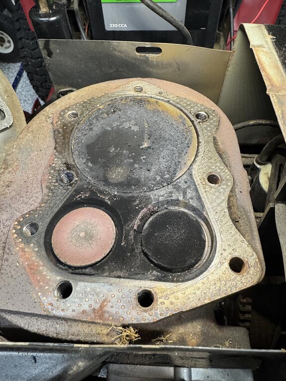

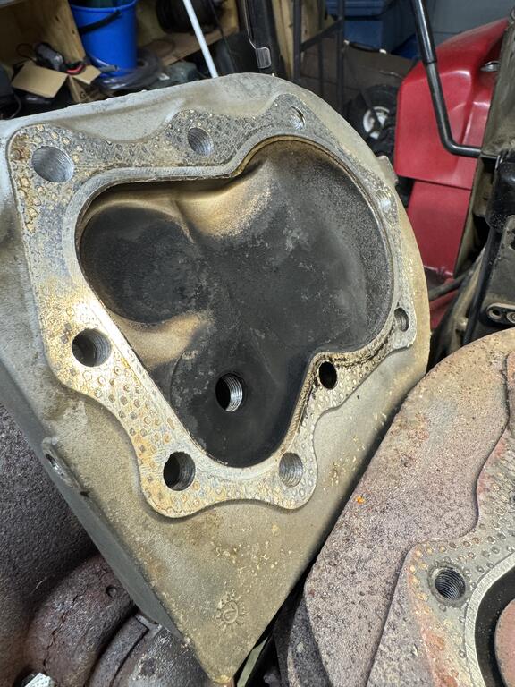

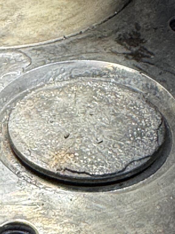

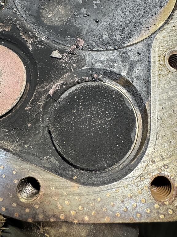

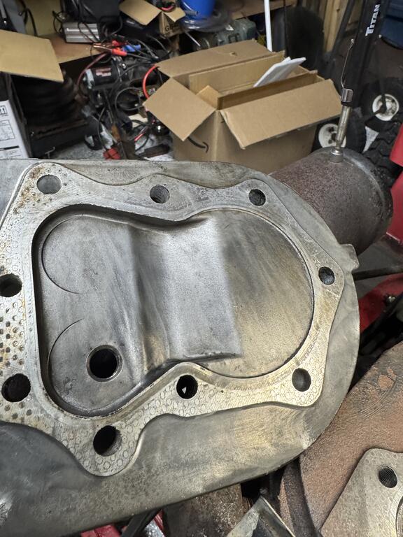

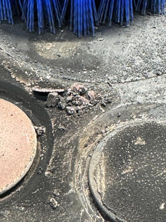

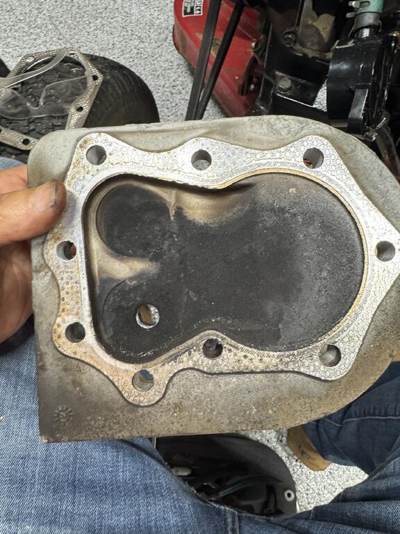

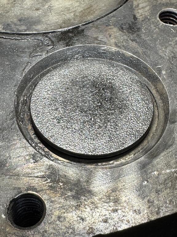

PWL216 1,148 #6 Posted June 14, 2025 @ineedanother @wallfish @ri702bill pulled the head and valve covers off today. There was a lot of carbon buildup and some flakes around the exhaust valve. I had done a leak down test prior to and was getting air coming thru the muffler - so I expected the exhaust valve would be dirty. I used the dremel to clean it up and I think I got at least most of it. My question is, based on the pics you see, should I lap the valves in? Also, I still need to adjust both valves since it seems I have zero clearance on each. Thx again for the prior guidance. Paul Share this post Link to post Share on other sites
ineedanother 1,870 #7 Posted June 14, 2025 Well, I think you found your problem being hard to start. Low RPM = low compression but might run okay at working speeds. I'm not a big fan of lapping old valves but depending on the condition of the seat and face, there could be some benefit. I would probably just clean everything up, adjust the lash, check the head for flatness and get it put back together but I'm no expert with engines so others might have more reliable advice. 1 Share this post Link to post Share on other sites
ri702bill 11,254 #8 Posted June 14, 2025 (edited) Paul - that exhaust valve is of concern. Way too much carbon built up that could (did??) get loose and caught between the valve and seat and cause issues. Since you plan to adjust the valves & you have the breather removed, why not just pull the valves to check for pitting on the faces & seats?? Lapping is not a bad idea to verify that there is even full diameter contact. (The same can be done with a Sharpie - less mess to clean up.) Chuck both valves up in a low speed drill or lathe and spin them to visually check if they are bent.... Inspect the valve stems & guides for out of spec wear. A valve that wobbles in the guide does not seat evenly all the time... Bill Edited June 14, 2025 by ri702bill Share this post Link to post Share on other sites
lynnmor 8,623 #9 Posted June 14, 2025 Pull the valves and do a proper valve job, lapping is shortcut to do a less than ideal repair. 1 Share this post Link to post Share on other sites
PWL216 1,148 #10 Posted June 15, 2025 1 hour ago, lynnmor said: Pull the valves and do a proper valve job, lapping is shortcut to do a less than ideal repair. @lynnmor I thought lapping the valves is considered a ‘proper’ valve job. No? Share this post Link to post Share on other sites
lynnmor 8,623 #11 Posted June 15, 2025 13 hours ago, PWL216 said: @lynnmor I thought lapping the valves is considered a ‘proper’ valve job. No? NO Grinding the valves to the proper angle and grinding the seats to the proper angle with the diameter and seat width is the proper way. Lapping will not correct anything. 1 1 Share this post Link to post Share on other sites
