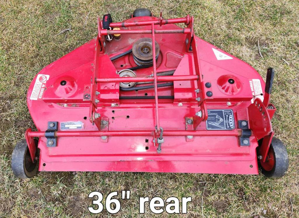

gwest_ca-(File Mod) 12,254 #4 Posted June 11, 2025 Might be a 36" width of cut? Click on the picture in this link Share this post Link to post Share on other sites
BHpa 8 #5 Posted June 11, 2025 oh. Do you measure cutting width or the whole width of the deck? If it's just cutting width then yeah, I guess it's a 36. Sorry for my ignorance. Share this post Link to post Share on other sites
nylyon-(Admin) 8,938 #6 Posted June 11, 2025 2 blades or 3? I am not aware of a 37” RD deck, 36 and 42” RD yes, but not 37. Assuming it’s 36” your belt is likely Drive belt 102741 (1/2" x 96.6") or (Gates replacement BladeRunner 6638BR 17/32" x 96.75") Share this post Link to post Share on other sites

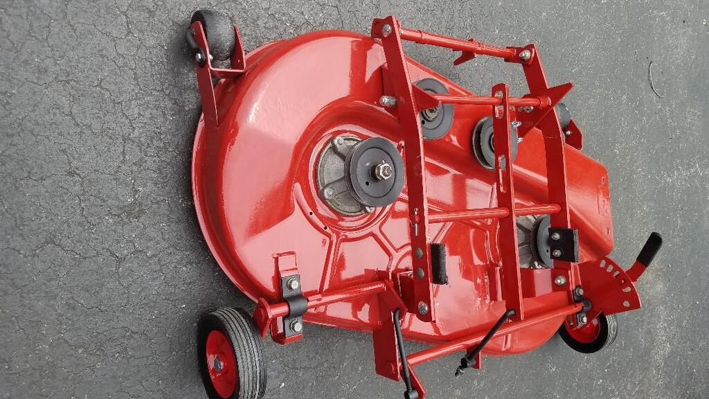

Brockport Bill 2,371 #9 Posted June 12, 2025 a 37 is a side discharge with 2 spindles above the deck -- there are 2 rear discharge models -- one is a 36" with 3 blades and only one front roller in the middle of the front of the shell - -- the 42" rear discharge has 3 blades - and 3 front rollers one in the middle and one on front of the shell but at 10 and 2 oclock measurement models are width of cut not the shell measurment 1 Share this post Link to post Share on other sites
Brockport Bill 2,371 #10 Posted June 12, 2025 if in fact the mower deck is 36 inch rear discharge??? - its likely 05-36mr ---- with an end number of either 01 up to 05 -- from beginning of 1980s to about 1990 or '91 the 36 inch rear discharge deck on partstree.com and toro parts online indicate belt # 8411 - approx $25 if you look at the 36 inch rear in the photo you will see the location where the decal would be Share this post Link to post Share on other sites
Brockport Bill 2,371 #11 Posted June 12, 2025 when you say the belt you bought is a "tight fit" be mindful the belt has tension from the tension bar and its spring riding on the idler pulley---------------------- as an fyi Belt #8411 is 77 inches by 1/2 -- therefore you can remove belt and measure with cloth tape measure -- or use piece of string to mirror belt oval and determine correct length. Share this post Link to post Share on other sites

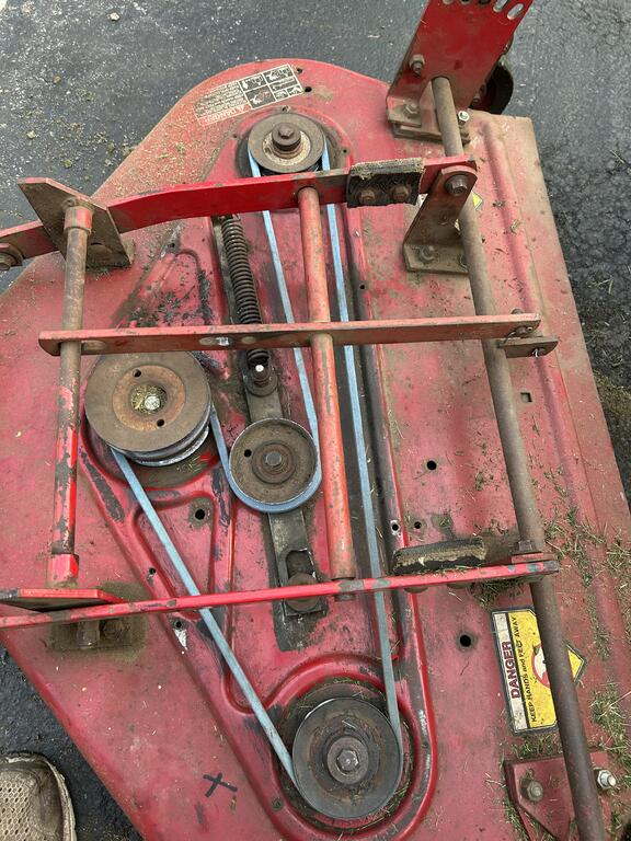

BHpa 8 #13 Posted June 12, 2025 Thank you all so much, this is incredibly helpful. Picture posted below, but yes, given the pictures above it's a 36" - 3 blade. I must have measured wrong. Given what you all have said, it's no wonder the belt was really tight. I was putting a 76" belt on there. Looks like I need a 76.5 or 77". To get the 76 on I had pull the tension bar and spring all the way just to get it even close. Thank you so much! Also, please don't judge me for the sad state of my mower deck. 1 Share this post Link to post Share on other sites
Handy Don 16,676 #14 Posted June 12, 2025 5 hours ago, BHpa said: Nothing wrong with a deck that shows it been worked. That'll be just fine once you put the pulley cover back on. Go mow! Share this post Link to post Share on other sites
Brockport Bill 2,371 #15 Posted June 12, 2025 good luck - we all keep learning and benefit from others experience and info sharing -- cosmetic looks are nice but of course the equipment operating as it should is what's most important. key issue is to keep underneath clean from debris build up so blades cut well and discharge the clippings well - and to oil the underneath of deck shell to avoid clippings sticking -- and to wash underneath deck end of season then oil underneath surface before winter storage - and of course to prevent rot of the shell - then the obvious to keep spindle bearings lubricated (or replace ) - and be sure you remove belt periodically to test the pulleys that they each turn freely - also examine the slot of the torsion bar - - those wear and need a replacement sometime over the life of the deck - I use leaf blower after each mowing to clean loose grass/dirt etc -- and power wash underneath every 4-5-6 mowings - - and avoid cutting wet grass to prevent clogged shell -- have fun !! Share this post Link to post Share on other sites
