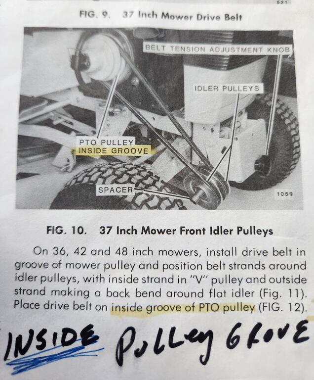

Brockport Bill 2,425 #4 Posted June 11, 2025 one other note Mike for him - i have lift blade on mine for the bagger to function properly -- if he has bagger which is what those 37s are designed for ( although not required )... then he will want that lift blade design - - Also be prepared .. the belts are $$ expensive - also suggest he carefully read the manual for the belt deflection between mule and pto at 1 inch so that belt does not "roll over" or "twist" or it will wear quickly as well as not function properly. Share this post Link to post Share on other sites

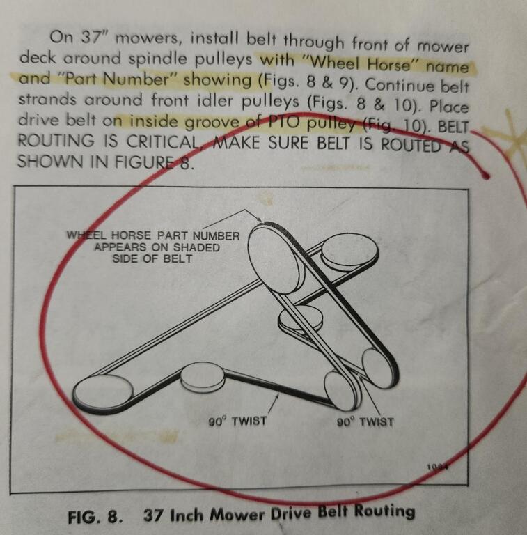

Brockport Bill 2,425 #6 Posted June 11, 2025 belt routing - important 1 Share this post Link to post Share on other sites
