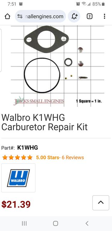

gt14rider 1,281 #10 Posted June 10, 2025 Jack's small engines , will this work? 1 Share this post Link to post Share on other sites
Wheelhorse4me 4 #11 Posted June 10, 2025 Thanks very much to all for your input! I've ordered the kit/hope to get it installed this weekend. 1 Share this post Link to post Share on other sites
