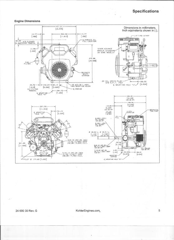

gwest_ca-(File Mod) 12,505 #4 Posted June 9, 2025 Maybe you could make a mockup of the dimensions on cardboard and cut out to see if it would fit. The dimensions are on page 5 of this service manual 2 Share this post Link to post Share on other sites

cod 136 #8 Posted June 9, 2025 Thanks for the responses, and with Gary's help the manual has a dimension page and it looks like it comes with 1.125 PTO plus it will fit under the 418 hood. The height of the PTO is roughly the same as the M-18 and one set of mounting holes (7.25") will line up with the mounting plate the M-18 rests on. I suspect I'll have to make a new mounting plate and I need to see what the muffler would look like. I think it mounts lower than the M-18 but I'd prefer to not "customize" the hood. Share this post Link to post Share on other sites
