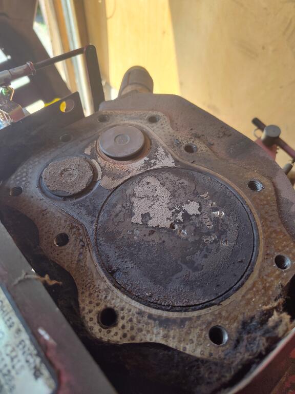

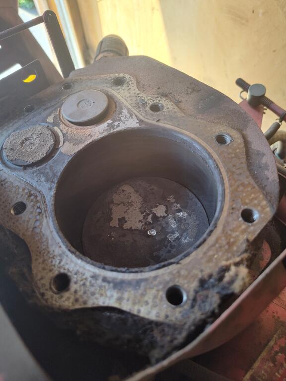

pylp 6 #46 Posted June 11, 2025 Well pulled the head and this is what I got a bent valve and a screw on the top of the piston Share this post Link to post Share on other sites
RED-Z06 2,716 #48 Posted June 11, 2025 Just now, pylp said: This is at TDC Bingo. Piston looks okay but that valves seen better days. Possibly an air filter housing screw, or a butterfly screw. Share this post Link to post Share on other sites
pylp 6 #49 Posted June 11, 2025 Lmao ok so what's next could I fix the bent valve I wish Ive done that sooner Share this post Link to post Share on other sites
pfrederi 19,875 #50 Posted June 11, 2025 Just now, pylp said: Lmao ok so what's next could I fix the bent valve I wish Ive done that sooner You replace bent valves there is no fixing. Will need to check the valve guides. Intake valve looks pretty crusty. I suppose you could clean it but I would get a new one for that also. Share this post Link to post Share on other sites
