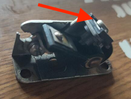

pylp 6 #13 Posted June 6, 2025 (edited) I reset my point to .020 and popped new plugs in still turns no start but i have a question on the points assembly should the bottom screw that holds the wire ever touch the metal tab at the bottom of the assembly bc mine never does through the entire cam stroke also could points just go bad I cleaned them very thoroughly still nothing the is the assembly sideways the screw to the right side on top never touches the metal colied tab also I've noticed after trying to turn it over a couple times the carb leaks gas from the float idk why it's a brand new carburetor only ran 4 times and ran fine till now Edited June 6, 2025 by pylp Share this post Link to post Share on other sites
WHX?? 57,797 #14 Posted June 6, 2025 41 minutes ago, pylp said: couple times the carb leaks gas from the float idk why it's a brand new carburetor Any chance it's an offshore carb? If so could be your problem right there. The screw that holds the point spring down and captures the coil terminal must be isolated from ground. Share this post Link to post Share on other sites

Handy Don 17,316 #16 Posted June 6, 2025 This terminal, and the wire to the coil connected to it must not be grounded except when the points are closed. Share this post Link to post Share on other sites
pylp 6 #17 Posted June 6, 2025 (edited) Yes handy don when the points are closed that screw still does not touch anything I have sat and rotated my crank multiple times watching it the points just open close but nothing on that screw Edited June 6, 2025 by pylp 2 Share this post Link to post Share on other sites

pylp 6 #19 Posted June 6, 2025 (edited) I have tried the spark plug out and it does spark i bought a pack of new ones. Now could the condenser being bad cause no start even with spark or they go hand and hand. I'm trying to rule out if it's just the condenser. I did a pretty good job clear the carb tho I checked all my valves and passages after the cleaning I could see daylight through all it was a complete disassembly and cleaning I've probably cleaned 20 carbs by now if not more so Im confident it's clean but functional is another thing because it is a offshore thank you lastly what would the no 12volts at the coil mean? Edited June 6, 2025 by pylp Share this post Link to post Share on other sites
