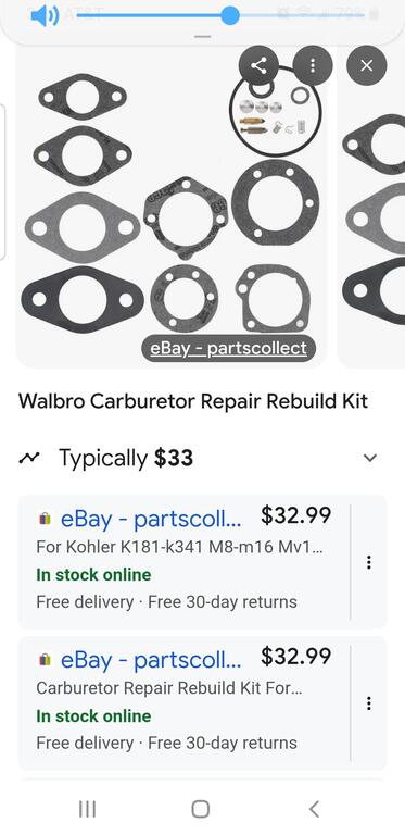

Horse Fanatic 51 #1 Posted June 4, 2025 Hi, I need to clean the carb on my 418A, I do not see any rebuild kits listed for the Walbro 5205318 carb that is on it. Does anyone know of a compatible kit that at least the bowl gasket and needle are the same? Thanks Share this post Link to post Share on other sites
gt14rider 1,281 #2 Posted June 4, 2025 Put in walbro 5205318 rebuild kit this popped up 1 Share this post Link to post Share on other sites
Horse Fanatic 51 #3 Posted June 4, 2025 Thanks! I couldn't come up with that searching on google or eBay, but I found that vendor on eBay and went through his listings and found it that way. Appreciate it! 1 Share this post Link to post Share on other sites
