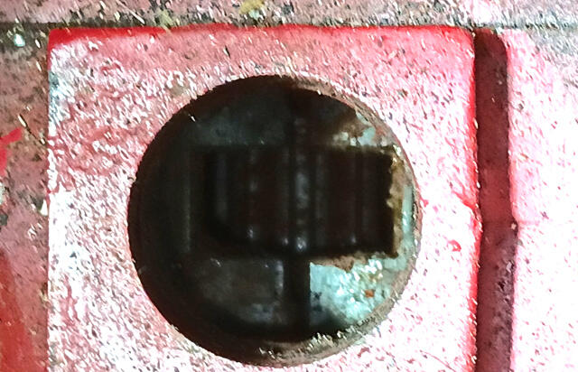

stevasaurus 23,781 #7 Posted June 3, 2025 Hey Teddy, it's been a long time since you have been on here. Good to hear from you. Pull the shifter and look in there and see what it looks like (see pick above). I would think nothing is broke, just surface rust keeping things form moving. I would not try to start it with the drive belt on. You could fill it up with diesel and keep trying to move the shifter once in a while. But, you know, the best thing is to drop the trans and open it up. You will probably only need the case gasket and a wire brush. BTW...How are you doing these days??? 5 Share this post Link to post Share on other sites

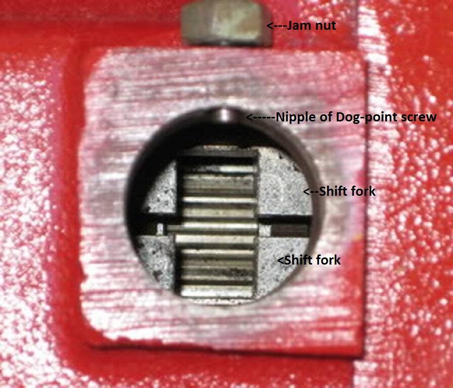

WHX?? 57,629 #9 Posted June 4, 2025 (edited) 15 minutes ago, Teddy da Bear62 said: How do you manipulate it with screwdriver? Forks move pretty easily? Pry on the blocks that the shifter ball rides against. Yes the forks should move somewhat easily. You may have have to jiggle the input pully and rock the tractor abit to facilitate the forks movement. After you pull the shifter look at the forks. Have a flash light with you. They should be centered like the pic. One of the blocks should always be centered. The other to the left or right but never both to the left or right at the same time. BTW please don't start a thread with XXX give away... has a tendency to put the boys here in a frenzy when they think a tractor is free... Edited June 4, 2025 by WHX?? 5 Share this post Link to post Share on other sites

Teddy da Bear62 172 #11 Posted June 4, 2025 3 hours ago, oliver2-44 said: Kind of like a school of Piranha when fresh meat is thrown in. OK Maybe more like a flock of Yard Birds when you throw out the left over fishing worms. Heyyyyyy!! I had to make sure my mundane post would get some attention !! Right?? Free wheel horse is usually an eye grabber! 🤣🤣🤣 Ok.... News is not good. Pulled the shifter. It was indeed in neutral. Two forks toward front of tractor move. Rear two forks will not budge. Tranny was dry as a bone. We are getting kerosene next and filling it up. And I am giving the tractor to my friend. It's a free one! 2 1 Share this post Link to post Share on other sites
