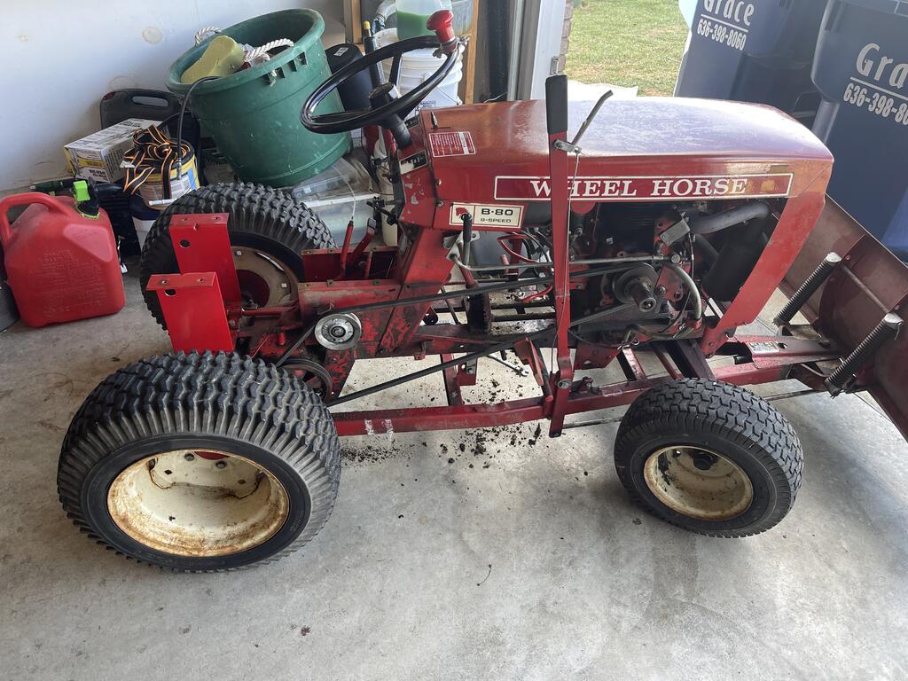

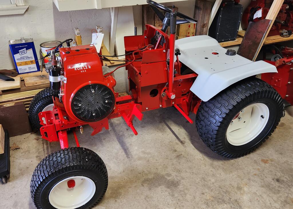

stvski80085 279 #1 Posted June 3, 2025 (edited) I have read all the other posts on wheel color. It appears my B-80 is really just semi-gloss white. The Primary owner I bought it from said it's all original. I do like the white better then almond color. I know another member here has a 77 B-80 and I'm curious if his are also just white. Any thought's? I'm getting ready to buy so I can put new tires and paint rims starting this weekend. Steve I know it's not the best pic below but you can get an idea. Edited June 3, 2025 by stvski80085 Share this post Link to post Share on other sites
ebinmaine 79,504 #2 Posted June 3, 2025 They're not white out of the factory. It's a light off white that's close to Rust-Oleum 2x Cottage white. If an original owner claims that they are pure white color out of the factory, then it would have been a unicorn. Possibly painted at the dealership. Share this post Link to post Share on other sites
Achto 32,035 #3 Posted June 3, 2025 25 minutes ago, stvski80085 said: It appears my B-80 is really just semi-gloss white. They would have been gloss white from the factory, they have just faded to a semi-gloss. International Harvester off white is a pretty close match. 4 Share this post Link to post Share on other sites

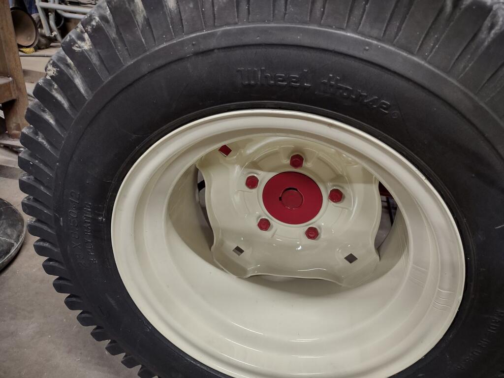

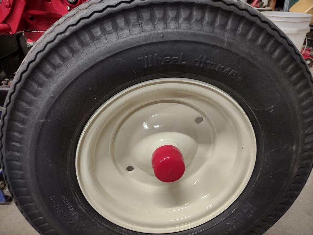

Lane Ranger 12,023 #4 Posted June 3, 2025 6 minutes ago, Achto said: They would have been gloss white from the factory, they have just faded to a semi-gloss. International Harvester off white is a pretty close match. Yes I used that International Harvester off white on my B080 Dan1. But Rustoleum Antigue White is not too far off ! 3 Share this post Link to post Share on other sites

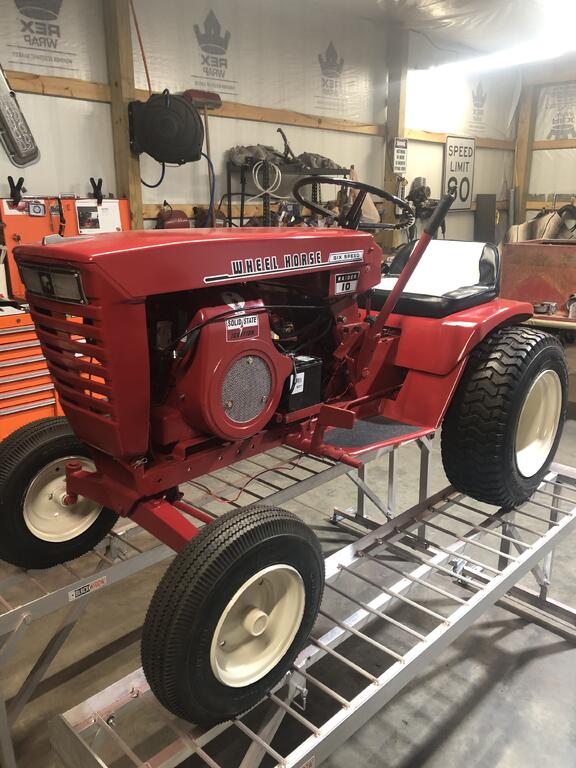

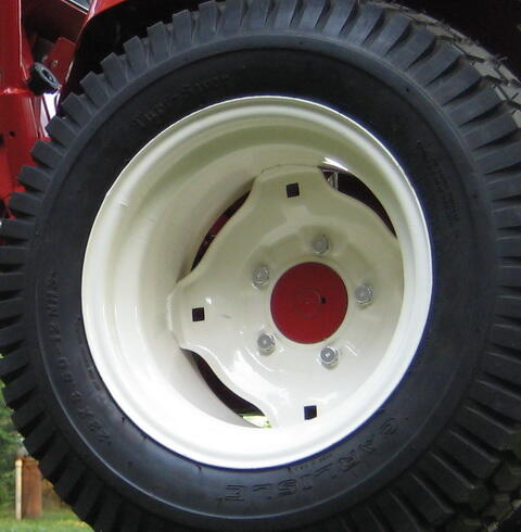

rmaynard 17,409 #5 Posted June 3, 2025 My 1977 B-100 (same rims as the B-80) were an off-white. When the tires were removed, the inside of the rims were color matched to a powder-coat color called Oyster White, RAL-1013. Here is a picture of them back on 2010. 1 3 Share this post Link to post Share on other sites

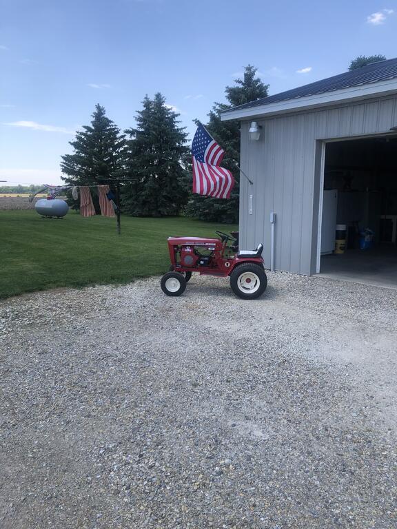

AlexR 3,056 #6 Posted June 3, 2025 Here is a picture of my two tractors painted Rust-Oleum one is navajo white now cottage white the other is just regular plain white. I have since painted the plain white one the cottage white color I like it better. 3 Share this post Link to post Share on other sites
stvski80085 279 #7 Posted June 3, 2025 53 minutes ago, AlexR said: Here is a picture of my two tractors painted Rust-Oleum one is navajo white now cottage white the other is just regular plain white. I have since painted the plain white one the cottage white color I like it better. Tough decision. This picture is perfect for the compare. I really like the white kinda matching the decal white. I also want to keep it somewhat factory but it is a worker. Thanks everyone for the help. I will post a picture when I get done. I will have many sets to do as I have about 4 sets of rear wheels now. I guess I could mix it up for fun. Steve 3 Share this post Link to post Share on other sites

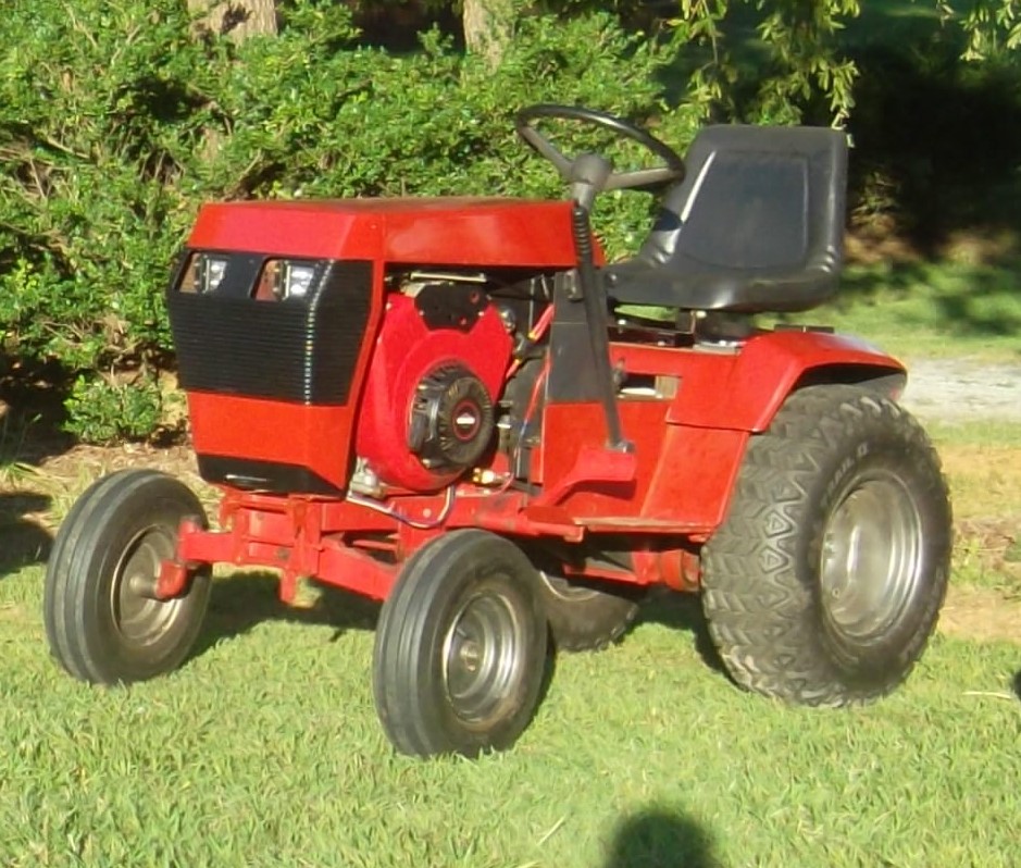

ebinmaine 79,504 #9 Posted June 3, 2025 3 hours ago, stvski80085 said: Tough decision. This picture is perfect for the compare. I really like the white kinda matching the decal white. I also want to keep it somewhat factory but it is a worker. Thanks everyone for the help. I will post a picture when I get done. I will have many sets to do as I have about 4 sets of rear wheels now. I guess I could mix it up for fun. Steve Really what it comes down to is this. IT'S YOUR TRACTOR. Have fun. Be safe. Enjoy the machines in whatever way you can. Trina and I have done five full frame off restorations and several mechanical only ones as well. ALL of ours are workers. They get cleaned up and painted right. Then they get scratched up and repainted later. It's all good. I'm not generally a fan of dark colored wheels on anything at all but @Sparky has done several sets in a sort of battleship grey. They look sharp too. 1 1 Share this post Link to post Share on other sites
