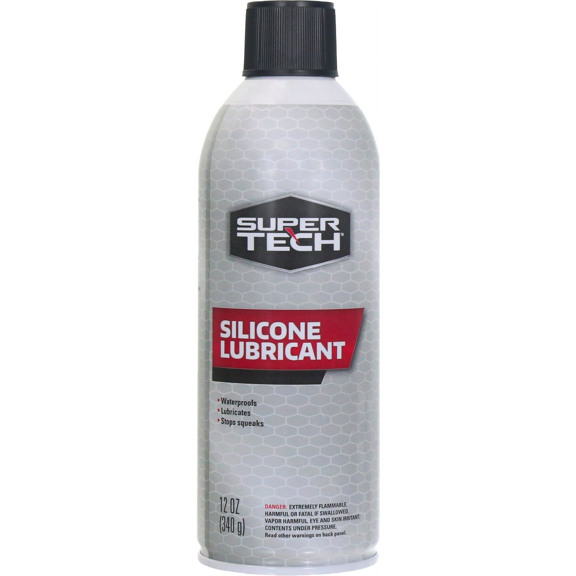

Ed Kennell 42,449 #7 Posted June 2 Spray all the rubber parts till it goes away. 1 Share this post Link to post Share on other sites
ri702bill 9,635 #8 Posted June 2 12 minutes ago, Ed Kennell said: Spray all the rubber parts till it goes away. Unless there is no longer any rubber left there, leaving metal on metal. That can make more noise than a cranky Mother-in-Law does... Share this post Link to post Share on other sites
