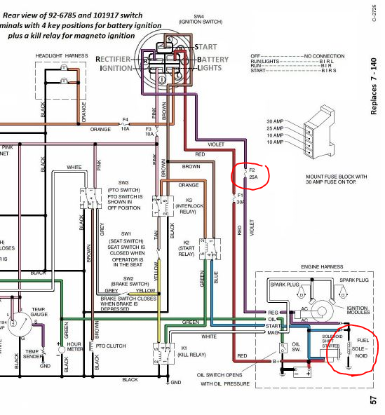

JoeM 10,155 #7 Posted May 31, 2025 Like 953 nuts said follow the Violet line. I have seen the F2 fuse get loose and have bad contact. just a thought. 18 hours ago, 953 nut said: If it is a unit that has the carburetor with a solenoid fuel **** off built into it I would take a look at the wiring going to it. 1 Share this post Link to post Share on other sites

rivahmon 2 #9 Posted May 31, 2025 3 hours ago, JoeM said: Like 953 nuts said follow the Violet line. I have seen the F2 fuse get loose and have bad contact. just a thought. That diagram is much better than I have found. What is it from? Share this post Link to post Share on other sites
JoeM 10,155 #10 Posted May 31, 2025 520xi and 522xi Electrical File Toro.pdf 6 minutes ago, rivahmon said: That diagram is much better than I have found. What is it from? Share this post Link to post Share on other sites
rivahmon 2 #11 Posted May 31, 2025 18 minutes ago, JoeM said: 520xi and 522xi Electrical File Toro.pdf 2.28 MB · 0 downloads Thanks so much. 1 Share this post Link to post Share on other sites
