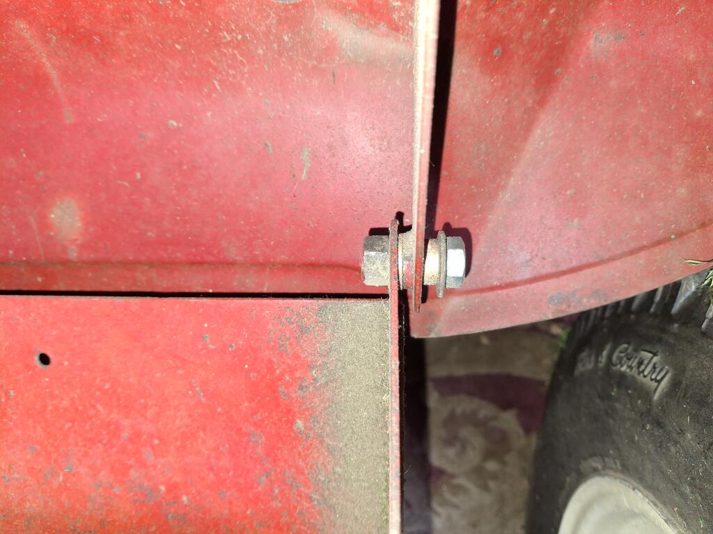

Pullstart 68,842 #1 Posted May 29, 2025 I’m looking for bushings for Rylee’s 875, among maybe more machines we have that could use them. The local ACE has no such items. I even considered a shoulder bolt, but didn’t find anything close there either. Thoughts, ideas or suggested modifications are welcome to get this seat level again! thanks! 1 Share this post Link to post Share on other sites
ri702bill 11,230 #2 Posted May 29, 2025 Kevin - are those flanged bushings?? A sketch with ID, OD length, etc and material would be helpful.... 1 Share this post Link to post Share on other sites
WHX?? 54,840 #3 Posted May 29, 2025 You talkin where it pivots? 2 Share this post Link to post Share on other sites
squonk 45,452 #4 Posted May 29, 2025 I have redone my 875 with bushings from McMaster. Will get a pic later 2 Share this post Link to post Share on other sites
gwest_ca-(File Mod) 11,992 #5 Posted May 29, 2025 Automotive door hinges often have flanged bronze or nylon bushings for the pin. Perhaps a body shop could help. From my GM experience. 4 Share this post Link to post Share on other sites
squonk 45,452 #6 Posted May 29, 2025 The fender pan was wallowed out. I found bushings that fit the shoulder bolts rear tunnel and drilled the fender pan to fit. 3 Share this post Link to post Share on other sites
