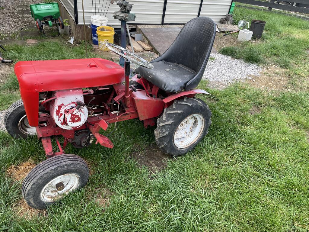

jb4249 143 #1 Posted May 29, 2025 I brought this 604 home today to maybe revive it.. but what is the thing hanging underneath? 3 1 Share this post Link to post Share on other sites
ineedanother 2,866 #2 Posted May 29, 2025 Alternator. Not NOS The chair, I mean seat is a nice touch. 1 Share this post Link to post Share on other sites

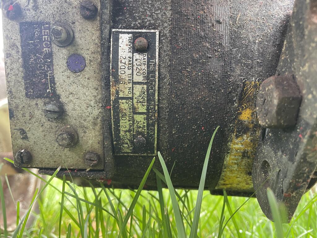

J854D 145 #3 Posted May 29, 2025 Looks like a Leece-Neville alternator. They were used on heavy trucks and equipment. It looks like the tag says 14 volts & 130 amps. (hard to read) I worked on those units back in my days in an auto electrical repair shop. That thing will sure keep your battery charged and run all sorts of accessories if the 6 HP engine will be able to spin it under load! It would be interesting to know the history of your tractor/alternator! 🤔 -JD- 2 Share this post Link to post Share on other sites
sqrlgtr 3,950 #4 Posted May 29, 2025 but what is the thing hanging underneath? I vote, counterbalance for chair 2 5 Share this post Link to post Share on other sites
ebinmaine 80,743 #5 Posted May 29, 2025 7 hours ago, J854D said: Looks like a Leece-Neville alternator. They were used on heavy trucks and equipment. It looks like the tag says 14 volts & 130 amps. (hard to read) I worked on those units back in my days in an auto electrical repair shop. That thing will sure keep your battery charged and run all sorts of accessories if the 6 HP engine will be able to spin it under load! It would be interesting to know the history of your tractor/alternator! 🤔 -JD- Well ain't that neat! Pullstart with an add on super high capacity charger. I wonder what the logic was..... 2 Share this post Link to post Share on other sites
953 nut 69,359 #6 Posted May 29, 2025 1 hour ago, ebinmaine said: I wonder what the logic was..... Guess the previous owner wanted to headlights and since the 604 has no battery a power source was needed. 2 Share this post Link to post Share on other sites
ebinmaine 80,743 #7 Posted May 29, 2025 7 hours ago, 953 nut said: headlights BIIIIIGG HEADLIGHTS!!!??? 1 Share this post Link to post Share on other sites
Handy Don 17,474 #8 Posted May 29, 2025 18 hours ago, J854D said: It looks like the tag says 14 volts & 130 amps. About 1,800 watts -- some serious output that could handle larger electric actuators instead of hydraulics. Rule of thumb for electric generators is two horsepower per 1000 watts of continuous load. 2 Share this post Link to post Share on other sites
