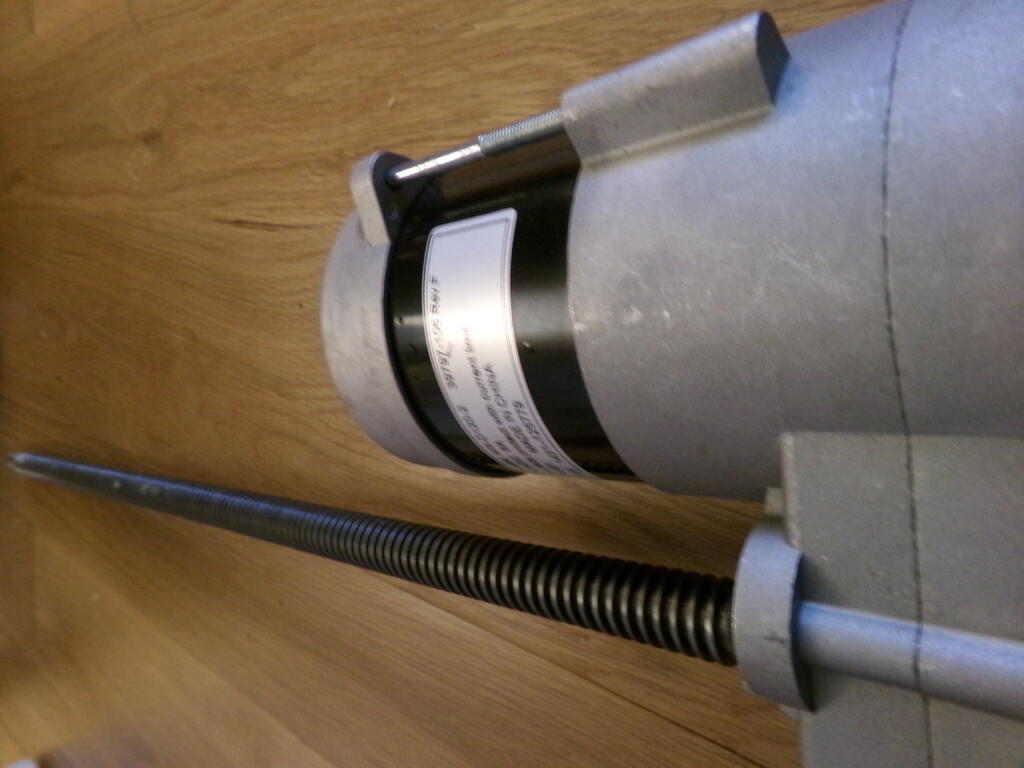

Ed Kennell 47,368 #1 Posted May 28, 2025 (edited) Picked up this new 12V Percore Linear actuator for two bucks at the auction today. It may become a chute control for the Ber Vac dually. I need a 3/4 - 6 RH Acme thread nut to make the missing carriage and yoke. This is the missing nut/yoke. Edited May 28, 2025 by Ed Kennell 1 2 Share this post Link to post Share on other sites

Ed Kennell 47,368 #3 Posted May 28, 2025 9 minutes ago, WHX?? said: Here I was thinking you were looking for funds to go to an auction ... Could be, any interest in digging up a couple lard cans of that moldy cash and investing in the Ed Dog Auction Fund. There I fixed the title for ya. Not my fault Lenovo put the U and I keys too close together. Yeah, Mc Carr has a nut, but I hate to buy a $27 nut for a $2 actuator. Just thinking I have a twisted up C clamp that probably has a 3/4-6 acme thread. 3 1 2 Share this post Link to post Share on other sites
ri702bill 13,068 #4 Posted May 28, 2025 (edited) The one piece round nut collar is under $30... carefull - there are both coarse & fine pitch versions at McMaster. Lucky it is RH thread!! The tap will set you back the better part of two Benjamins....!! Edited May 28, 2025 by ri702bill 1 Share this post Link to post Share on other sites
Ed Kennell 47,368 #5 Posted May 28, 2025 If the C clamp doesn't work, I found square nuts for $5 each. I'm thinking two of them welded together about six inches apart with a flat bar on each side would make a nice swivel yoke. 2 Share this post Link to post Share on other sites
