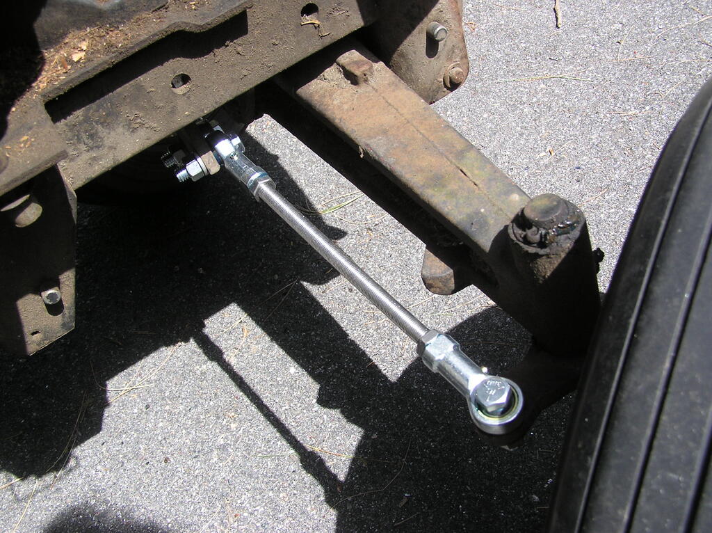

peter lena 9,492 #2 Posted May 28 @rmaynardhttps://www.google.com/search?q=wheel+horse+701+ball+joints&rlz=1C1CHBF_enUS866US866&oq=wheel+horse+701+ball+joints+&gs_lcrp=EgZjaHJvbWUyBggAEEUYOTIHCAEQIRigATIHCAIQIRigATIHCAMQIRigATIHCAQQIRigATIHCAUQIRigATIHCAYQIRirAtIBCTE0NDMxajBqNKgCCLACAfEFlyard6NCxzI&sourceid=chrome&ie=UTF-8 this is easy , personally been using heim joints for years , just about bombproof , pete 1 Share this post Link to post Share on other sites

Wayne0 1,387 #8 Posted May 28 8 hours ago, rmaynard said: Short of replacing, is there a simple way to tightening a ball joint on a 701/702 #3940 steering link? I have gotten rid of most of the slop in my 701 steering, but I am left with loose ball joints. Any ideas would be appreciated. 2 Share this post Link to post Share on other sites
peter lena 9,492 #9 Posted May 29 @ Wayne0 . also like SUPER LUBE on those joints , just a drop , might also check out the rest of any movable points , like the vertical shaft gear base , bushing for sloppy set up . most of my WHEEL HORSE ANYTHING , problems has been FUNCTIONAL DETAILING , like snugging up a sloppy connection point , washers , etc . often refer to , roller stooling around , a problem spot with a helper moving that very area, showing you what it needs . have heims on my clutch rods , solid / smooth . the simplest change / addition , to movable areas has made the BIGGEST DIFFERENCE . plow frame and pto lever set up , are gold mine areas for , improvement . shoulder bolts , washers , elastic lock nuts , let you do a dial in a perfect , movement point , add a spring to a buzzing pto cone , connection clip , silence . experiment , pete Share this post Link to post Share on other sites

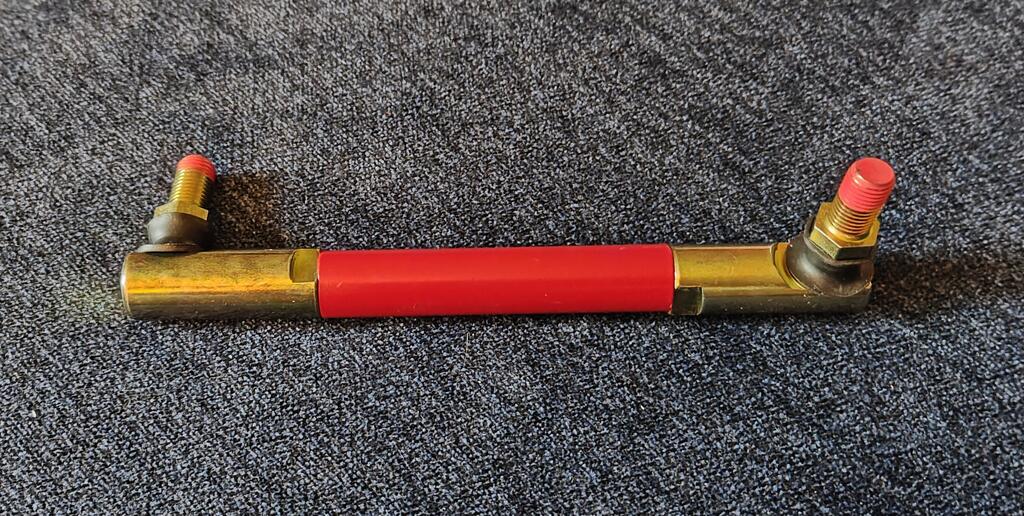

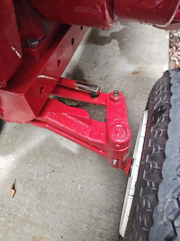

rmaynard 16,638 #10 Posted June 15 Finally decided to make a new one. Problem solved. 2 5 Share this post Link to post Share on other sites
Lee1977 7,418 #11 Posted June 15 (edited) On 5/28/2025 at 7:32 PM, Wayne0 said: It don't get and better then this. I put brass lined heims joints on my C-120 in 1989 they are still tight. I used 1/2" heims joint and bushed them down to 3/8" to fit in the original holes on the triangle and spindle arms. When I got my 520-H in 2019 I used the two from the spindles on my C-120 for the triangle of my 1989 520-H for the triangle on it. I had bought the new 1/2" heims joints with 1/2" stud installed. the spindle arms I drilled out and tapped for the fine tread studs on bothe tractors and also used 1/2" jam nuts on the arms. There is still no loose play in the tierods. Here is the set I put on the 520-H, they may have cost a few dollars more, but they are worth it. Edited June 15 by Lee1977 3 Share this post Link to post Share on other sites

Lee1977 7,418 #13 Posted June 15 If you can use a ball joint , you can used a heims joint. They come in the size you need. You can used what ever you like, just point out a better way. 1 Share this post Link to post Share on other sites
