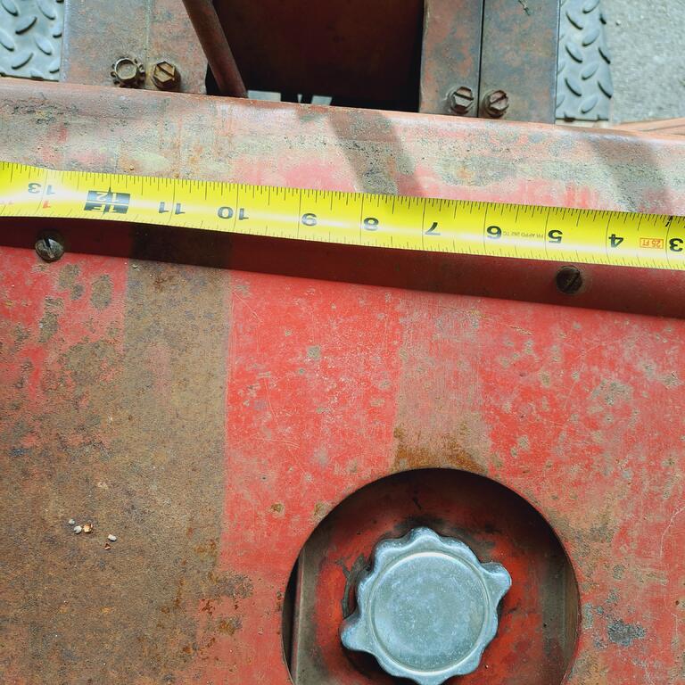

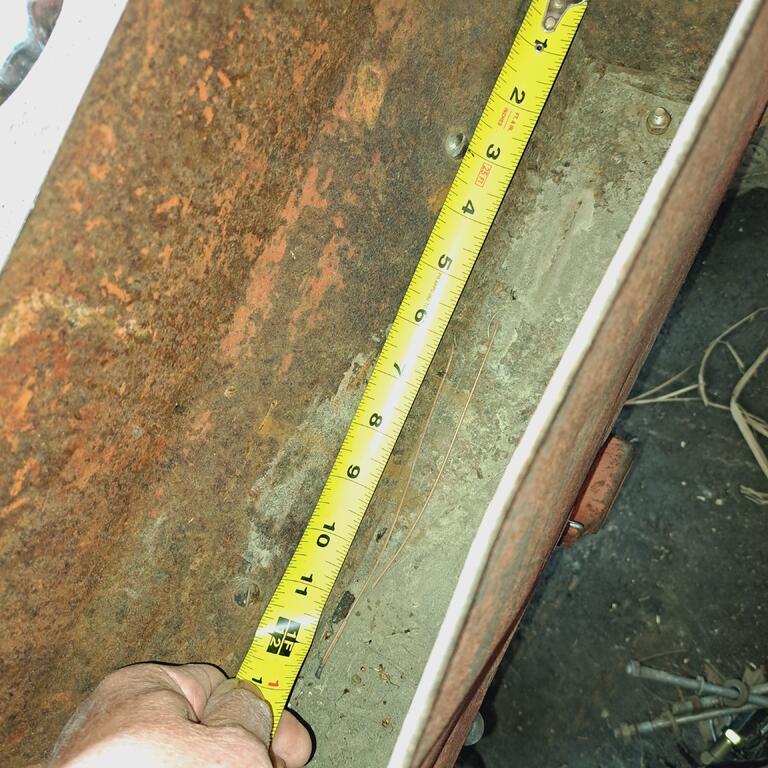

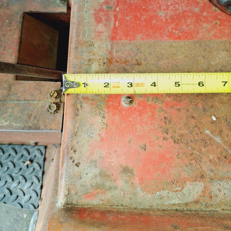

WHX?? 58,145 #8 Posted May 27, 2025 Bottom of the tool box 2 inches up. Front of seat pan pic Share this post Link to post Share on other sites
WHX?? 58,145 #9 Posted May 27, 2025 Drill some holes in the bottom of the tool box for drain holes. Dan coated his with bed liner I think. 2 Share this post Link to post Share on other sites
