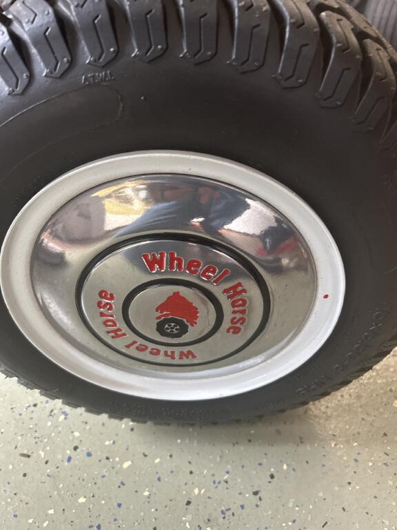

Horse Newbie 7,405 #1 Posted May 26, 2025 Hey guys I have not had my hub caps off my 1994 520H since I powder coated the rims and hub caps. I don’t want to scratch the caps or rims getting them off to grease. Trying to get her ready for The Big Show. Any suggestions or how do youse guys do it ? Share this post Link to post Share on other sites
JCM 11,470 #2 Posted May 26, 2025 (edited) If you have 2 holes in the rim for wheel weights take a wooden dowel from the back side and gently tap one then the other. Place a towel or cardboard on the outside for the hub cab to land on or you can catch the cover with you hand while tapping it. Works for me. You are going to have marks on the rim when the caps come off. Down fall for having hubcaps on nice rims. Edited May 26, 2025 by JCM 4 Share this post Link to post Share on other sites
