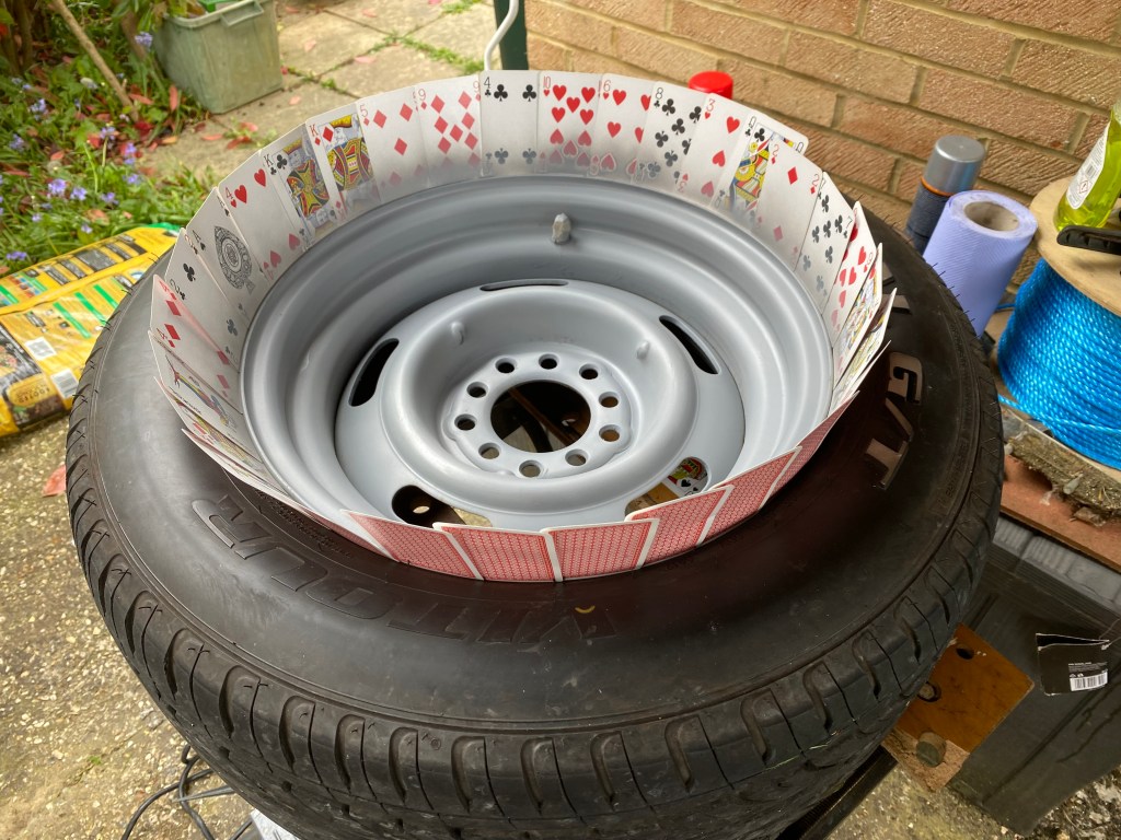

Ed Kennell 47,368 #4 Posted May 26, 2025 I use old playing cards. 4 Share this post Link to post Share on other sites
Achto 32,725 #5 Posted May 26, 2025 (edited) 5 hours ago, Ed Kennell said: I use old playing cards. Playing card trick works pretty good If you are stripping the rims to bare metal prime them with self etching primer before painting, Rustoleum makes a good self etching in a spray can. Edited May 27, 2025 by Achto 2 1 Share this post Link to post Share on other sites

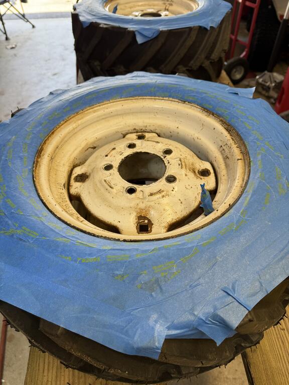

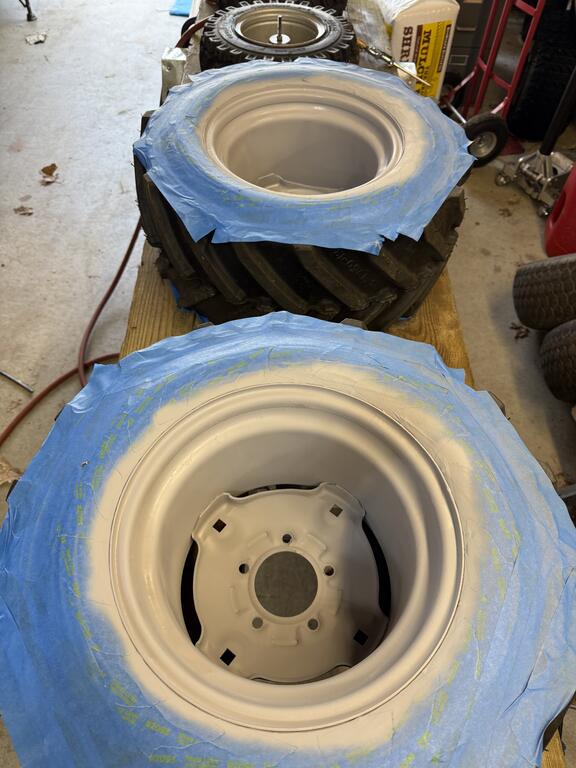

Sparky-(Admin) 26,371 #6 Posted May 26, 2025 I prefer taping them off, taping both sides so I can prime both sides at once..and then finish paint both sides at once. 7 Share this post Link to post Share on other sites

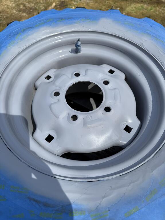

CS-17 14 #12 Posted May 27, 2025 Thanks for all the great tips!!! The dark green self etching primer looks to be less than half the price of the gray one, is there anything wrong with using dark green, instead of gray, as the primer? 1 Share this post Link to post Share on other sites
MainelyWheelhorse 3,133 #13 Posted May 28, 2025 I scuffed up the rims with a palm sander with 320, and I do a mix. I started off with these taping around the edge. I ended up after the tape wouldn’t stick, gingerly spraying around the rim with one of those plastic slip on pistol grip for a spray can of silver wheel paint and some gloss silver. It came out good. They are for a worker so I’m not looking for perfection. 2 Share this post Link to post Share on other sites

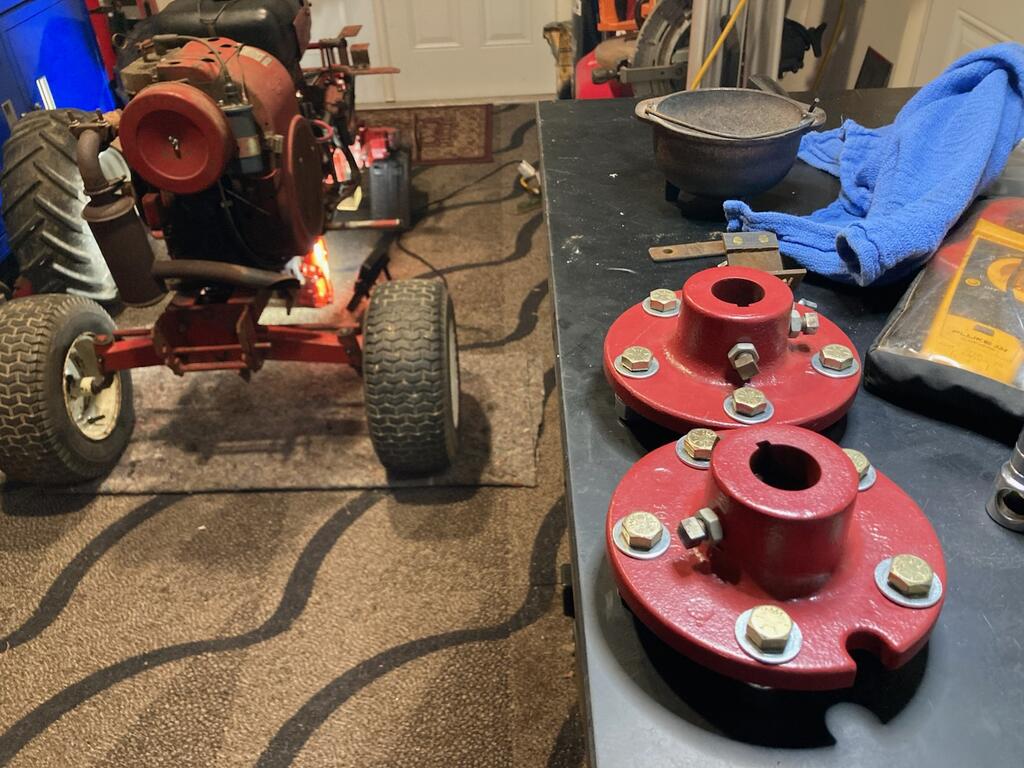

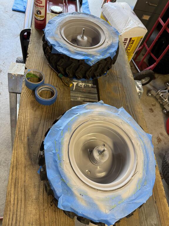

ineedanother 2,866 #14 Posted May 28, 2025 Do yourself a favor now and spend a few bucks to install wheel studs. 7/16" x 20 (can't recall the length right now) and pick up some lug nuts: https://www.amazon.com/dp/B00J5U7EBO?ref=ppx_yo2ov_dt_b_fed_asin_title&th=1 Changing tires is so much easier this way 3 1 Share this post Link to post Share on other sites
rjg854 13,360 #15 Posted May 28, 2025 I've changed all my tractors over to studs, I use 1 1/2 " studs and capped lug nuts. 3 Share this post Link to post Share on other sites
kpinnc 18,968 #16 Posted May 29, 2025 On 5/27/2025 at 9:36 AM, CS-17 said: The dark green self etching primer looks to be less than half the price of the gray one, is there anything wrong with using dark green, instead of gray, as the primer? Nope. I kinda like it myself. 3 1 Share this post Link to post Share on other sites

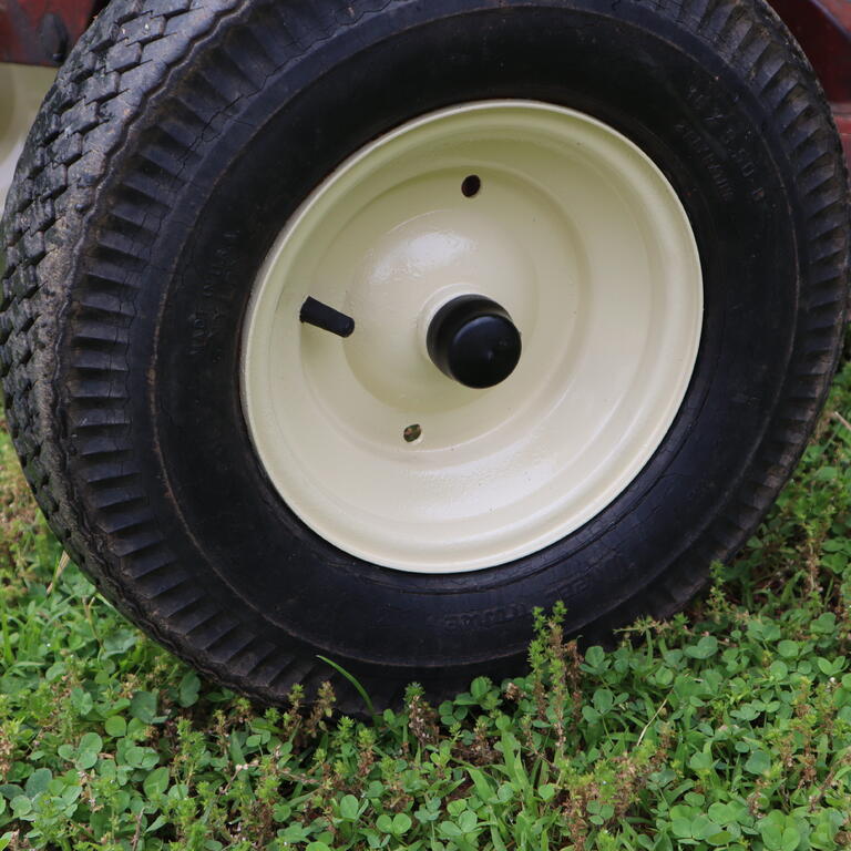

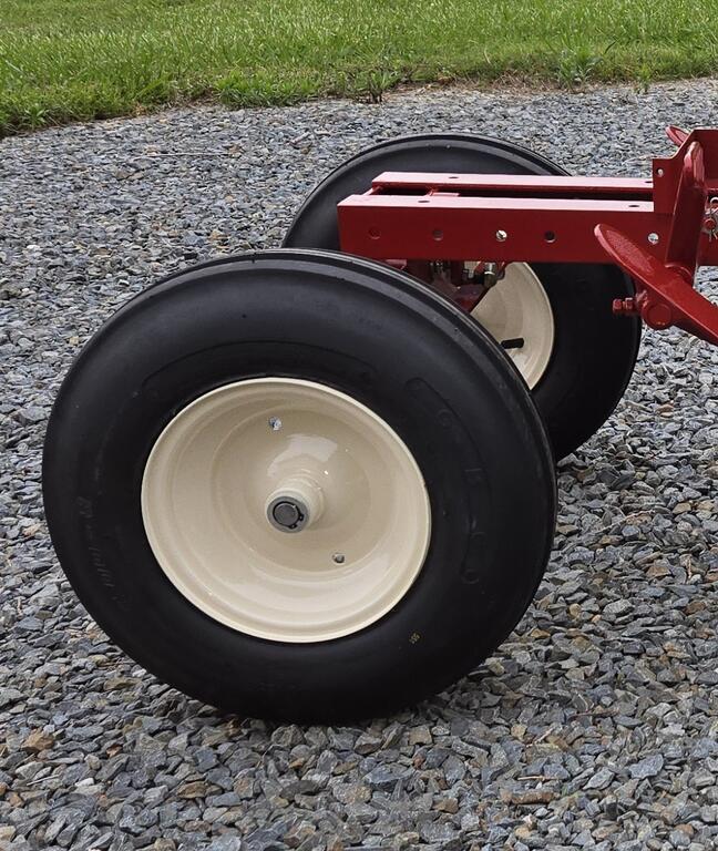

CS-17 14 #17 Posted May 29, 2025 Finished!!! I used a drill mounted wire brush to clean rust and old paint off. Then used the dark green self etching primer, And finished with a nice almond colored spray paint!! Also to keep the tires taped off, I used duck tape (since I don't have any spare playing cards). Next, looking to make a hood ornament...... 2 1 Share this post Link to post Share on other sites
JR Pedersen 18 #18 Posted May 30, 2025 6 hours ago, CS-17 said: Finished!!! I used a drill mounted wire brush to clean rust and old paint off. Then used the dark green self etching primer, And finished with a nice almond colored spray paint!! Also to keep the tires taped off, I used duck tape (since I don't have any spare playing cards). Next, looking to make a hood ornament...... Well done sir...well done 1 Share this post Link to post Share on other sites
