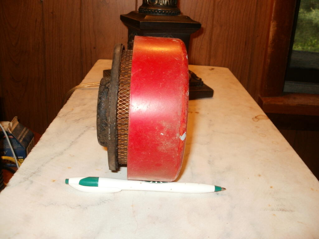

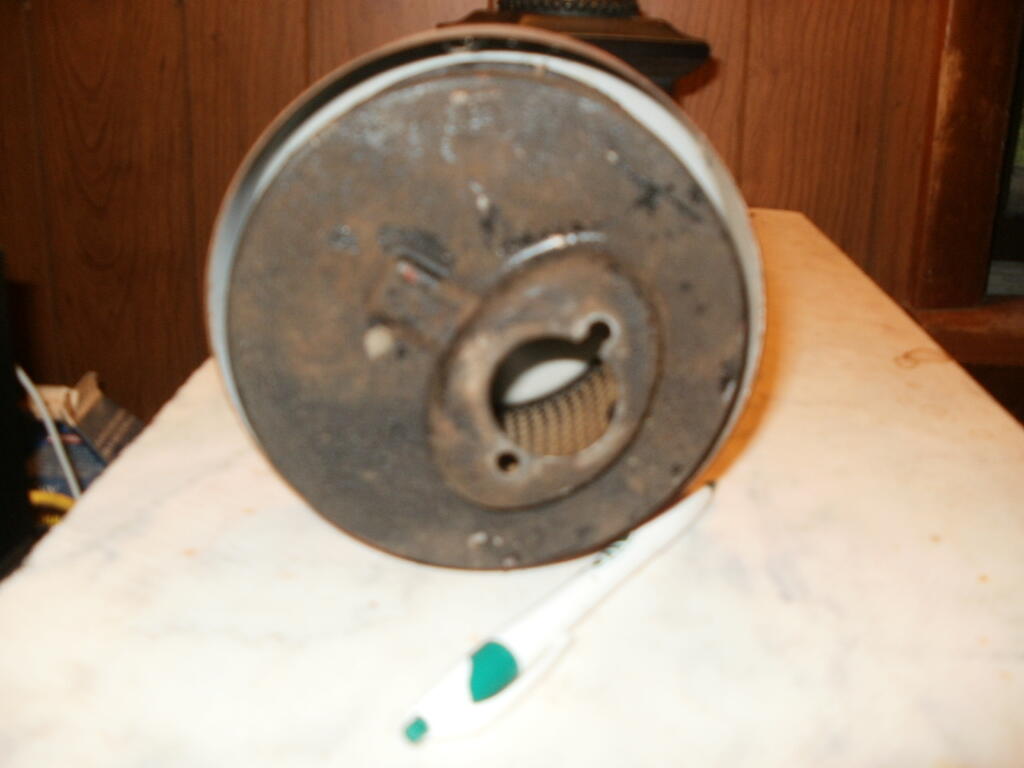

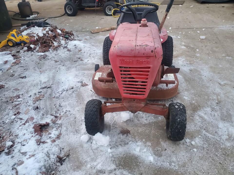

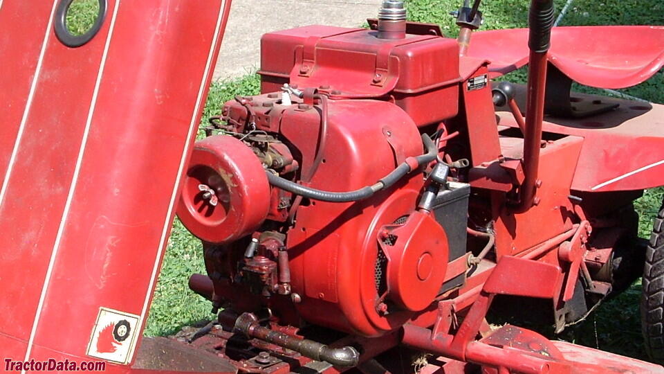

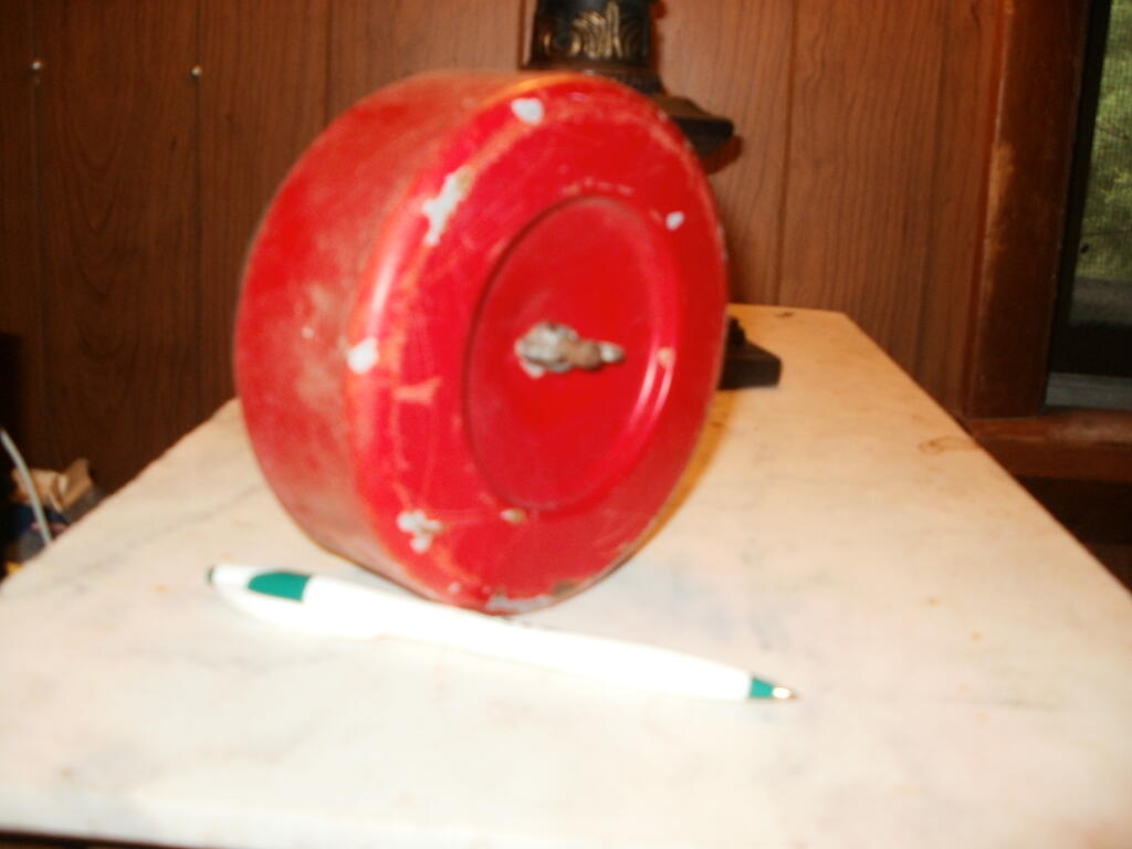

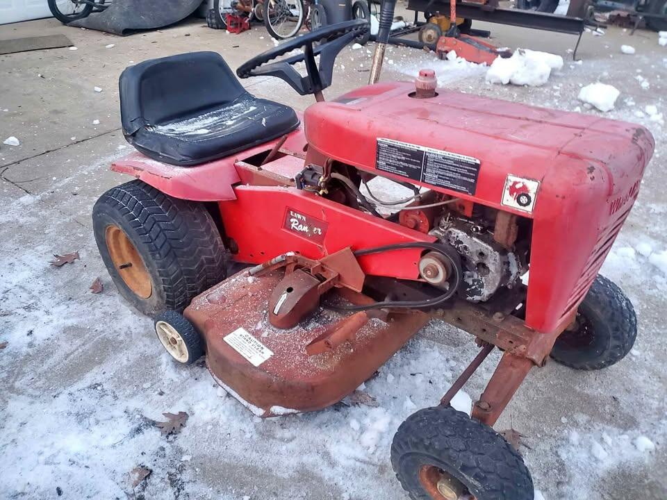

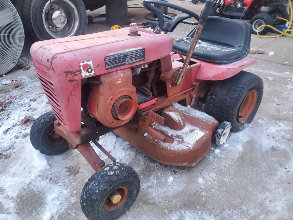

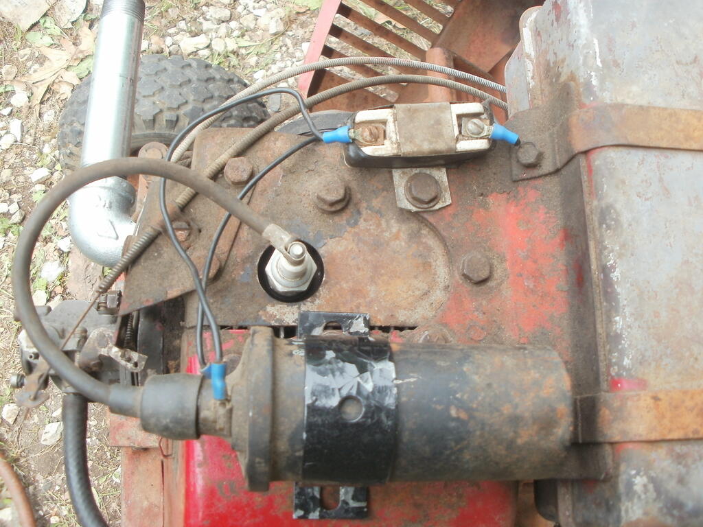

UNBOUND 73 #1 Posted May 25, 2025 Just got this one. 1965 L-155. Needs some tlc, I cleaned the carb and got it running. It has an external coil conversion, which I like, makes replacement a lot easier. The 4th photo is not mine, is just for reference as I am looking for the air filter that fits in that housing. The parts manual doesnt show an air cleaner, at least the manual I downloaded doesnt. 5 3 Share this post Link to post Share on other sites

UNBOUND 73 #4 Posted May 25, 2025 I need 4 3/8 od x 3 id x 1 3/4 thick.The filter in it is 2 1/4 thick and as you can see it is about 1/2 too thick.This is on a tec h60. Share this post Link to post Share on other sites
UNBOUND 73 #5 Posted May 25, 2025 Its a kohler #230840s. Share this post Link to post Share on other sites
squonk 45,452 #6 Posted May 25, 2025 13 minutes ago, UNBOUND said: I need 4 3/8 od x 3 id x 1 3/4 thick.The filter in it is 2 1/4 thick and as you can see it is about 1/2 too thick.This is on a tec h60. You need a Sierra/ Primeline 7-02202 Share this post Link to post Share on other sites
953 nut 64,054 #7 Posted May 25, 2025 The Kohler 230840S should be 1 1/2", same as the one from NAPA that @squonk listed. Share this post Link to post Share on other sites
UNBOUND 73 #8 Posted May 25, 2025 I am looking on Amazon now. The Wix is $12 I may check my local Napa tomorrow. Share this post Link to post Share on other sites

WHX?? 54,840 #12 Posted May 26, 2025 (edited) Nice LR looks to be original and unmolested. Edited May 26, 2025 by WHX?? Share this post Link to post Share on other sites
UNBOUND 73 #13 Posted May 26, 2025 Other than the seat, steering wheel, gas cap and external coil, the rest looks original. Thanks for all the welcomes. I am a member of other forums but this one seems to be more active. Share this post Link to post Share on other sites
