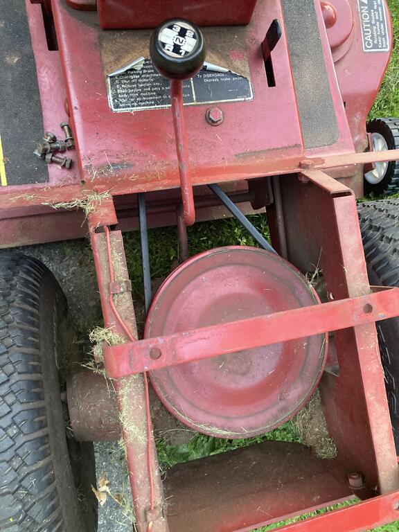

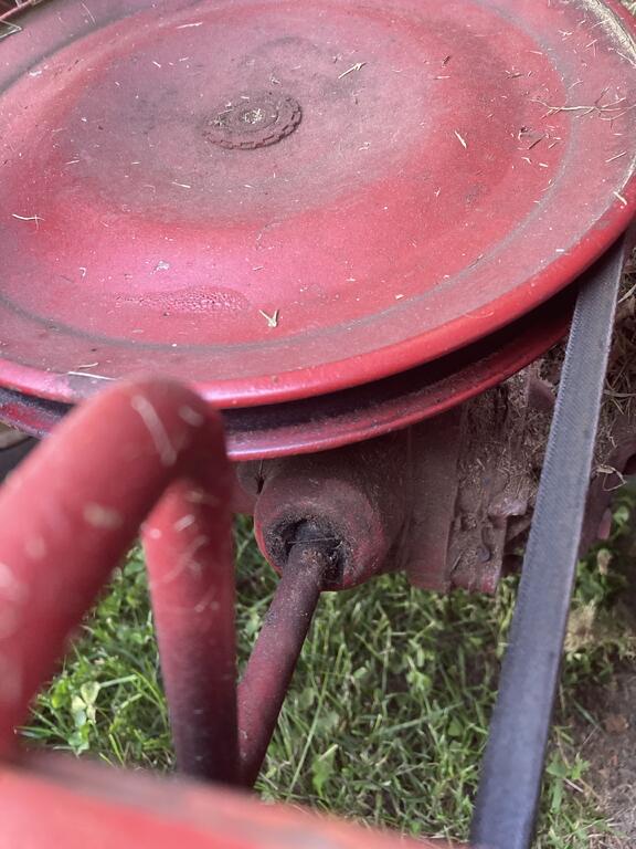

TonyToro 1,199 #15 Posted June 4, 2025 I had a few spare minutes tonight. Took the seat and seat pan off. Looks like someone was already in the transmission. There is blue gasket sealant around the shifter and gear case. The three bolts appear to have been thread from the inside? I can see threads around the shifter cover?? IMG_1308.mov 1 Share this post Link to post Share on other sites

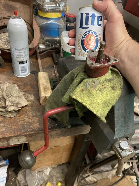

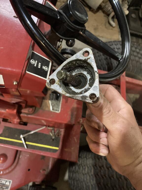

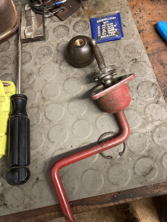

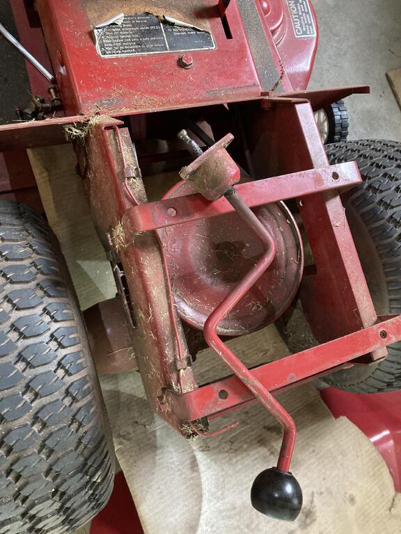

TonyToro 1,199 #16 Posted June 7, 2025 While Anthony and his friend were working on the new pulling tractor I took the shifter apart. Turned out the bolts were 1/4”. They came out easily and then I scrapped all the permatex off… lol i have to order a few little parts and should be good. 1 1 Share this post Link to post Share on other sites

TonyToro 1,199 #20 Posted June 21, 2025 Success! The A-100 is good and tight now. It was super hot and I was thirsty while working on this… lol Installed a few NOS parts and used Lucas Grease. It’s tight and smooth now. Thank you everyone for all the help along the way. IMG_1439.mov 2 Share this post Link to post Share on other sites
