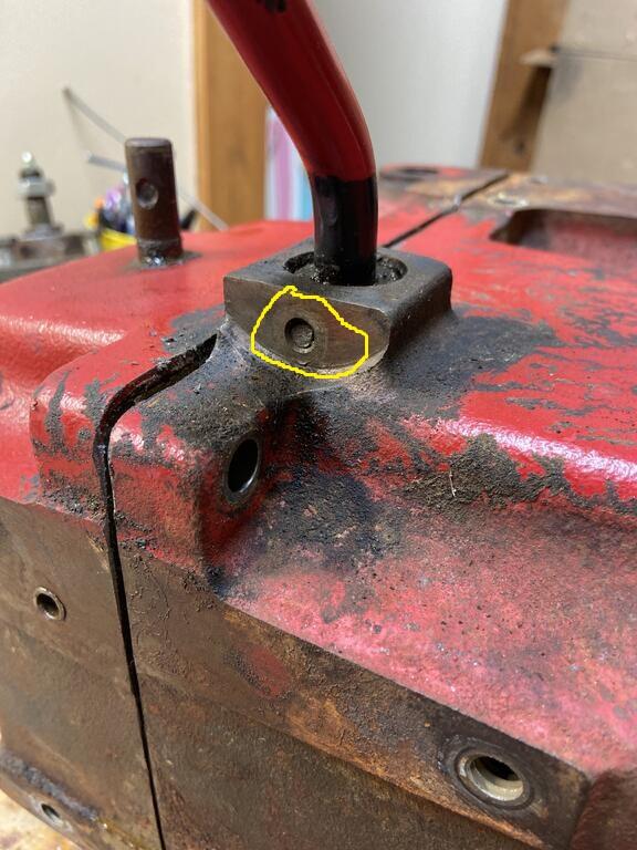

squonk 48,127 #6 Posted May 23, 2025 23 minutes ago, Beerad said: thx you guys for the advice. I checked the hi/ lo shifter and it seems to be properly engaged, and the gear shift definitely feels like its in gear. Also just to fill out he picture I can move the transmission pulley with my hand when the gears are engaged. regarding the set screw for the main gear shift and the roll pin for hi/ lo shift, I guess how do I get to them do I have to open the transmission? Set screw for the shifter is here. It's broken off in this picture: I'm betting that hi lo fork is bent /broken and the hi lo gear isn't engaged with anything. With the main shifter in any gear and the hi lo lever all the way one direction or the other it will feel like it's engaged but it's not and that would cause your exact issue. Share this post Link to post Share on other sites
Ed Kennell 47,372 #7 Posted May 23, 2025 1 hour ago, Beerad said: the roll pin for hi/ lo shift The hi/lo shifter shaft is shown here in Mikes picture. The lever has been removed and only the shaft with the roll pin hole remains. I had one of these hi/lo shafts drop down a small amount and it would not shift. I actually put a thin washer under the lever collar to hold it up a bit and it shifted OK. Share this post Link to post Share on other sites
