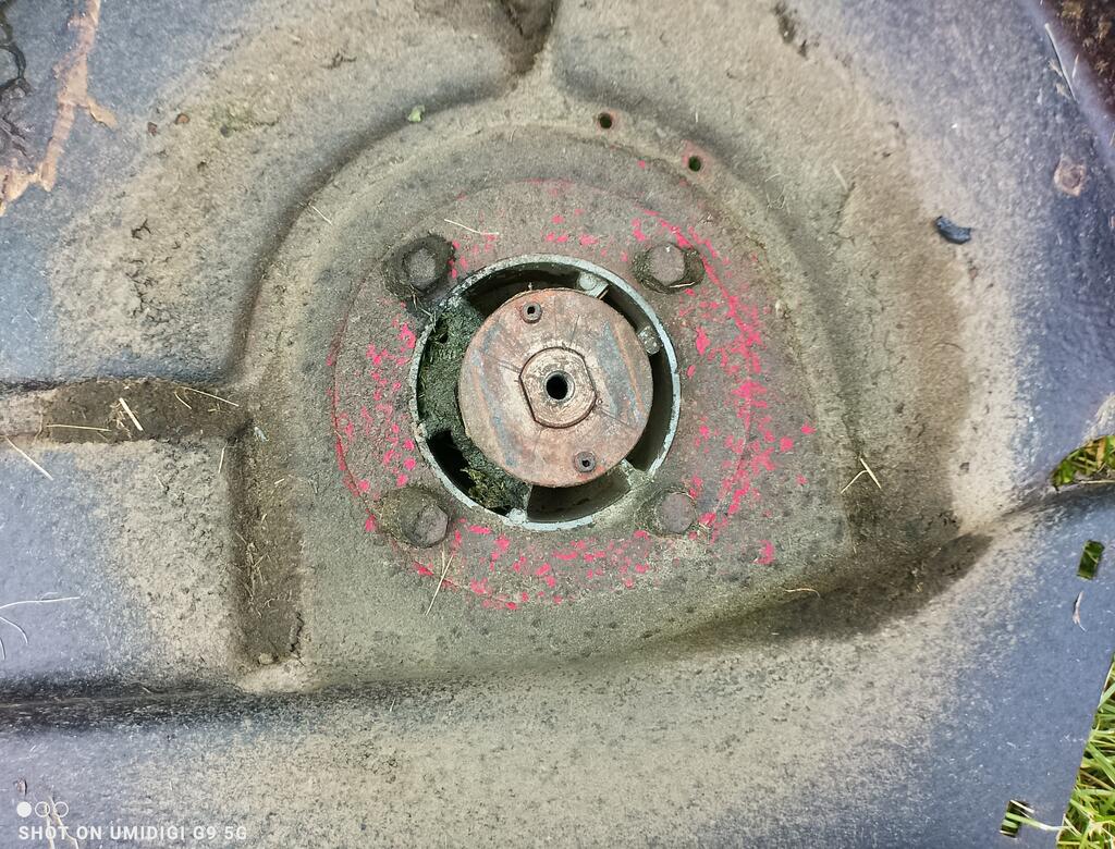

Rhondajoy79 0 #1 Posted May 22, 2025 Hello Everyone, I hope someone can help me. My Dad(72) bought a 82 B-115 with a hydrostatic. He got it running as all the wiring was gone. I have managed to find all the parts he has needed so far. Not very easy. I am at a brick wall with the blades for the mower. I don't know what I am doing wrong but I cannot find them. When I look up the deck numbers for blades they are all round hole and the deck has d-holes I think this is what they are called. If anyone could help that would be amazing. I know its probably been asked before a lot and I appreciate any info I can get. He loves this tractor. The deck Numbers are 05-37MS01-40096 Model # for the Tractor 02-11BE01 I will attach pics of the deck. Thank you so much! Share this post Link to post Share on other sites
nylyon-(Admin) 9,066 #2 Posted May 22, 2025 I believe that you need blade kit 108004 which is getting harder to find. There are a couple on eBay now but are pricy. This thread has more detail: 1 1 Share this post Link to post Share on other sites

gwest_ca-(File Mod) 12,508 #4 Posted May 22, 2025 The 108004 blade set replaced 2 individual 108171 blades. Another number you can search for. 1 Share this post Link to post Share on other sites
Horsin'round 497 #5 Posted May 22, 2025 Might try Lincoln at AZ- tractor. I was able to pick up a set of double-Ds from him for my 48" deck. 1 1 Share this post Link to post Share on other sites
JimSraj 585 #6 Posted May 23, 2025 1 hour ago, Horsin'round said: Might try Lincoln at AZ- tractor. I was able to pick up a set of double-Ds from him for my 48" deck. Also got a set of double D 48” from Lincoln at A-Z. 1 Share this post Link to post Share on other sites
