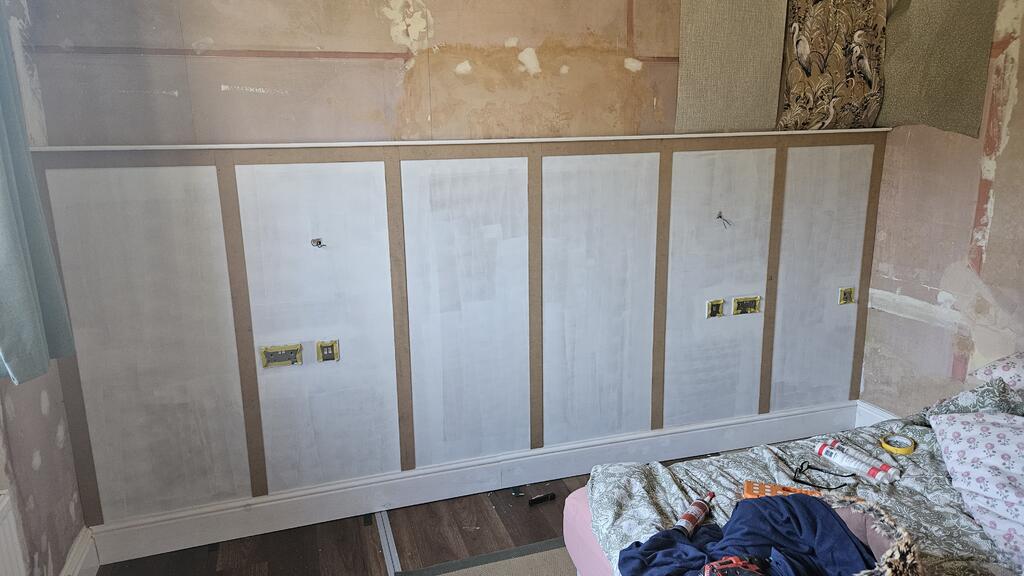

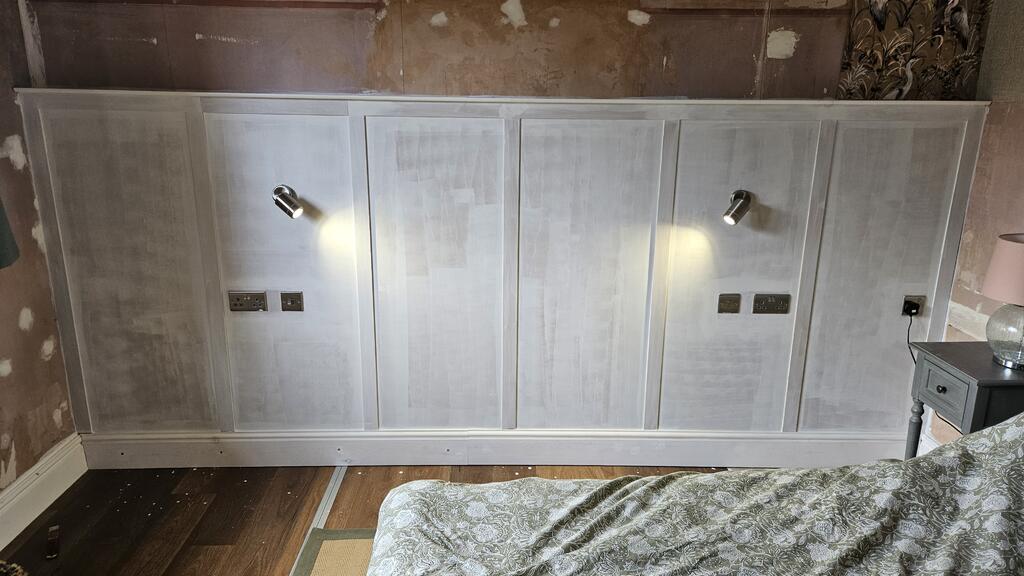

I did some work building a false wall style paneled feature wall in our bedroom.
There was a lighting circuit which was fed from a downstairs fuse box and had provided a light for a now removed staircase.
I thought it would be useful to use that feed to power a standard lamp so that we had a bedside switch for it.
Wired everything up with no problem.

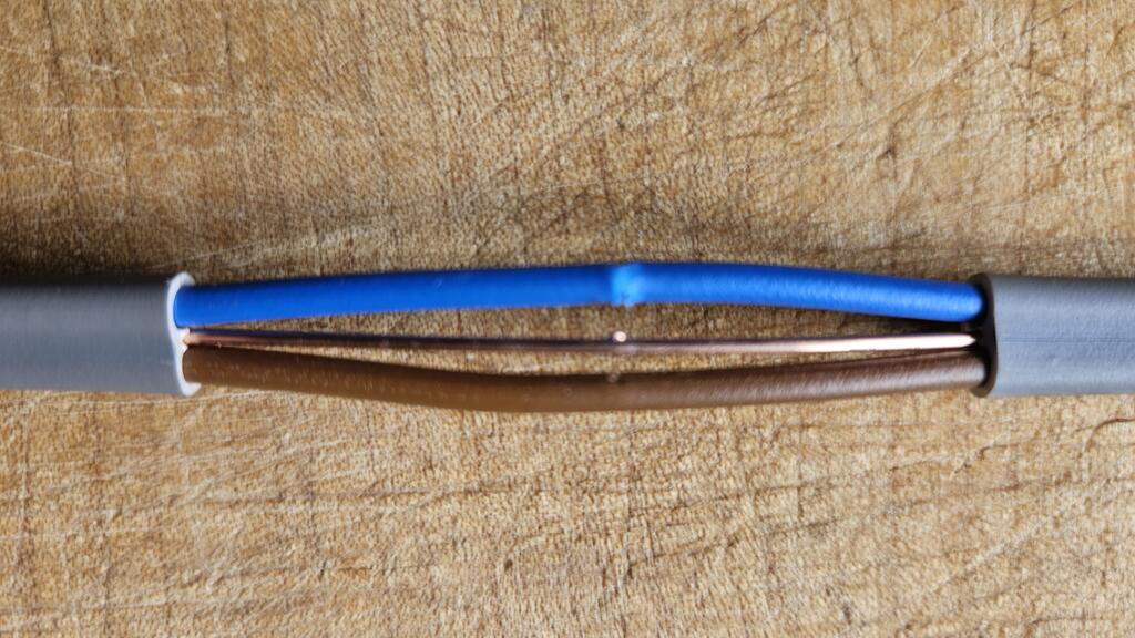

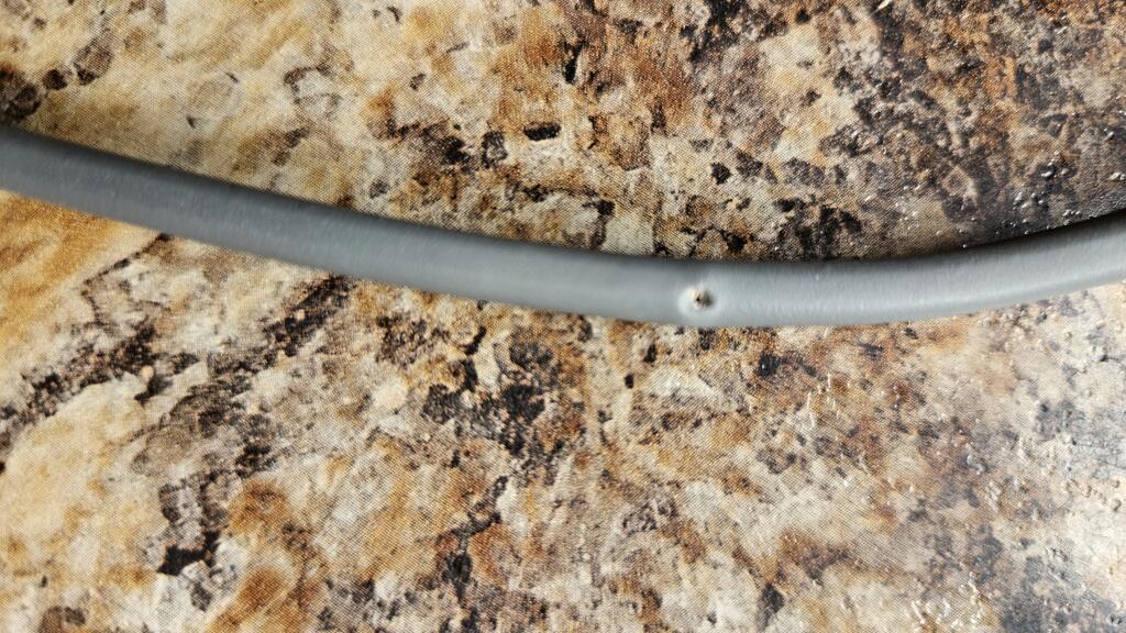

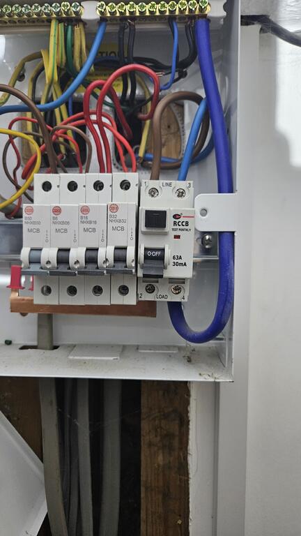

Fitted the boards to the framing, not knowing I had trapped a twin and earth cable between them.
I found out when the downstairs fuse board tripped out and would not reset.
The RCCB would not reset until I removed a lighting neutral from the bus bar. So it was a neutral to earth fault, I had clearly pierced a cable building the wall. But where?
Took a while to find but the trapped cable was the culprit, and a 1mm air nail I had scored a bullseye with on it.
Thankfully not too great a chore to free the trapped wire and cut out the damaged section.
Just tells you to check and check again with any wiring installation.
This is the completed wall ready for finish painting. Bed will sit between the reading spot lights. Sockets are higher than usual to allow bed side units.
