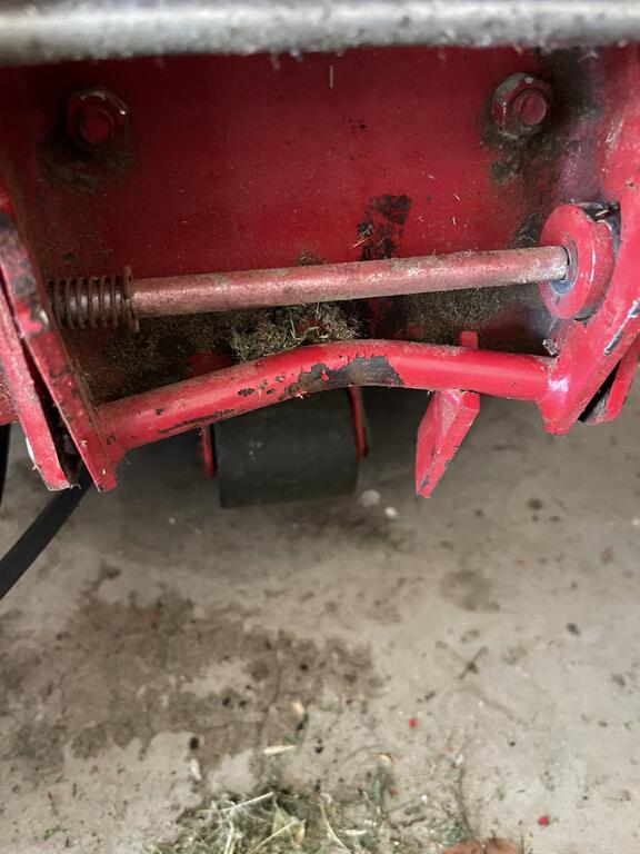

stvski80085 279 #1 Posted May 15, 2025 Had an accident and the tractor wasn’t even running. It literally rolled into a tree and ruined the mower deck belt tensioner. It’s bent bad. I’m hoping I can find another one. Not sure bending it back will fix it. Gonna look closer this weekend. The brake is not holding as well as I thought. One tree in the yard and it found it. steve 3 Share this post Link to post Share on other sites

stvski80085 279 #3 Posted May 15, 2025 I will get a pick in the next day or two. I need to see if any parts can be a saved. It was so bashed up it will take some work to get it off the front of the tractor. I think the slide release may be broke too. 1 Share this post Link to post Share on other sites
peter lena 10,013 #4 Posted May 15, 2025 @stvski80085 , use the opportunity to enhance / TOTAL FUNCTION , typical decks I see are like a sled drag , for resistance , and quiet rotation , picture of your issue would help , pete Share this post Link to post Share on other sites
stvski80085 279 #5 Posted May 16, 2025 So I haven't looked up part numbers yet. This is the main damage so far. I can fix the other I think. Steve 1 Share this post Link to post Share on other sites

8ntruck 9,215 #7 Posted May 17, 2025 The front tach-a-matic brackets are fairly common. Check with some of our vendors in the vendor section - Wheelhorse Parts and More, A-Z Tractors, K&B Horse Parts to name a few. Then there is always a new piece of 5/8 cold rolled, an angle grinder, a BFH, a welder, and some time. It is bent, but if one were really determined, it could be fixed. Replacement would be far easier, though. Share this post Link to post Share on other sites
stvski80085 279 #8 Posted May 17, 2025 I ordered one off eBay last night. Might try repairing this one at some point. Never hurts to have extra’s. 😀 steve Share this post Link to post Share on other sites
