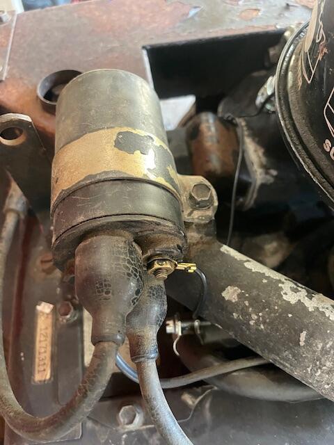

AHS 1,552 #1 Posted May 14 i just put in new points, but i forgot to tighten down the coil clamp. While it was running (w/out the bolt to tighten down the coil) the coil vibrated loose and the condenser wire got grounded. It shut off. It will run. I will crank it over, and it will only fire up after i put it to the Run position. I got a video of it, I don’t know if it will let me put it up here. Here the picture of the coil (W/ the bolt in!) oops! @ebinmaine has seen the video. Anyway! New condenser? I should probably check make sure my points are at .020”. I measured the points two weeks ago and they were. Share this post Link to post Share on other sites

AHS 1,552 #16 Posted May 16 13 hours ago, 953 nut said: But you sid it worked properly before the coil falling off. What number ignition switch did you use? Not all ignition switches are the same. 103990. The wiring was all correct. I replaced coil and condenser, no spark. So i dug into the points… the points were shut. Ah huh!! So, i got em set to .020”…(without the points cover on i started it) it started beautiful! I shut it off, put the points cover back on and no spark?! What is going on here? Share this post Link to post Share on other sites
953 nut 60,541 #17 Posted May 16 11 hours ago, AHS said: (without the points cover on i started it) it started beautiful! I shut it off, put the points cover back on and no spark?! Sounds like the wire from the points to the coil has a problem, replace it and the problem will probably go away. 2 Share this post Link to post Share on other sites
Handy Don 14,203 #18 Posted May 16 5 hours ago, 953 nut said: Sounds like the wire from the points to the coil has a problem, replace it and the problem will probably go away. Yep, getting shorted somewhere. 1 Share this post Link to post Share on other sites
