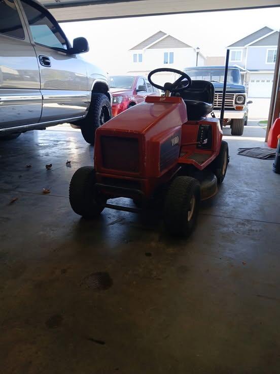

Sublauxation 17 #1 Posted May 12, 2025 My kid and a buddy found this sitting out on a city junk day. They towed it home (slowly) and I'm wondering if that's part of the problem? I only see Toro stickers but he said it also has Wheel Horse markings. 3 years ago I never heard of them, now this would be our 3rd so these things are addicting. I like the older ones but this looks pretty cool. I can't find much info on them, seems most of the 8-32s are rear engine? They got it running pretty quickly and it now runs great. Initially it wouldn't move but he cleaned up the clutches and now it moves in 1st but doesn't have enough power to go uphill. I haven't seen it in person yet and don't know much about them but he also said something about a belt that could be the problem? Any insight on where to start problem solving and any link to getting parts for this, I've come up pretty empty handed Share this post Link to post Share on other sites

WHX?? 57,643 #4 Posted May 12, 2025 2 hours ago, Sublauxation said: doesn't have enough power to go uphill. Should be easy enough to sort out. Share this post Link to post Share on other sites
Sublauxation 17 #5 Posted May 12, 2025 Here is the tractor, thanks for getting me in the right direction: 17 minutes ago, WHX?? said: Share this post Link to post Share on other sites
Sublauxation 17 #6 Posted May 12, 2025 17 minutes ago, WHX?? said: Should be easy enough to sort out. He's a bunch of hours away and I don't know much about these, do you have any ideas on where to start aside from cleaning up the clutches? I haven't looked around with the new model number but any idea on parts availablity? Share this post Link to post Share on other sites

WHX?? 57,643 #9 Posted May 12, 2025 4 hours ago, Sublauxation said: ideas on where to start aside from cleaning up the clutches? Being a gear jammer start in the clutching/belt area providing it goes into all gears. 1 Share this post Link to post Share on other sites

Sublauxation 17 #11 Posted May 16, 2025 On 5/12/2025 at 5:46 PM, WHX?? said: Being a gear jammer start in the clutching/belt area providing it goes into all gears. Any idea where to find parts for these? Just talked with my kid, he says it goes into all gears but he thinks the spring may be weak as the clutch doesn't look overly worn but it just slips. Share this post Link to post Share on other sites
