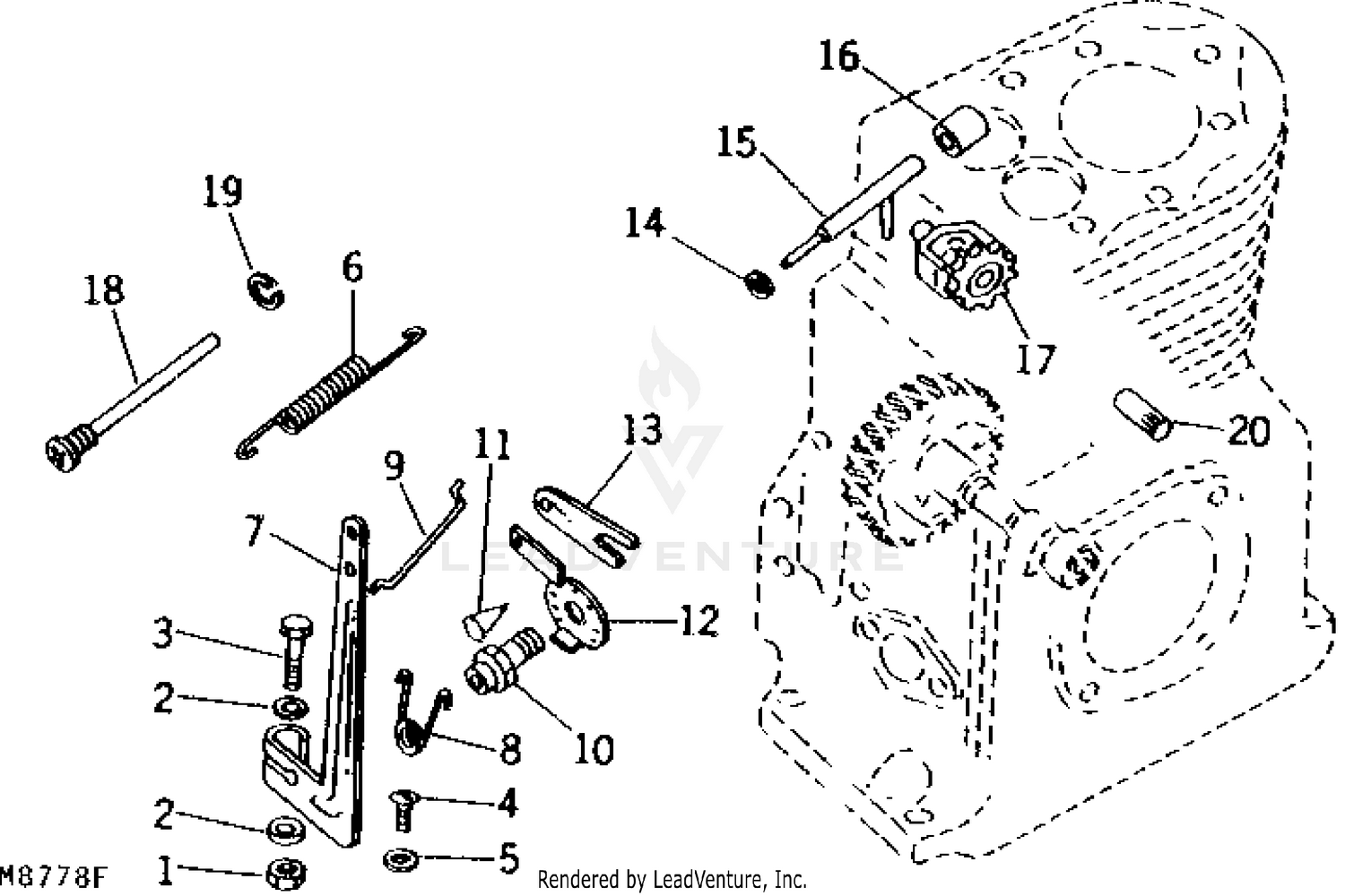

Achto 32,816 #28 Posted May 13, 2025 (edited) 9 hours ago, 1968Commando said: No no the shaft it only slightly turns not even a quarter turn maybe tenth of a revolution That is exactly correct and how it should be. Here is what goes on inside your engine. The pics below show the governor that is inside your engine. The cam shaft gear makes this part spin, high speed forces the 2 L shaped fly weights out word, this forces the pin in the middle to push out. Not a whole lot of movement. If the engine is not running, this part does nothing. Picture A shows the fly weights in position as though the engine was running and forcing the weights out. A Picture B shows the weights retracted as if the engine is not running or the throttle spring tension on the governor shaft is holding the pin in the center down. B In the diagram below the above pictured governor is part #17. The pin in the middle of the governor #17 pushes against the flag on the governor shaft #15 inside the engine. This motion rotates the governor arm clock wise to push the throttle close to slow down the engine. When you pull the throttle open and rotate the throttle wheel #12 this applies more spring pressure on the end of the governor pin on part #17. More pressure makes it so that #17 will have to spin faster in order for the fly weights to move out and slow the engine down. This balancing act between the spring on the throttle wheel and the fly weights on the governor is what determines your engine speed. Put every thing back together as I explained in my earlier post or better yet follow the instructions in manual that @WHX?? posted a link to. When it is together take a video showing what happens when you move the throttle in and out using the throttle cable as normal please. Edited May 13, 2025 by Achto 1 2 Share this post Link to post Share on other sites
1968Commando 189 #29 Posted May 13, 2025 (edited) 26 minutes ago, Achto said: That is exactly correct and how it should be. Here is what goes on inside your engine. The pics below show the governor that is inside your engine. The cam shaft gear makes this part spin, high speed forces the 2 L shaped fly weights out word, this forces the pin in the middle to push out. Not a whole lot of movement. If the engine is not running, this part does nothing. Picture A shows the fly weights in position as though the engine was running and forcing the weights out. A Picture B shows the weights retracted as if the engine is not running or the throttle spring tension on the governor shaft is holding the pin in the center down. B In the diagram below the above pictured governor is part #17. The pin in the middle of the governor #17 pushes against the flag on the governor shaft #15 inside the engine. This motion rotates the governor arm clock wise to push the throttle close to slow down the engine. When you pull the throttle open and rotate the throttle wheel #12 this applies more spring pressure on the end of the governor pin on part #17. More pressure makes it so that #17 will have to spin faster in order for the fly weights to move out and slow the engine down. This balancing act between the spring on the throttle wheel and the fly weights on the governor is what determines your engine speed. Put every thing back together as I explained in my earlier post or better yet follow the instructions in manual that @WHX?? posted a link to. When it is together take a video showing what happens when you move the throttle in and out using the throttle cable as normal please. Ok thank you, so it turns out my governor isn’t broken then I guess. I will get that done tonight and send a video Edited May 13, 2025 by 1968Commando 1 Share this post Link to post Share on other sites

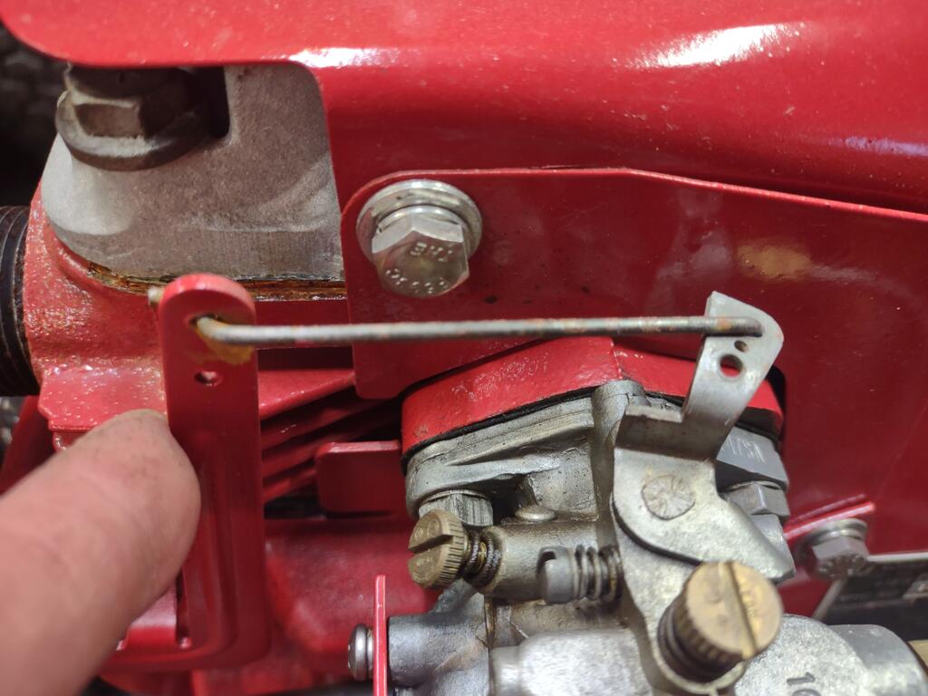

1968Commando 189 #35 Posted May 14, 2025 2 minutes ago, Achto said: A little rotation on the shaft is a lot of rotation at the governor arm. Your want your shaft to be at full counter clock wise rotation with the throttle wide open. Set the governor arm as posted. After it is tight move it clock wise & the carb butter fly should be close against the idle screw. This all the movement you need, the rotation does not increase with the engine running. Ok the arm looks like this now Share this post Link to post Share on other sites
1968Commando 189 #36 Posted May 14, 2025 Just now, 1968Commando said: Ok the arm looks like this now Now the arm moves 10 degrees or so Share this post Link to post Share on other sites
Achto 32,816 #37 Posted May 14, 2025 76878633965__10CA8430-DCF9-401D-9AAD-C268B0EEA49B.MOV In this video that you posted earlier you had more that enough movement. Share this post Link to post Share on other sites

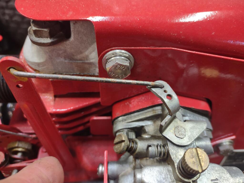

Achto 32,816 #38 Posted May 14, 2025 (edited) Throttle wide open. Throttle closed at idle. The very top of the governor arm only moves about 3/4" to make this happen. Edited May 14, 2025 by Achto Share this post Link to post Share on other sites
1968Commando 189 #39 Posted May 14, 2025 (edited) 27 minutes ago, Achto said: Throttle wide open. Throttle closed at idle. The very top of the governor arm only moves about 3/4" to make this happen. Here is what I am having Edited May 14, 2025 by 1968Commando Share this post Link to post Share on other sites
1968Commando 189 #40 Posted May 14, 2025 30 minutes ago, Achto said: Throttle wide open. Throttle closed at idle. The very top of the governor arm only moves about 3/4" to make this happen. Mine now goes to fill throttle but not all the way to idle Share this post Link to post Share on other sites
Achto 32,816 #41 Posted May 14, 2025 3 minutes ago, 1968Commando said: Mine now goes to fill throttle but not all the way to idle Recheck check your governor arm & shaft adjustment. The shaft has to be full counter clock wise when the throttle is wide open. Share this post Link to post Share on other sites
1968Commando 189 #42 Posted May 14, 2025 (edited) 2 minutes ago, Achto said: Recheck check your governor arm & shaft adjustment. The shaft has to be full counter clock wise when the throttle is wide open. Man this thing is a dang pain I’ve readjusted it 3 times and every time I get just a little bit closer Edited May 14, 2025 by 1968Commando Share this post Link to post Share on other sites
1968Commando 189 #43 Posted May 14, 2025 (edited) 4 minutes ago, Achto said: Recheck check your governor arm & shaft adjustment. The shaft has to be full counter clock wise when the throttle is wide open. The governor arm is supposed to spring away from the carb when I push it towards the carb correct? Edited May 14, 2025 by 1968Commando Share this post Link to post Share on other sites
