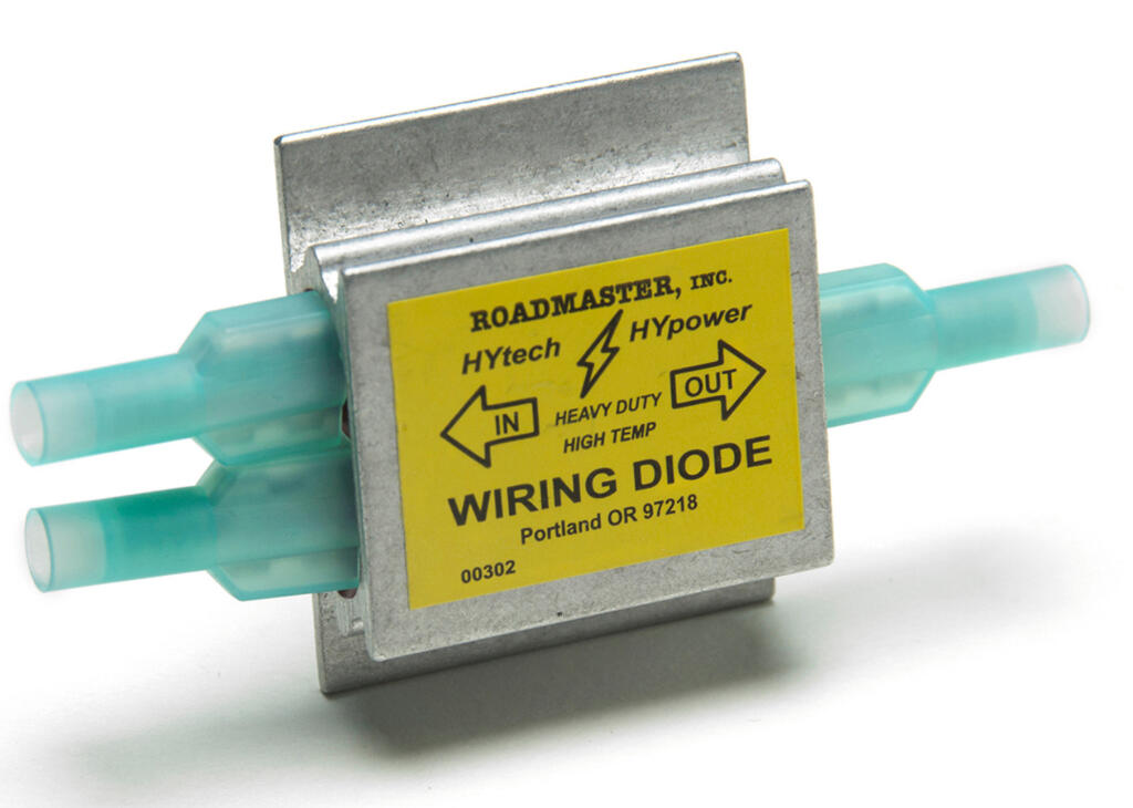

nylyon-(Admin) 9,039 #1 Posted May 11, 2025 On the 310-8, the lights are powered by a separate lighting coil on the engine, probably why this model does not have tail lights. Has anyone added a diode so the lights can be powered by the battery and the lighting circuit? 3 Share this post Link to post Share on other sites
