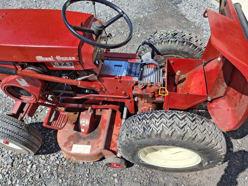

mike avad 61 #1 Posted May 10, 2025 I have a wheel horse 875 I need to move it and am not able to get it running to move it could someone tell me how to free the trans so am able to move this by hand to push it I know there 2 bolts that need to be lose and the trans is a Hydro Share this post Link to post Share on other sites
953 nut 68,495 #2 Posted May 10, 2025 Here is the manual for your transaxle Share this post Link to post Share on other sites
squonk 47,887 #3 Posted May 10, 2025 All you need is a 1/2" wrench. Turn this bolt about a 1/4 turn 1 2 1 Share this post Link to post Share on other sites
mike avad 61 #4 Posted May 11, 2025 Thank you I found it 1 Share this post Link to post Share on other sites
