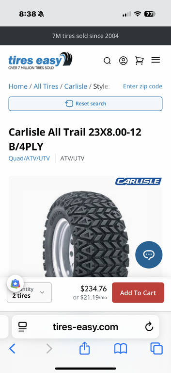

Sparky-(Admin) 25,295 #4 Posted May 9, 2025 I always recommend these when asked. Carlisle All-Trails, although the company name has changed to Carlstar now. When I picked up these they only came in 23x10.5 and 23x8.0, not sure if that’s still the case. The 8.0’s are mounted on standard width wheels and my 10.5’s are on wide wheels like the 520-H’s come with. I can’t explain the height diff. 3 1 Share this post Link to post Share on other sites

Toolmanbill 44 #11 Posted May 10, 2025 Can’t seem to find these calstar tires.any links known? Share this post Link to post Share on other sites
Sparky-(Admin) 25,295 #12 Posted May 10, 2025 (edited) 4 hours ago, Toolmanbill said: Can’t seem to find these calstar tires.any links known? Having an issue posting links for some reason. Try searching Carlisle All Trail 23x8 instead of Carlstar. https://www.tires-easy.com/tires/?filtering=carlisle all trail 23x8,relevance Edited May 10, 2025 by nylyon Added link Share this post Link to post Share on other sites

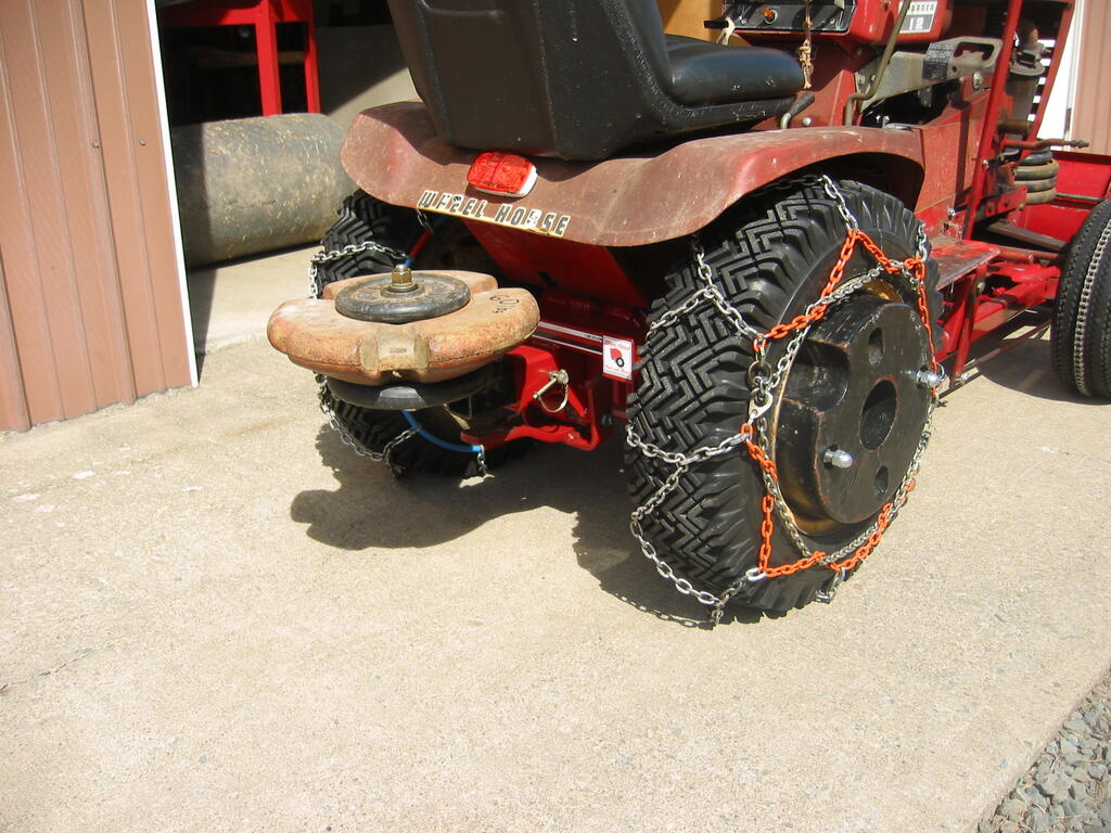

pfrederi 20,544 #20 Posted May 12, 2025 I run rubber chains on 10.50 on a Charger 12 no clearance issues. However if your drive way is gravel and sloped I would suggest you get some 6.00 x 12 tires (on the 5.inch rims) add 2 link v chains and weights for winter use. This set up pushes a 56" blade and will drag a M16 down in heavy snow before I lose traction. 2 Share this post Link to post Share on other sites
