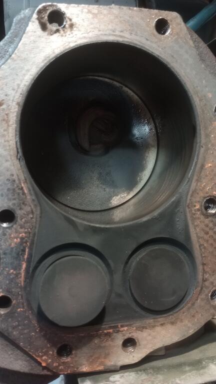

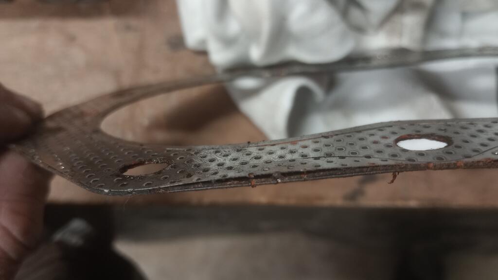

uk175horse 19 #1 Posted May 8, 2025 hi guys, I have a k341 engine on c175 that's barely starting. Was running pretty well a few weeks ago, then a week ago seemed to be misfiring/running rough and now took 30 seconds or more turning over to start then died in a few seconds. Took the air filter out and soaked in fuel! Cleaned all the carb and no different . Now took the head off and it's very carbonated . Also head gasket looks damaged ? Thinking I just clean it up and new gasket but why the fuel in air filter?? Share this post Link to post Share on other sites
ineedanother 2,879 #2 Posted May 8, 2025 (edited) That carbon isn't terrible but you definitely need a head gasket and should probably take care of a couple fairly simple tasks while you replace that. As far as the fuel in the air cleaner is concerned, excessive flooding of the carb likely due to a stuck or badly adjusted float that isn't closing that jet. It could also be a badly worn jet. Edited May 8, 2025 by ineedanother 1 1 Share this post Link to post Share on other sites

uk175horse 19 #4 Posted May 8, 2025 thanks, I replaced the head gasket last year already and followed the bolt order and torque so not sure why it's so warped . I took a look at the float earlier and wasn't damaged but not sure if the pin that closes the jet is ok, could be worn . The idle /main adjustment screws looked quite worn . I've got a new aftermarket carb on order now to test . What were the other simple tasks I should check out? Share this post Link to post Share on other sites

stvski80085 279 #6 Posted May 9, 2025 You may want to sand the head level again while it’s off. Search this site for how to do it. It’s easy. steve 1 1 Share this post Link to post Share on other sites
oliver2-44 11,767 #7 Posted May 9, 2025 In this picture see the clean outer edge of the piston. That typically means there is some blowby. Not terrible, I’ve run one like that from many years. While you have it open it would be a good time to pull and lap the valves, then adjust there clearance. 1 1 Share this post Link to post Share on other sites
ineedanother 2,879 #8 Posted May 9, 2025 18 hours ago, oliver2-44 said: In this picture see the clean outer edge of the piston. That typically means there is some blowby. That's something I never heard or knew before. Share this post Link to post Share on other sites
