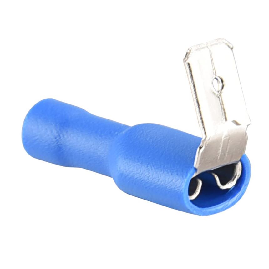

squonk 47,898 #9 Posted May 8, 2025 38 minutes ago, 1968Commando said: Also when wiring in my starter gen light I have the 5 post switch that you slide connectors over how would I add the generator light wire to the ignition spade when there is already somthing on that Double spade terminal. 1 1 Share this post Link to post Share on other sites
ebinmaine 80,364 #10 Posted May 8, 2025 1 minute ago, 1968Commando said: So..I shouldn’t use the blue wire for wiring the headlights and the points coil and then grounding the solenoid I should use different color for everything? You CAN use it..... I just WOULDN'T use it. Part of that is because I'm kind of particular about the way that I wire things. But part of that is because if you ever come back to fix something, you may regret having all the wires the same color. When I rewire a tractor I put a ground circuit to every component. You don't have excessive ground circuits until the harness starts to look like black spaghetti. I try to make different components have different positive colors as well. I don't necessarily have a super strict adhesion to a system there but usually yellow or orange would be for lighting. Red would be for coil. Or generator. Nothing at all wrong with mixing it up and making it your own but make sure when you come back to mess with it a few years later, you can. Share this post Link to post Share on other sites
1968Commando 189 #11 Posted May 8, 2025 9 minutes ago, squonk said: Double spade terminal. Holy crap didn’t even know that was a thing Share this post Link to post Share on other sites
