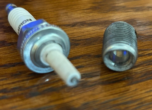

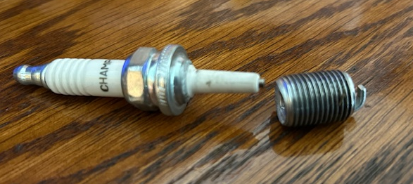

JoeM 10,269 #1 Posted May 7, 2025 Got a call today from a friend that was changing spark plugs in his CH22 Kohler. The conversation started out, "I got big troubles!" He said he snapped off a spark plug when tightening it. I said the porcelain? No the whole top of the plug, nut and all! Oh boy! He sent me a pic. Yep that is a problem. Said the torque wrench was set at 20 ft lbs and it broke before it clicked. Hmmm. I went right over and after a few tense moments with a long easy out, the threaded part came out. Looking closer at the break point, I noticed there is not much material between the nut and threads. Guess they just don't make them like the used to? 6 Share this post Link to post Share on other sites

RED-Z06 2,720 #7 Posted May 7, 2025 21 years in small engine repair ive never used a torque wrench on a spark plug. Tapered seat...finger tight then 1/16-1/8 turn. Gasket type...finger tight then 1/2 turn. Almost every stripped plug hole i have to repair is from someone using a torqe wrench and it pulls the threads going in, and galls coming out. 4 1 Share this post Link to post Share on other sites
