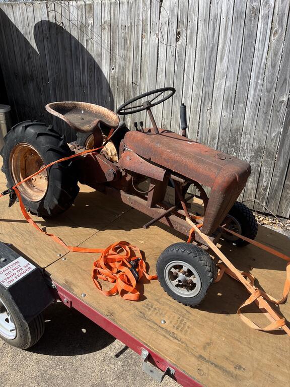

Wayne0 1,543 #2 Posted May 7, 2025 I like the front "Mags"! 1 1 Share this post Link to post Share on other sites
Eriks Red horse herd 133 #3 Posted May 7, 2025 Nice little 400 stilling her work clothes. Good pick congrats! 2 Share this post Link to post Share on other sites
Pullstart 69,457 #4 Posted May 8, 2025 nice Suburban! 2 Share this post Link to post Share on other sites

Ricky Bobby 27 #6 Posted May 8, 2025 On 5/7/2025 at 2:36 PM, Wayne0 said: I like the front "Mags"! Ha Ha, they are all yours! 2 Share this post Link to post Share on other sites
Ricky Bobby 27 #7 Posted May 8, 2025 22 hours ago, Pullstart said: nice Suburban! Thank you! Pretty rare find in Texas I think. 1 Share this post Link to post Share on other sites
953 nut 64,858 #8 Posted May 8, 2025 6 minutes ago, Ricky Bobby said: I will need some help with finding some gears, seals and bearings. @stevasaurus has a post on the three piece that is outstanding. He may have a cluster gear or two kicking around too. 2 Share this post Link to post Share on other sites
Ricky Bobby 27 #9 Posted May 8, 2025 On 5/7/2025 at 5:41 PM, Eriks Red horse herd said: Nice little 400 stilling her work clothes. Good pick congrats! Thanks, it was sitting in a back yard for many years, lots of rust inside and out. 1 Share this post Link to post Share on other sites
Pullstart 69,457 #10 Posted May 8, 2025 E-tank will be your best friend for that one! 2 Share this post Link to post Share on other sites

WHX?? 55,834 #14 Posted May 9, 2025 Lowell has the bearings & seals & I bet @Jake Kuhn has the gears. https://wheelhorsepartsandmore.com/product-category/manual-transmissions/ Nice score ... orginal survivor. Share this post Link to post Share on other sites
oliver2-44 11,335 #15 Posted May 9, 2025 Nice original Suburban. It even has the original belt guard and exhaust shield. Your transmission casting date A30-0 translates to January 30, 1960. The solid seat pan also dates it to possibly be an earlier one. Looks like you missing the foot rest and front rims. Those rims can be hard to find due to the center tube being longer than many later ones. They were only used in 60/61. The tires were filled with calcium chloride for weight which rusted the rims out. On the dash between the throttle and choke levers that plate has a serial number stamped in it. With the rust the stamping can be very light. Polish it with scotch bite or fine steel wool and see if you can make any numbers out on it. I’am 4 hours down the road in Marble Falls, Tx. 1 Share this post Link to post Share on other sites
