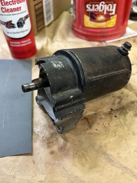

Horse Newbie 7,405 #26 Posted May 7, 2025 No, and I couldn’t even feel the crack with my fingers. The only way I knew it was there was when I sprayed electronic cleaner on it the crack stayed wet a little longer and showed the crack. I have already put the starter back together after sanding the commutator and undercutting the mica. I tested the starter and it spins nice with no noise. All I need is the bendix gear parts which are on order. 2 Share this post Link to post Share on other sites

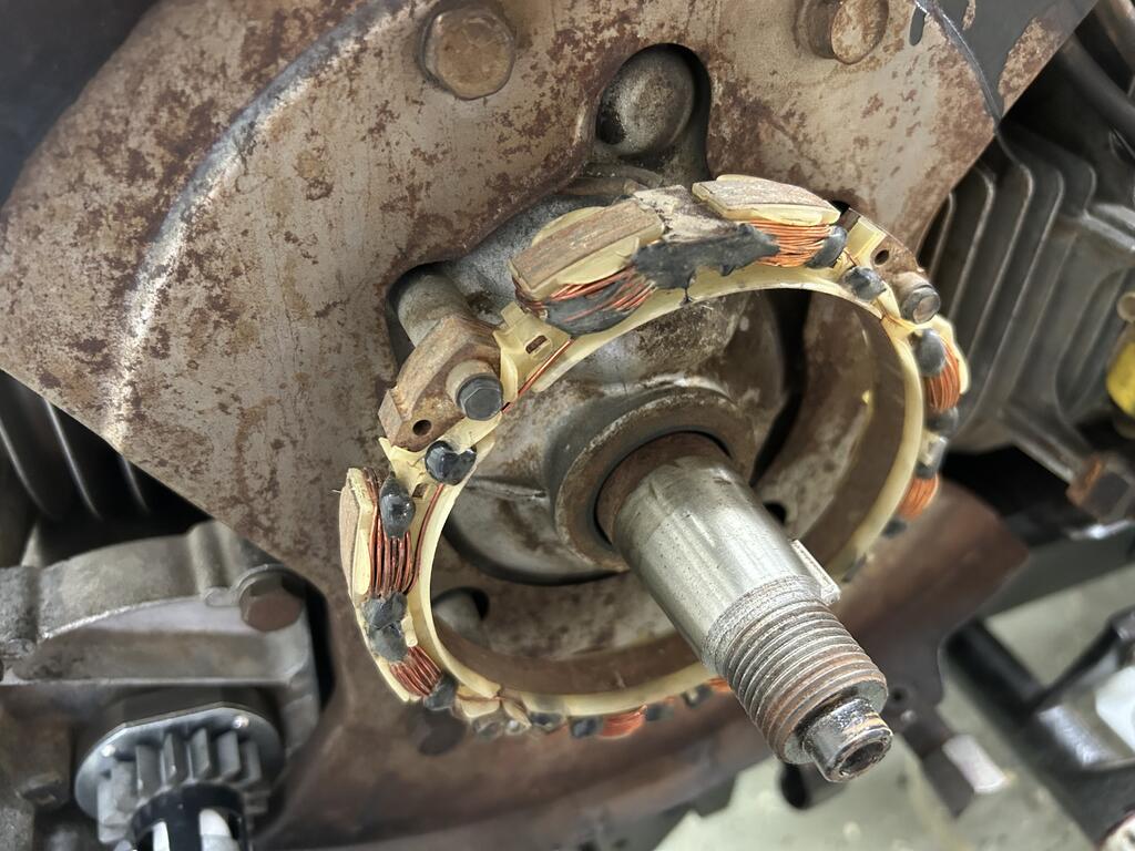

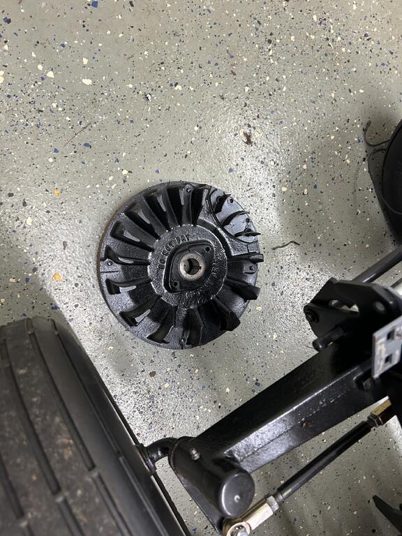

Horse Newbie 7,405 #27 Posted May 7, 2025 I also went ahead and pulled the flywheel as I can see getting the starter back on with it in place would be difficult in not impossible. I will clean the stator and back of flywheel before I reassemble. 2 Share this post Link to post Share on other sites

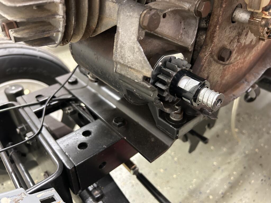

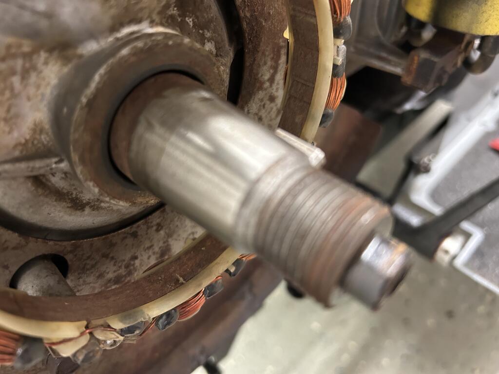

Horse Newbie 7,405 #35 Posted May 30, 2025 So I got my bendix gear on the starter and got the starter back on the engine. Time to reinstall the flywheel. Any harm in putting a small amount of of antisieze on the crank for future ease of flywheel removal ? Share this post Link to post Share on other sites
Handy Don 17,474 #36 Posted May 31, 2025 2 hours ago, Horse Newbie said: Any harm in putting a small amount of of antisieze on the crank for future ease of flywheel removal 1 Share this post Link to post Share on other sites
Achto 32,732 #37 Posted May 31, 2025 3 hours ago, Horse Newbie said: Any harm in putting a small amount of of antisieze on the crank for future ease of flywheel removal ? Not recommended by Briggs. Manual says to install it dry, warning that lube can have adverse effects. 1 1 Share this post Link to post Share on other sites
Horse Newbie 7,405 #38 Posted May 31, 2025 (edited) I wonder what adverse effects it could have ? With a tapered shaft, key way, and the nut tightened with an impact wrench ? Edited May 31, 2025 by Horse Newbie Share this post Link to post Share on other sites
Horse Newbie 7,405 #39 Posted May 31, 2025 Does the Briggs manual mention a torque value for the flywheel nut ? I watched a video where a small engine guy explains why it is not a good idea. Share this post Link to post Share on other sites
Achto 32,732 #40 Posted May 31, 2025 3 minutes ago, Horse Newbie said: With a tapered shaft, key way, and the nut tightened with an impact wrench ? The minute film causes improper seating of the fly wheel to the crank shaft, which will cause the butter key to shear eventually. I call the Briggs flywheel key a butter key because it is such a soft material. The soft key is designed to protect things. I strongly discourage using an impact on the flywheel nut, too tight can cause the fly wheel to fracture. You do not want a fly wheel disintegrating next to your leg at 3600RPMs. Use a torque wrench. 1 Share this post Link to post Share on other sites
Horse Newbie 7,405 #41 Posted May 31, 2025 Glad I got on here and asked. I will put the flywheel back on tomorrow. 2 Share this post Link to post Share on other sites
Achto 32,732 #42 Posted May 31, 2025 Can't seem to find the correct manual. Spec / model number might help. I would think that 60 to 75ft.lbs. on the flywheel nut would be good. 1 Share this post Link to post Share on other sites
WHX?? 58,150 #43 Posted May 31, 2025 Yes absolutely no impact on removing or installing nut. Too much likelihood of snapping off the crank threads. I like to torque to 70% of spec then final. 2 Share this post Link to post Share on other sites

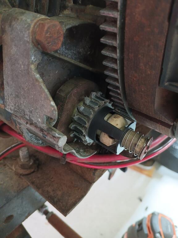

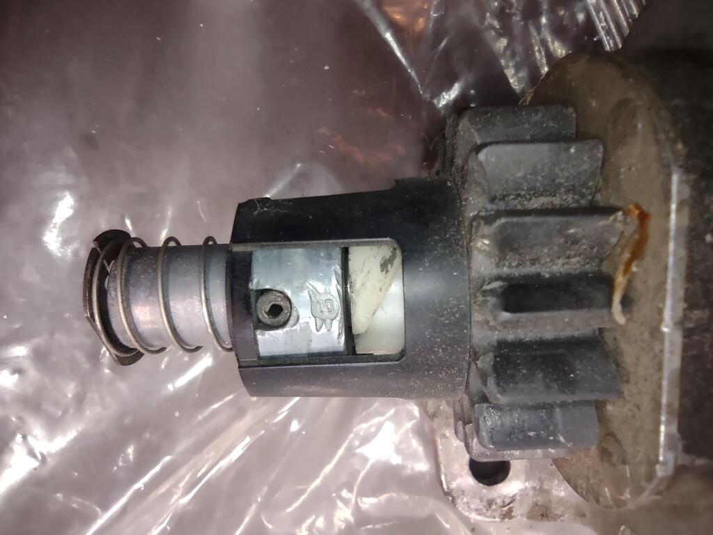

ebinmaine 80,741 #44 Posted June 2, 2025 On 5/6/2025 at 6:22 PM, Horse Newbie said: How do I remove this clip on the end of the shaft at bendix gear ? So how did you get that done? As you can see we need to change the gear here. 1 Share this post Link to post Share on other sites
Achto 32,732 #45 Posted June 2, 2025 1 hour ago, ebinmaine said: So how did you get that done? Drive the roll pin out and the top will come right off. 1 1 Share this post Link to post Share on other sites
Horse Newbie 7,405 #46 Posted June 2, 2025 (edited) 1 hour ago, ebinmaine said: So how did you get that done? As you can see we need to change the gear here. I used a small screwdriver. But I was replacing all the parts on that end. Don’t know if the parts are hard to find but a local lawn mower shop had Briggs OEM parts. Looks like maybe squeeze it with pliers and wiggle it out ? Edited June 2, 2025 by Horse Newbie 1 Share this post Link to post Share on other sites
Achto 32,732 #47 Posted June 3, 2025 I believe there is no need to remove the clip on the end of the starter. Just remove the roll pin and the whole assembly should come off the end. Hold the black plastic cage towards the end so that it is out of the way to avoid damage to it. Clamp a 5/16" or 3/8' deep well socket in a vise and use it for a backer when you drive the roll pin out. After the spring assembly is off the gear will remove easily. 1 1 Share this post Link to post Share on other sites
ebinmaine 80,741 #48 Posted June 3, 2025 31 minutes ago, Achto said: I believe there is no need to remove the clip on the end of the starter. Just remove the roll pin and the whole assembly should come off the end. Hold the black plastic cage towards the end so that it is out of the way to avoid damage to it. Clamp a 5/16" or 3/8' deep well socket in a vise and use it for a backer when you drive the roll pin out. After the spring assembly is off the gear will remove easily. I'm hoping to remove the gear while the starter is still on the engine. 1 1 Share this post Link to post Share on other sites
Achto 32,732 #49 Posted June 3, 2025 13 minutes ago, ebinmaine said: I'm hoping to remove the gear while the starter is still on the engine. Prolly not gonna happen. 2 Share this post Link to post Share on other sites
ebinmaine 80,741 #50 Posted June 3, 2025 7 minutes ago, Achto said: Prolly not gonna happen. No worries. Looks like the flywheels gotta come off... 1 Share this post Link to post Share on other sites
