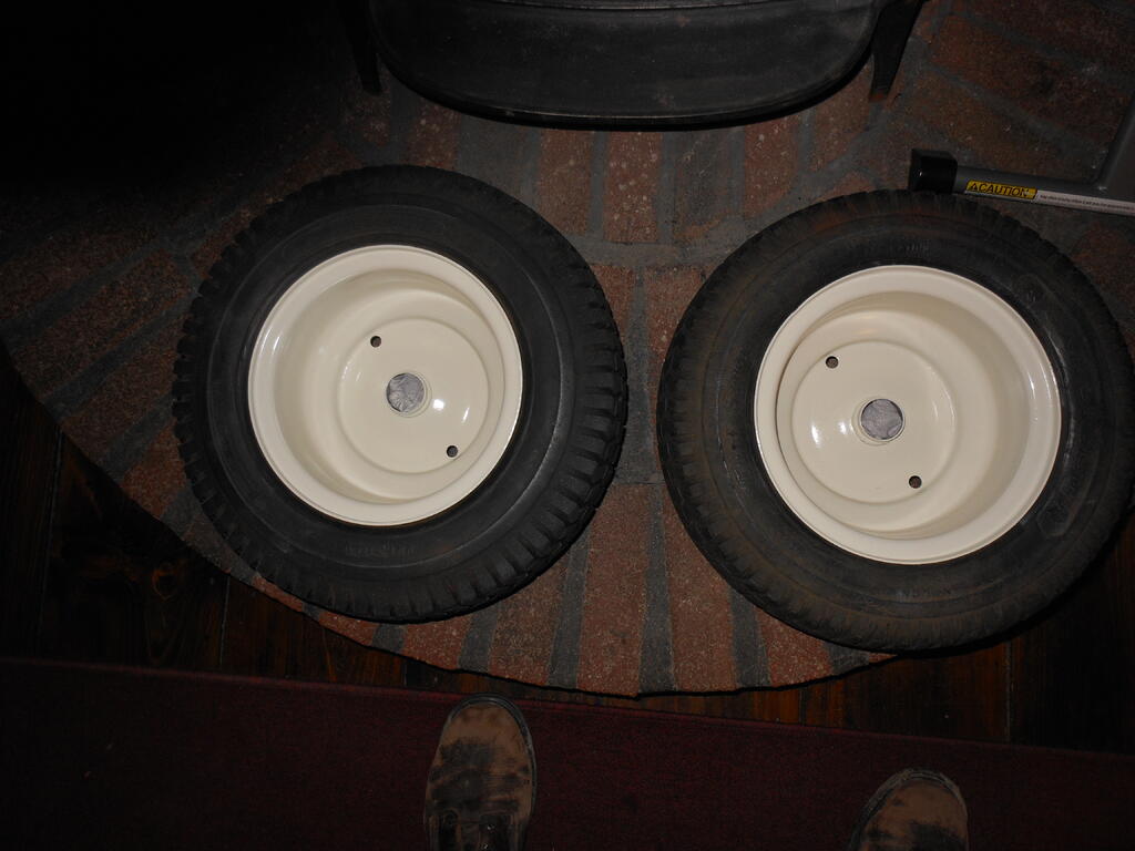

1968Commando 189 #26 Posted May 7, 2025 50 minutes ago, squonk said: I just did these wheels on Monday. Sand blasted. 2 coats of Rustoleum self etching primer. As soon as that was dry, 2 coats of Rustoleum Almond paying no attention to recommended drying time. ( maybe 10 minutes) then 2 coats of Rustoleum clear. The first coat going on whilst the lastcolor coat was still wet. That’s the thing I used rustoleum primer and it was a enamel primer and then I used rust oleum almond enamel and now I have issues so I don’t know and shoot today I looked at mg blower shroud that I primed 2 weeks ago and painted and then put a second coat on last night and it wrinkled on me I must be painting when it’s too humid or somthing 1 Share this post Link to post Share on other sites

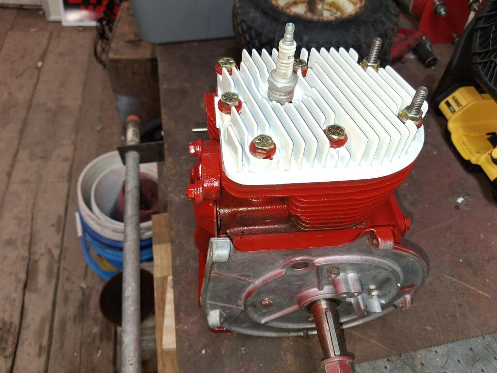

squonk 48,427 #29 Posted May 7, 2025 (edited) I use Rusto all the time. Put the clear right on over the last color while still wet. Never an issue and dries within a couple of hours. Wheels engines it doesn't matter. Did this engine about a week ago. The head I even used Duplicolor engine white with the Rusto clear right over it. put the head on the next day. Edited May 8, 2025 by squonk 1 Share this post Link to post Share on other sites

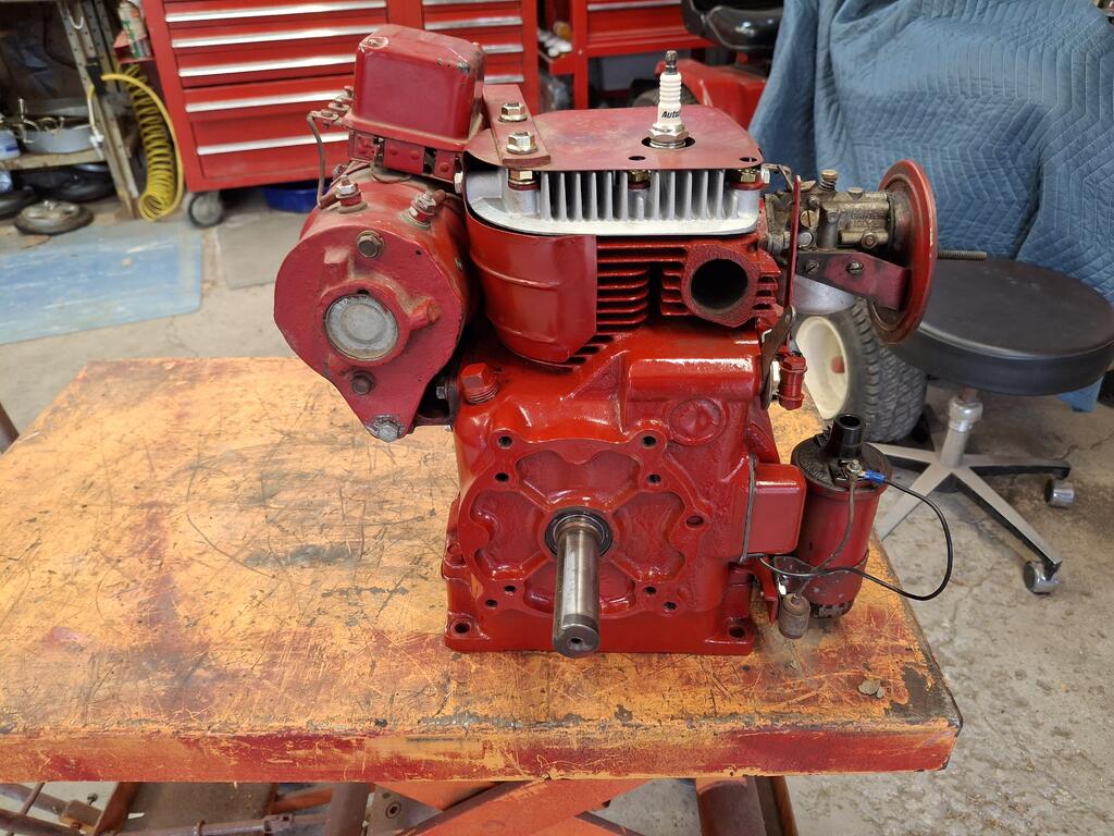

squonk 48,427 #35 Posted May 7, 2025 A pic of an engine a couple of months ago. Same method. Another set of wheels. 2 Share this post Link to post Share on other sites
1968Commando 189 #36 Posted May 8, 2025 (edited) 4 hours ago, squonk said: A pic of an engine a couple of months ago. Same method. Another set of wheels. Dang I wish mf wheels turned out that nice but you’ve probably painted more then me this is my first restore and honestly first time spray painting anything and I just painted rims and it’s hard to get them nice even with experience from what I’ve been told I am 16 though so got lots of years to learn and improve Edited May 8, 2025 by 1968Commando 1 Share this post Link to post Share on other sites
