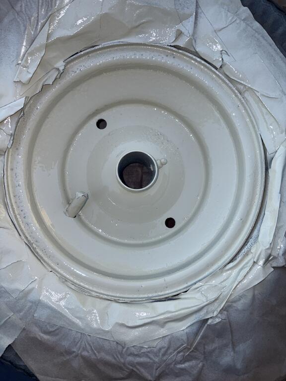

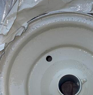

1968Commando 189 #1 Posted May 6, 2025 Hey yall, I know you guys are probably getting sick of my questions but I just started painting tonight on the rims and oh my gosh I though it was going good and then I started to notice the paint runs. Any tips or tricks out there for a new painter. Any tips or tricks are greatly appreciated. 2 Share this post Link to post Share on other sites
kpinnc 19,107 #2 Posted May 6, 2025 If you are using rattle cans, make several light coats. Holding the can further back from what you're painting and never stop moving while spraying. Different brand paints lay down very differently one to another. You'll have to test on another surface any time you change brands. 5 Share this post Link to post Share on other sites
8ntruck 9,420 #3 Posted May 6, 2025 Use several light coats instead of heavy coat. Your current issue is probably what to do with the runs. Let the paint cure for a couple weeks, sand the runs out, scuff the rest of the paint, then spray on a couple light coats. A quicker method would be to wire brush the paint off and start over. Good luck. Remember - you gain knowledge from your own mistakes and wisdom from others mistakes. 1 2 Share this post Link to post Share on other sites
1968Commando 189 #4 Posted May 6, 2025 23 minutes ago, 8ntruck said: Use several light coats instead of heavy coat. Your current issue is probably what to do with the runs. Let the paint cure for a couple weeks, sand the runs out, scuff the rest of the paint, then spray on a couple light coats. A quicker method would be to wire brush the paint off and start over. Good luck. Remember - you gain knowledge from your own mistakes and wisdom from others mistakes. So if I painted one rim tonight I can’t just hit it with some sandpaper tomorrow or will it just look werid and not good? 1 Share this post Link to post Share on other sites
1968Commando 189 #5 Posted May 6, 2025 (edited) 29 minutes ago, kpinnc said: If you are using rattle cans, make several light coats. Holding the can further back from what you're painting and never stop moving while spraying. Different brand paints lay down very differently one to another. You'll have to test on another surface any time you change brands. Ok thank you I will say I do kinda think my rattle can is messed up because a few times it sprayed bubbles of paint onto the rim so i might just go buy another can Edited May 6, 2025 by 1968Commando 1 Share this post Link to post Share on other sites
oliver2-44 11,847 #6 Posted May 6, 2025 To speed up paint curing, set the rim in front of a small portable heater to bake it dry. Also you may be able to take a sharp knife or razor blade and shave some of the run off. 1 Share this post Link to post Share on other sites
ri702bill 13,394 #7 Posted May 6, 2025 (edited) Two things - if you used enamel to paint them, it takes more than a week for it to cure enough to be sanded. If you can push your fingernail into a run and it leaves a mark, it is too soft to sand. Best bet is either paint remover solvent or acetone with rags & elbow grease to remove it back to the original paint. An old trick from my Model Car building days - heat the rattle can before you use it in a pan of hot tap water. It heats the paint so it flashes off faster, redicing the chance of runs and raises the internal pressure to give a better spray. Heat the can between coats - be sure to wipe the can to remove water that can (will) drip on the work. Are your tires already mounted? I hope so, as tire mounting tool will rip up the paint on the lip.... the playing card trick on a deflated tire works great... Edited May 6, 2025 by ri702bill 3 2 Share this post Link to post Share on other sites

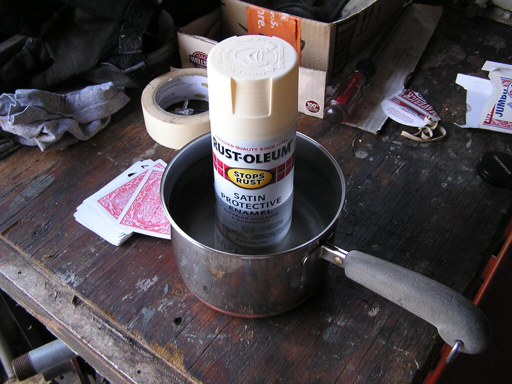

JoeM 10,318 #8 Posted May 6, 2025 The odd shape of a rim makes it harder to paint. You have to look at the paint as it is sprayed to make sure you have just a hint of a wet edge as it lays down. I with the others on warming the can and spraying a mist/light tac first coat. Shake well means to shake the cans well. Regular Rustoleum can be unforgiving. 2x Rustoleum is a bit more forgiving. If you want your finish to be tough and UV resistant, a couple of light coats of Rustoleum Clear Enamel to finish will help. Even when I spray gun the cheap Majic Tractor Supply paint, I clear over it with a Rattle Can of clear. I put 2 light coats, 10 minutes apart. after the last coat of color. 2 1 1 Share this post Link to post Share on other sites
953 nut 70,654 #9 Posted May 6, 2025 One other tip for spray painting. Begin the spray before it gets to the object to be painted and continue spraying with a continuous motion until you have passed the other edge. If you just start spraying at the edge you will be putting more material on that spot. 1 hour ago, ri702bill said: tire mounting tool will rip up the paint on the lip. I have cut the fingers off an old leather glove, place that leather on the tire mounting tool and it will reduce the likelihood of paint damage. 2 Share this post Link to post Share on other sites
1968Commando 189 #10 Posted May 6, 2025 (edited) 2 hours ago, ri702bill said: Two things - if you used enamel to paint them, it takes more than a week for it to cure enough to be sanded. If you can push your fingernail into a run and it leaves a mark, it is too soft to sand. Best bet is either paint remover solvent or acetone with rags & elbow grease to remove it back to the original paint. An old trick from my Model Car building days - heat the rattle can before you use it in a pan of hot tap water. It heats the paint so it flashes off faster, redicing the chance of runs and raises the internal pressure to give a better spray. Heat the can between coats - be sure to wipe the can to remove water that can (will) drip on the work. Are your tires already mounted? I hope so, as tire mounting tool will rip up the paint on the lip.... the playing card trick on a deflated tire works great... I used rust oleum paint plus primer almond which I assume is a different type of paint Edited May 6, 2025 by 1968Commando 1 Share this post Link to post Share on other sites
1968Commando 189 #11 Posted May 6, 2025 37 minutes ago, 953 nut said: One other tip for spray painting. Begin the spray before it gets to the object to be painted and continue spraying with a continuous motion until you have passed the other edge. If you just start spraying at the edge you will be putting more material on that spot. I have cut the fingers off an old leather glove, place that leather on the tire mounting tool and it will reduce the likelihood of paint damage. Lucky for me mine are mounted still, how hot does this water need to be? 1 Share this post Link to post Share on other sites
Achto 32,963 #12 Posted May 6, 2025 (edited) 9 hours ago, 1968Commando said: So if I painted one rim tonight I can’t just hit it with some sandpaper tomorrow or will it just look werid and not good? If you sand the runs out you will need to spray another coat or 2 of paint on the rim for it to look good. Read and respect the recoat time that is printed on the can, if you recoat "dry" paint too soon you may end up with a lifting issue. Lifting = your paint will start to wrinkle. If this happens you will need to strip the part down & start over. Recoat time can be 72hrs - 2 weeks. Note: you will need to scuff the whole part if you are going to repaint. Scotchbrite works great for this. The can may give you a recommended time between coats, 15 min, 30min, what ever. The best & most fool proof way is to touch the painted part. Pick a spot that will not be seen when assembled and touch it lightly. It should feel tacky but should not transfer paint to your finger. If you see paint on your finger, wait longer. No paint on your finger spray your next coat. Edited May 6, 2025 by Achto 4 Share this post Link to post Share on other sites
1968Commando 189 #13 Posted May 6, 2025 Okay 15 minutes ago, Achto said: If you sand the runs out you will need to spray another coat or 2 of paint on the rim for it to look good. Read and respect the recoat time that is printed on the can, if you recoat "dry" paint too soon you may end up with a lifting issue. Lifting = your paint will start to wrinkle. If this happens you will need to strip the part down & start over. Recoat time can be 72hrs - 2 weeks. Note: you will need to scuff the whole part if you are going to repaint. Scotchbrite works great for this. The can may give you a recommended time between coats, 15 min, 30min, what ever. The best & most fool proof way is to touch the painted part. Pick a spot that will not be seen when assembled and touch it lightly. It should feel tacky but should not transfer paint to your finger. If you see paint on your finger, wait longer. No paint on your finger spray your next coat. Okay thank you sir. 1 Share this post Link to post Share on other sites
kpinnc 19,107 #14 Posted May 6, 2025 10 hours ago, 1968Commando said: it sprayed bubbles Periodically check while painting for accumulation around the nozzle. That will make spatters every time. 2 Share this post Link to post Share on other sites

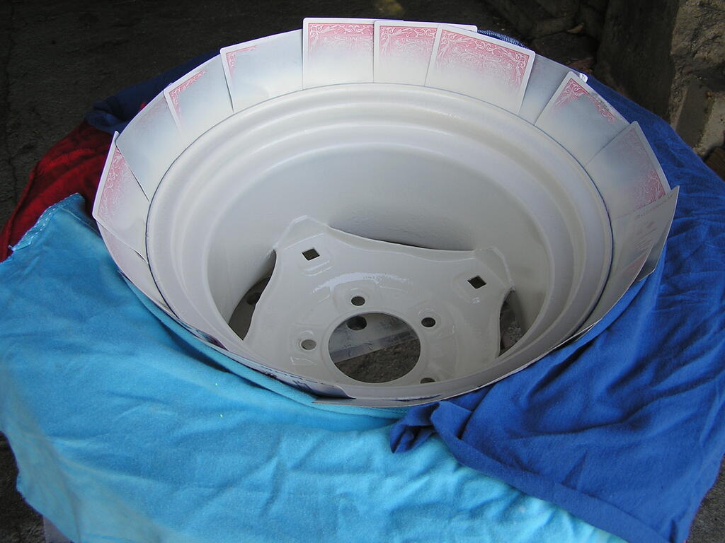

rmaynard 17,659 #24 Posted May 7, 2025 When I was a young man back in 1980, I took a night school course in Body & Painting. One of the questions that came up in the first class was about painting with spray cans. My instructor thought for a moment and then said something like this. "All that I will say is that people are either good at painting, or they are not. Spray can paint is either good or it's not. Conditions optimal for painting outdoors are either good or they are not. Chances of getting all three to come together in one place at one time are mostly not". So, good luck. 2 Share this post Link to post Share on other sites

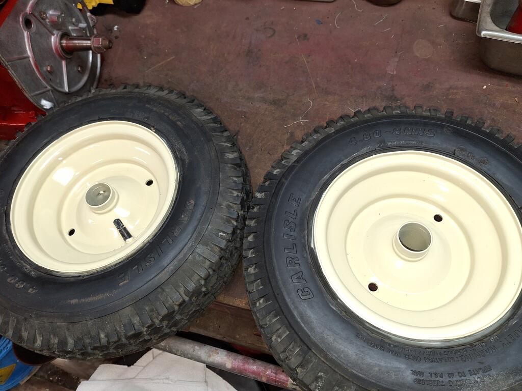

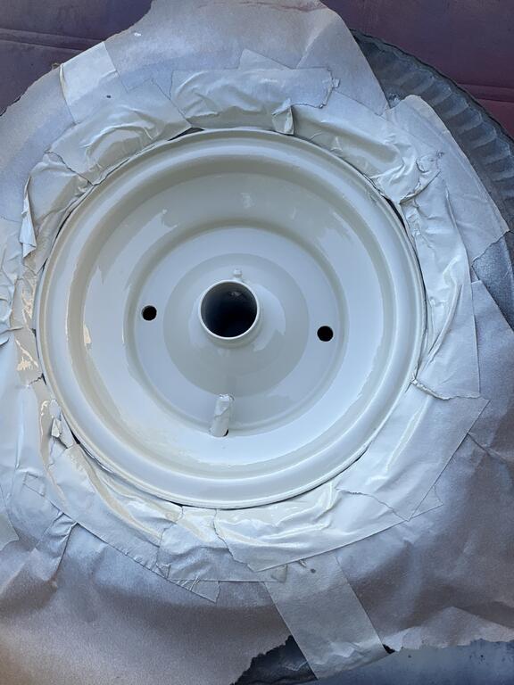

squonk 48,427 #25 Posted May 7, 2025 I just did these wheels on Monday. Sand blasted. 2 coats of Rustoleum self etching primer. As soon as that was dry, 2 coats of Rustoleum Almond paying no attention to recommended drying time. ( maybe 10 minutes) then 2 coats of Rustoleum clear. The first coat going on whilst the lastcolor coat was still wet. 1 Share this post Link to post Share on other sites
