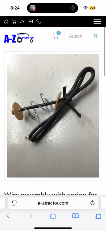

1968Commando 189 #1 Posted May 5, 2025 (edited) Hey all, my wheel horse came to me missing my headlight so I have nothing to see in person or look at, so from what I can gather this is the headlight I need and if I’m correct is this the light wires that go to it? And is this all I need so then I just get a light bulb and screw it in or am I missing something I guess I’m having a hard time imagining how the light bulb would be held in place…sorry if I make this confusing to yall I just don’t want to buy something and realize I’m still missing pieces Edited May 5, 2025 by 1968Commando Share this post Link to post Share on other sites
Achto 32,248 #2 Posted May 5, 2025 You'll also need one of these. https://www.a-ztractor.com/product_info.php?cPath=1_30_32_49&products_id=8164 The bulbs for it are 1156 or LED equivalent. Share this post Link to post Share on other sites
1968Commando 189 #3 Posted May 5, 2025 3 minutes ago, Achto said: You'll also need one of these. https://www.a-ztractor.com/product_info.php?cPath=1_30_32_49&products_id=8164 The bulbs for it are 1156 or LED equivalent. Okay, do you suggest a new one or a used one they seem to be a pricy item Share this post Link to post Share on other sites

Achto 32,248 #7 Posted May 5, 2025 8 hours ago, 1968Commando said: Okay, do you suggest a new one or a used one they seem to be a pricy item Used is good if you find one. If you get a new one I suggest running LED 1156 bulbs, the incandescent bulbs put off more heat & can damage the decal on the inside of the new aftermarket ones. . Share this post Link to post Share on other sites
1968Commando 189 #8 Posted May 5, 2025 4 hours ago, Achto said: Used is good if you find one. If you get a new one I suggest running LED 1156 bulbs, the incandescent bulbs put off more heat & can damage the decal on the inside of the new aftermarket ones. . Okay thank you Share this post Link to post Share on other sites
