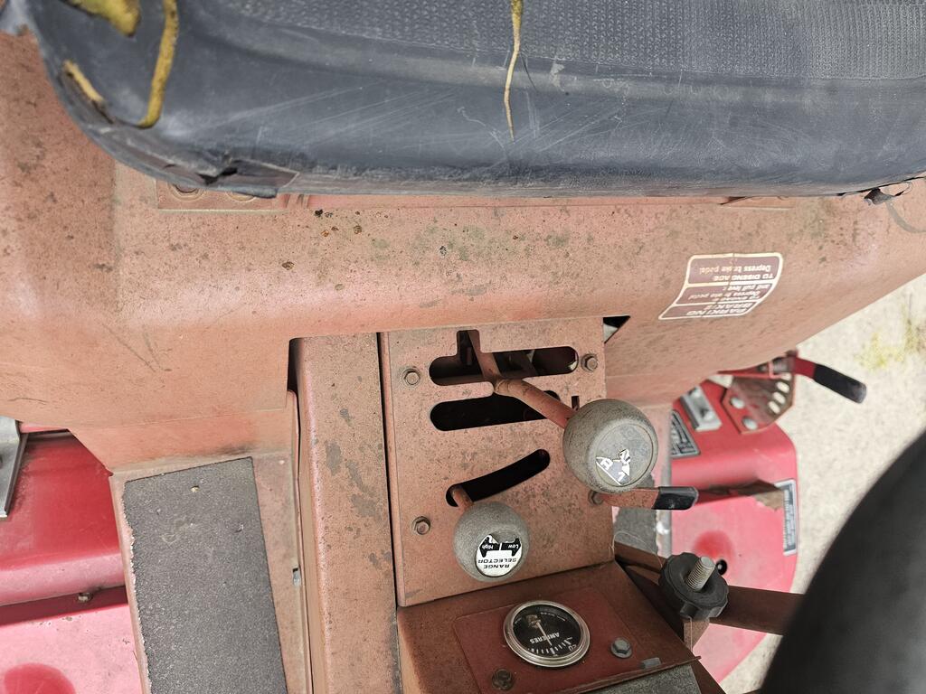

Jayoutdoors 106 #1 Posted May 5 (edited) What could have happened and how do I fix? I put in reverse to back off trailer. Suddenly clutch went to "floor" and shifter is stuck in middle of pattern with trans in reverse... Edited May 5 by Jayoutdoors 1 Share this post Link to post Share on other sites

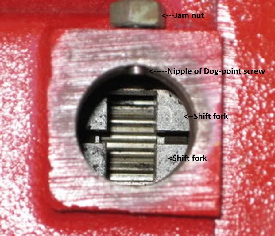

WHX?? 53,181 #2 Posted May 5 (edited) Pull the shifter and look for the neutral H pattern. Use some screw drivers to try and get back into neutral. Somebody will post a pic I can't find it in this mess... Edited May 5 by WHX?? 1 1 Share this post Link to post Share on other sites

daveoman1966 3,880 #4 Posted May 5 Common problem--- The 'dog point screw' at the base of the shift lever (ball) has either broken off or needs adjusting. Pull the dust cover and have a look-C. As WHX sez---wiggle the shift forks around, then adjust the NIPPLE of the dog point screw, using the jam nut to lock it in place after getting it set right. 1 5 2 Share this post Link to post Share on other sites

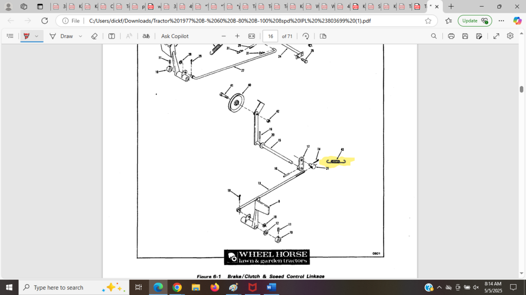

953 nut 62,868 #5 Posted May 5 This thread has you covered on the shifter being stuck. Thew clutch going to the floor could be ther clutch return spring (highlighted in drawing) or a linkage that came undone. 2 1 Share this post Link to post Share on other sites

Jayoutdoors 106 #8 Posted May 5 18 hours ago, daveoman1966 said: Common problem--- The 'dog point screw' at the base of the shift lever (ball) has either broken off or needs adjusting. Pull the dust cover and have a look-C. As WHX sez---wiggle the shift forks around, then adjust the NIPPLE of the dog point screw, using the jam nut to lock it in place after getting it set right. Thank you! will update as soon as i get a chance to get out there to work onit! Share this post Link to post Share on other sites
Jayoutdoors 106 #9 Posted May 5 11 hours ago, 953 nut said: This thread has you covered on the shifter being stuck. Thew clutch going to the floor could be ther clutch return spring (highlighted in drawing) or a linkage that came undone. thank you 1 Share this post Link to post Share on other sites

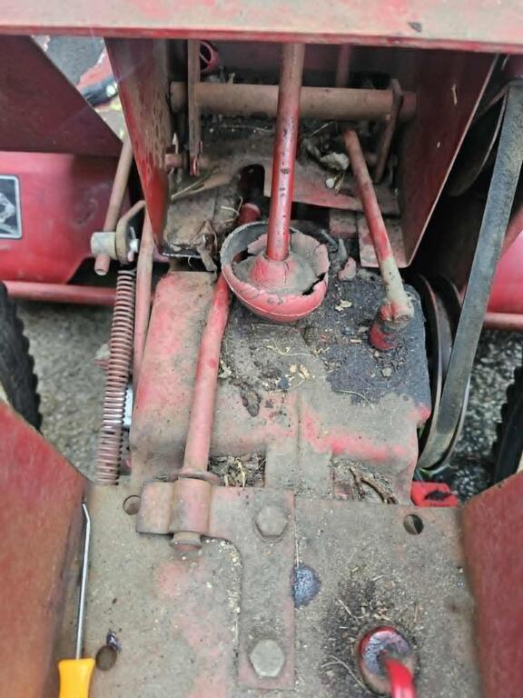

Jayoutdoors 106 #10 Posted May 6 On 5/5/2025 at 4:48 PM, Pullstart said: This is generally only an issue with 3 speeds of the early flavor. Let us know if it works for your 8 speed! it was the issue. but i found a ton of water in trans shall i clean with atf then refill with what oil? also where is best place to get new shift boot? Share this post Link to post Share on other sites
SylvanLakeWH 29,734 #11 Posted May 7 Raise front end up a foot or so. There's a hump in the trans that prevents all oil from draining. Drain from hex bolt on bottom. Yes flush with diesel and fill with 80/90 gear oil. Replace the rubber cap on the shifter so water isn't a problem... Share this post Link to post Share on other sites
Jayoutdoors 106 #12 Posted May 7 9 minutes ago, SylvanLakeWH said: Raise front end up a foot or so. There's a hump in the trans that prevents all oil from draining. Drain from hex bolt on bottom. Yes flush with diesel and fill with 80/90 gear oil. Replace the rubber cap on the shifter so water isn't a problem... Just got done flushing with a kerosene atf mix. I did tilt to drain. Letting drip drain now. New boot on order. 3 2 Share this post Link to post Share on other sites
