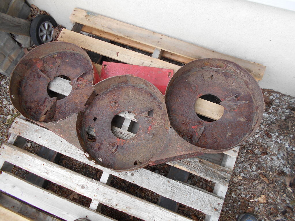

Sparky-(Admin) 26,373 #2 Posted May 4, 2025 Welcome to Red Square! Can you post a picture of the underside of the deck? I think there’s a mulching insert that simply unbolts for removal. Stole this pic of the mulching insert from another thread: Share this post Link to post Share on other sites
squonk 48,127 #3 Posted May 4, 2025 A genuine RD WH mulching deck has the insert. Take off 4 bolts. Insert is heavy. Share this post Link to post Share on other sites
nylyon-(Admin) 9,059 #4 Posted May 5, 2025 In addition to removing the insert, if I recall 2 bolts need to go back into the deck. Also the blades for the recycler are different than the RD blades, I am sure that they will work fine, but they are wider. 1 Share this post Link to post Share on other sites
gwest_ca-(File Mod) 12,488 #5 Posted May 5, 2025 Reverse the installation instructions to remove Share this post Link to post Share on other sites
squonk 48,127 #6 Posted May 5, 2025 Yes. the 2 bolts in the front need to go back in as they hold the deck carrier. 2 Share this post Link to post Share on other sites
