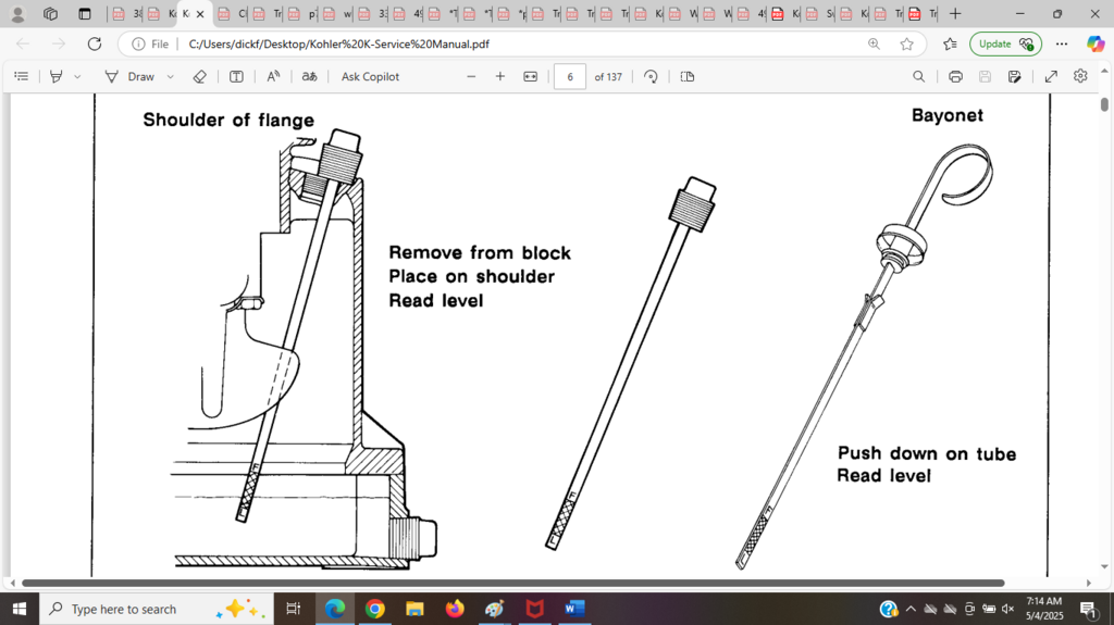

Retired Wrencher 6,792 #3 Posted May 4, 2025 @FLtractor How did you check the Oil? Did you put the dipstick on to top of the engine block? NOT THREADED IN. This does make a difference! Share this post Link to post Share on other sites
953 nut 67,451 #4 Posted May 4, 2025 2 hours ago, FLtractor said: now difficult to read dipstick due to clear oil… When checking the oil I clean the dipstick, check the level as shown below and lay the dipstick on a clean sheet of paper. The oil will show up on the paper so you can see where it is on the dipstick. Share this post Link to post Share on other sites
John2189 594 #5 Posted May 4, 2025 15 minutes ago, 953 nut said: When checking the oil I clean the dipstick, check the level as shown below and lay the dipstick on a clean sheet of paper. The oil will show up on the paper so you can see where it is on the dipstick. I use a light colored rag for a background. Or make the oil on the dipstick shine from the lights. 1 Share this post Link to post Share on other sites

FLtractor 187 #8 Posted May 4, 2025 12 hours ago, 953 nut said: When checking the oil I clean the dipstick, check the level as shown below and lay the dipstick on a clean sheet of paper. The oil will show up on the paper so you can see where it is on the dipstick. Yes I checked it using this exact picture.. on the shelf… if I did over fill the oil… Is it a simple fix of suctioning out to just below the full fill line or since I ran the tractor alraady… did I potentially damage and need to replace anything? Share this post Link to post Share on other sites
