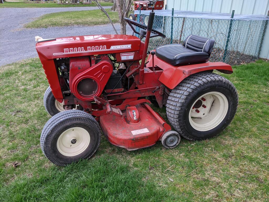

rjg854 13,360 #8 Posted May 1, 2025 I have a Commando 8 which is basically the same tractor and I mow in 2nd gear. I don't think a newer deck would work on a short frame tractor. 5 1 Share this post Link to post Share on other sites

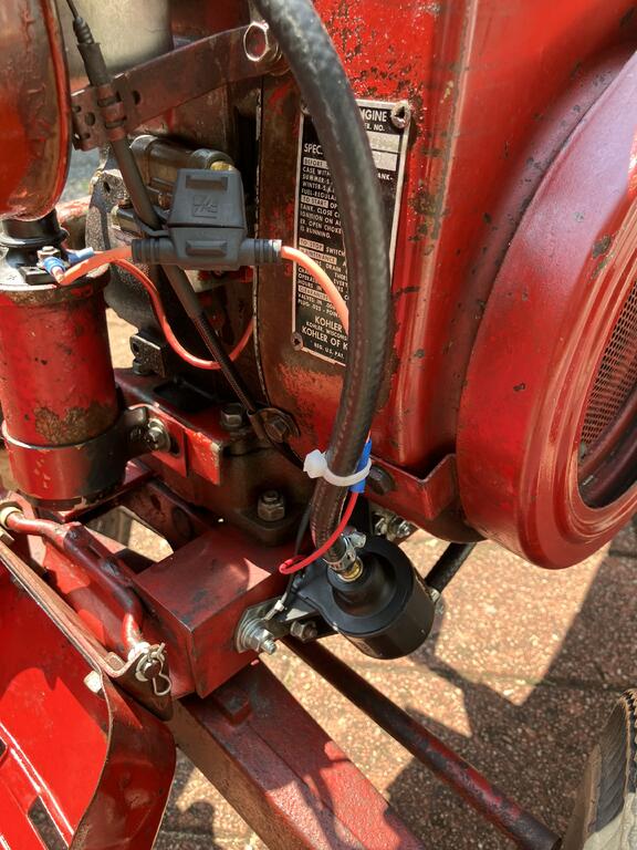

Retired Wrencher 6,989 #12 Posted May 4, 2025 @C100_8 You will like the 856 Good tractor in tight spaces. Easy to move when not running. Rock solid K181 engine. I put an electric fuel pump on mine for easy starting. Share this post Link to post Share on other sites

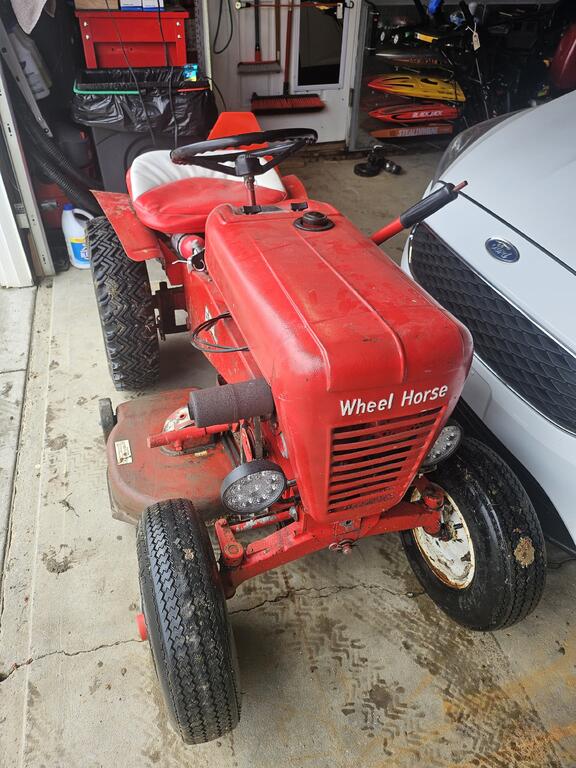

ML3 2,510 #13 Posted May 4, 2025 I think the 856 will get a good mowing tractor if you dont mind shifting. I mow with a 654. The rear discharge round deck does mow nice. I agree on using 2nd gear & about 3/4 throttle for mowing. Actually the same gear/throttle application seems to work best for plowing snow. 2 Share this post Link to post Share on other sites

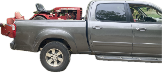

C100_8 25 #14 Posted May 17, 2025 (edited) Thank you for all the information about the 856 model. I've left you all is suspense, but today I have something to report. Did not get the 856 due mostly to the distance, and transmission issue. But today I brought home a one owner 1976 C120 with a 42" deck and a snow blower. According to the owner it never spent a night outside, and the condition of the paint says that might be true. The harness went up in smoke about 5 years ago and it's been sitting since then. I'm pealing it apart now trying to figure out where the problem is. Edited May 17, 2025 by C100_8 picture change 3 Share this post Link to post Share on other sites
