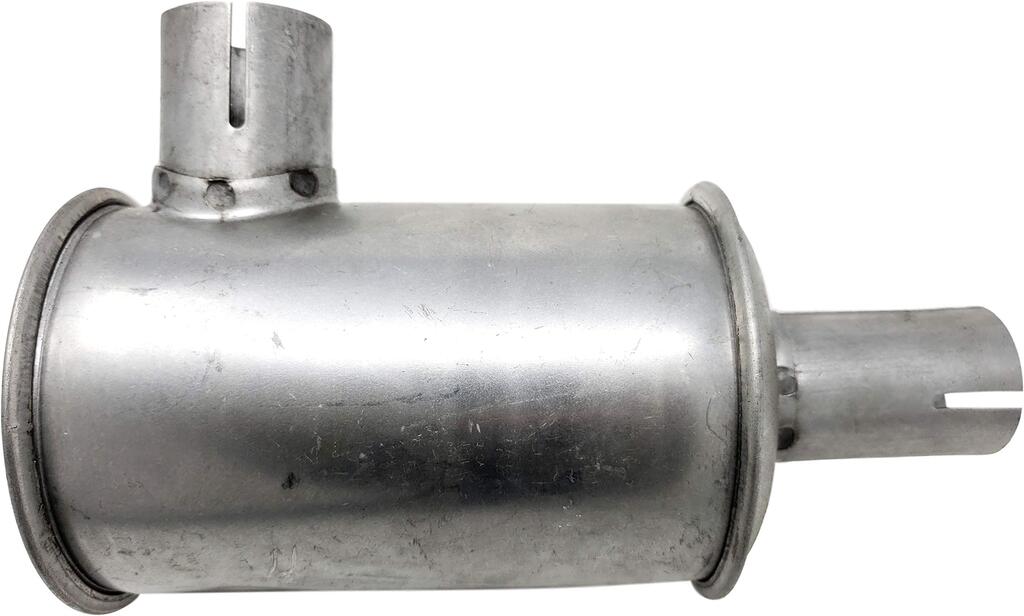

wallfish 20,225 #4 Posted May 1, 2025 1 hour ago, JP56 said: has a support bracket welded on near the bottom, at a strange angle from the inlet & the muffler would hit the PTO, Are you referring to this Stens type muffler? That strange bracket is easily removable and pipe fittings can keep it away from the PTO and hood. Going with a Gravely type muffler might suit your needs better. Pipes can be added on the output too. That 7" muffler pictured isn't going to muffle much just like the pepper pot type don't. It's too small. 3 Share this post Link to post Share on other sites

JP56 42 #6 Posted May 1, 2025 (edited) 31 minutes ago, wallfish said: Are you referring to this Stens type muffler? That strange bracket is easily removable and pipe fittings can keep it away from the PTO and hood. Going with a Gravely type muffler might suit your needs better. Pipes can be added on the output too. That 7" muffler pictured isn't going to muffle much just like the pepper pot type don't. It's too small. I have been looking at this type in the bottom pic too, but anyplace I see these listed I have not found good measurements listed for them, so been hesitant to buy one sight unseen. Do you by chance know all the dimensions on the Gravely style one? The 1' black pipe nipple coming out of my 10HP was so pitted I couldn't get a tight seal on it with anything I tried, so I finally ended up getting out of the block today (it hadn't been touched since the day they put it in at the factory), and it was egged from trying to get it out. Anyway, got it out, now have to pick up some 1"NPT Ell's & a 45 or 2 & a few nipples in various lengths to get it far enough outside the hood & ahead of the PTO Drive assembly. The Stens type was way too long & hits the front right tire unless you put it at a ridiculous angle, & couldn't seem to locate any exhaust tubing that would work with it & no way of making any custom bends even if I did. Going to pick up some black pipe1" NPT fittings - a few assorted length nipples, ells, 45's & a coupling or 2 tomorrow & just double check the OD on a nipple after cutting the threads off one end to make sure it will slip into the Inlet of a new muffler. Edited May 1, 2025 by JP56 1 Share this post Link to post Share on other sites

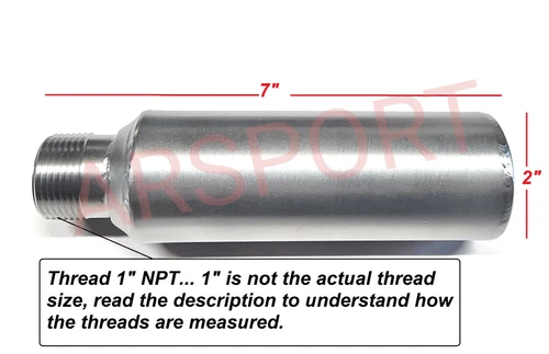

JP56 42 #7 Posted May 1, 2025 45 minutes ago, ineedanother said: Yeah, I'd like to see more about it myself...@jp56 As Far as I can Tell, it appears to be just a straight thru, & it's only 2 " in Diameter & 7" long, so I guess as compared to the OEM that literally fell apart at both ends where the tubes were welded onto it this one really won't do much. Can't find the measurements I took of the old one, but it was I think 4 1/2" dia x 11" long. Here is the link to the one I showed above: https://www.ebay.com/itm/285924801653?itmmeta=01JT4JC3FABMMPMGMXG9ABA9J6&hash=item4292723c75:g:zu4AAOSwkN5lZ5GQ Here is another similar one: Link: https://www.ebay.com/itm/285666860155?itmmeta=01JT4JRVJFQEVMEXJ1VKVNQF3G&hash=item4283125c7b:g:f~kAAOSwAO9lr~b3 1 Share this post Link to post Share on other sites

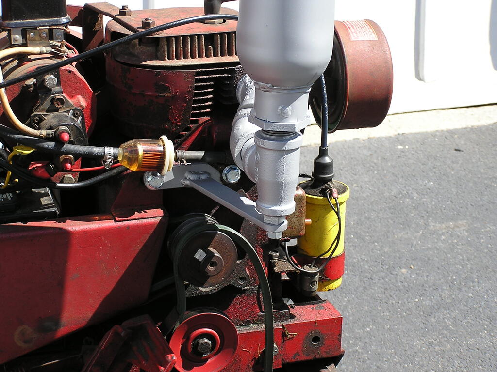

ri702bill 12,498 #8 Posted May 1, 2025 If the muffler is installed horizontally, it needs a support bracket that is mounted to the engine, not the tractor. I made a stack muffler for the 854 a while back using a short glasspack. Used several fittings that are threaded and tack welded. Unscrewing the muffler and support allows removal of the fitting assembly... 2 Share this post Link to post Share on other sites

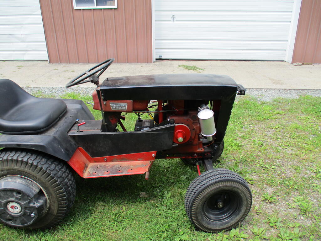

midpack 1,147 #10 Posted May 1, 2025 I have one of the black ones (Stens type) mounted like this on a Magnum 12. I have a short curved length of pipe on the end to turn the exhaust away from me 2 Share this post Link to post Share on other sites

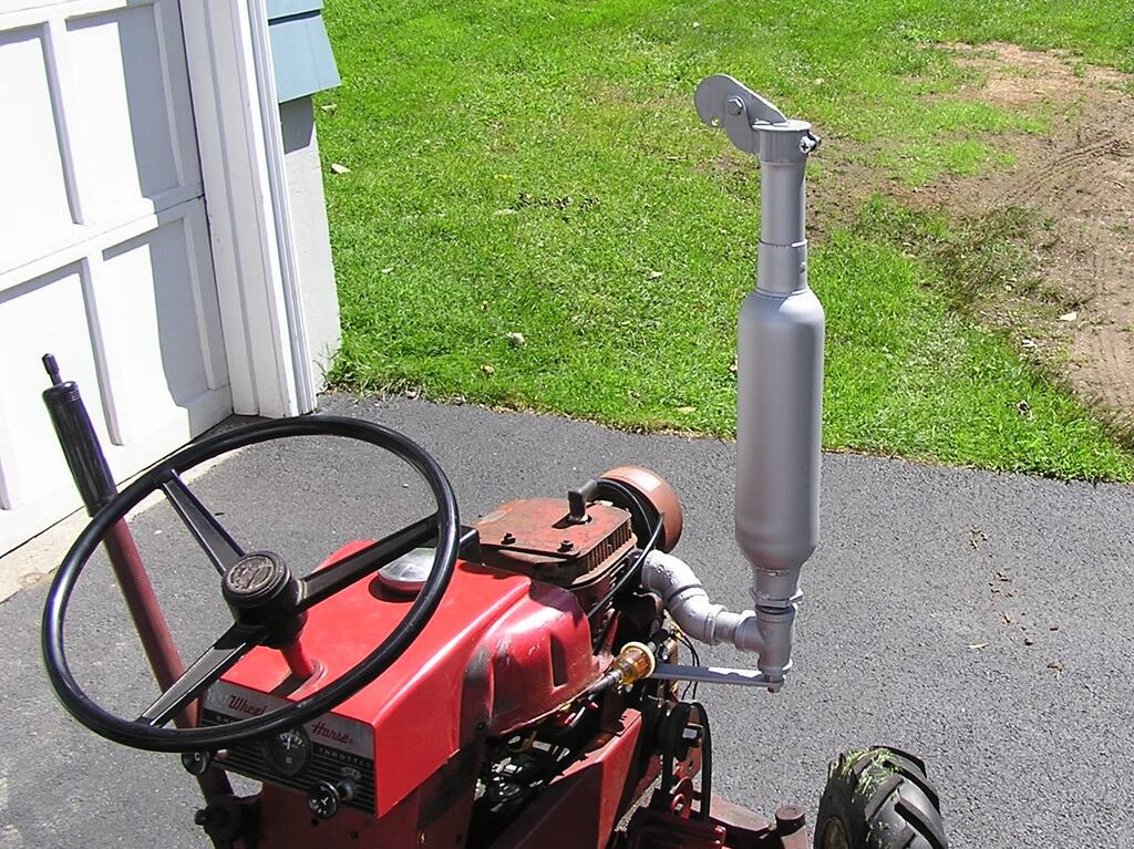

pfrederi 20,874 #12 Posted May 1, 2025 The Cub Muffler and a gravely on 12hp Chargers 2 Share this post Link to post Share on other sites

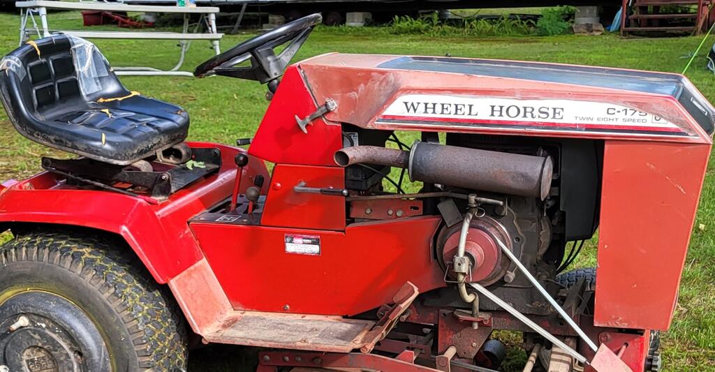

JP56 42 #14 Posted May 1, 2025 8 hours ago, pfrederi said: The Cub Muffler and a gravely on 12hp Chargers I just did my 74 C100 this morning exactly like the one you did in the top pic. 1 Share this post Link to post Share on other sites
