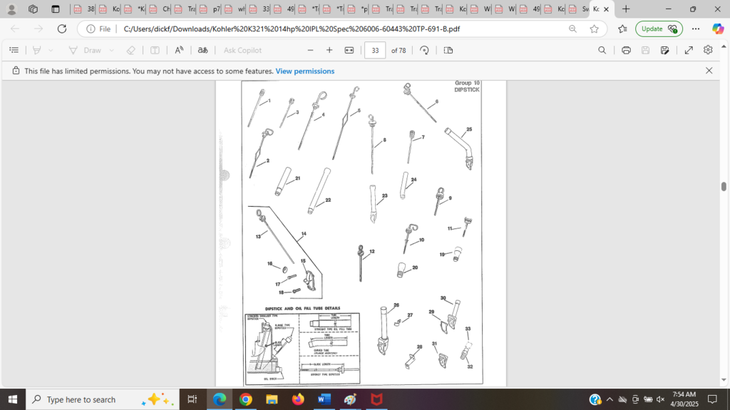

953 nut 69,724 #4 Posted April 30, 2025 If you look at the manual below you will see group 10 is dipsticks and there were a lot of them. Using you engine's SPEC # you can determine which dipstick is correct for your engine. Once you have the part number you could call Lincoln at A-z Tractor to see if he has one. https://www.a-ztractor.com/ 2 Share this post Link to post Share on other sites
