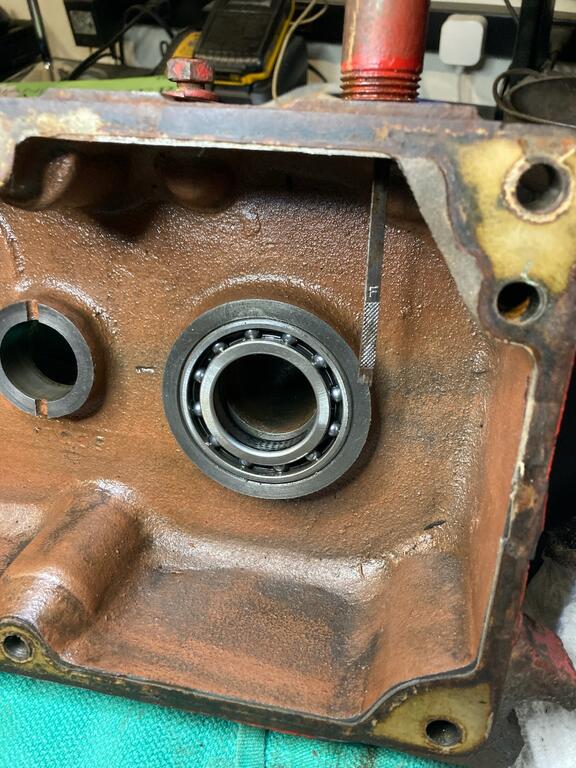

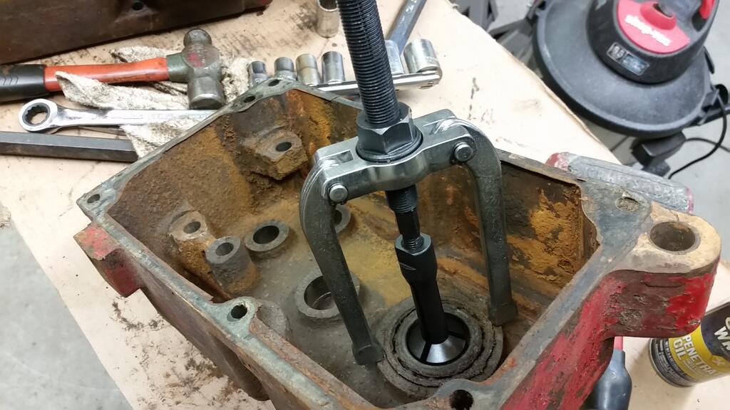

ineedanother 2,866 #1 Posted April 29, 2025 My apologies if this has been covered as I'm sure it has but I can't find it with a search. I'm replacing a case half on a hydro gear box and need to pull and re-use this inner axle bearing if possible. Advice? Share this post Link to post Share on other sites
daveoman1966 3,884 #2 Posted April 29, 2025 Make a 90deg elbow bend in a flat screwdriver. Wiggle that bend behind the bearing inner race, then use a long drift pin from the outside axle tube and tap on the screwdriver bend...gently ,,,moving around the circumference of the inner race. It will move little by little. Been there ---dun that. 3 1 Share this post Link to post Share on other sites

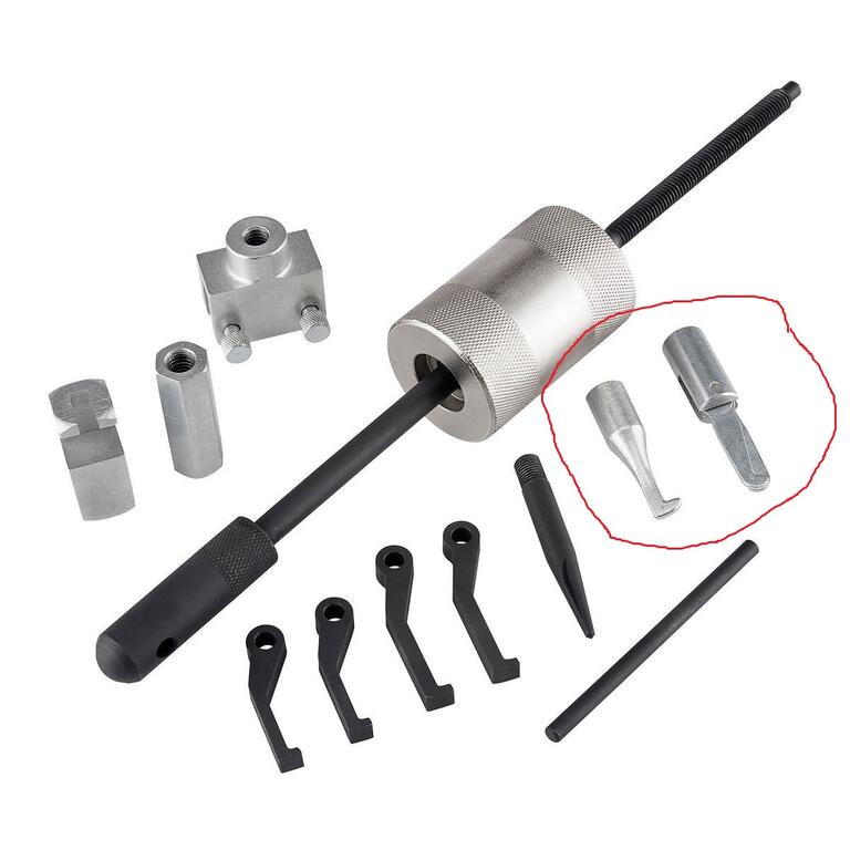

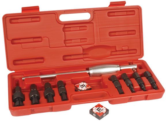

squonk 48,126 #3 Posted April 29, 2025 (edited) I use this slide hammer from Harbor Freight with the hook tool. Or a blind hole puller. Edited April 29, 2025 by squonk 2 1 Share this post Link to post Share on other sites
953 nut 69,345 #4 Posted April 29, 2025 7 hours ago, daveoman1966 said: Make a 90deg elbow bend in a flat screwdriver. Wiggle that bend behind the bearing inner race, then use a long drift pin from the outside axle tube and tap on the screwdriver bend...gently ,,,moving around the circumference of the inner race. It will move little by little. Been there ---dun that. I have used a small wonderbar doing the same as Dave suggested, works well. 2 1 Share this post Link to post Share on other sites
ineedanother 2,866 #5 Posted April 29, 2025 Great info. I think I could make any of those work but I like the thought of having better eyes on with the slide hammer. HF has it in stock locally if I need to pick one up. Thanks guys 1 Share this post Link to post Share on other sites

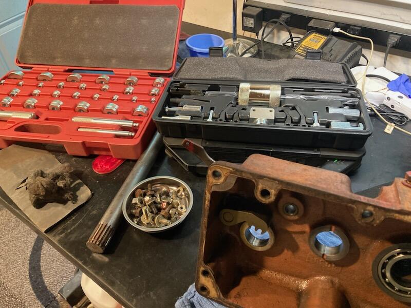

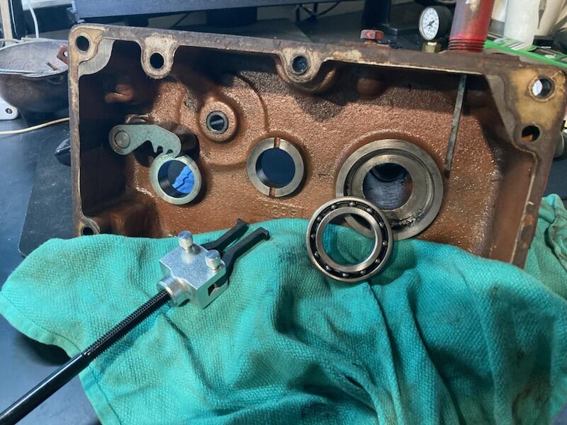

ineedanother 2,866 #8 Posted April 30, 2025 Decided to run out to HF at lunch and pick up a slide hammer set. I already have a driver set that I've found useful as well so I think I'm set Thanks all for the input 4 1 1 Share this post Link to post Share on other sites
