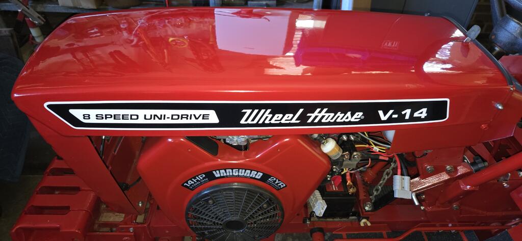

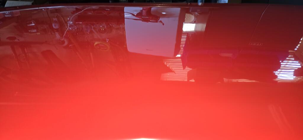

kpinnc 19,105 #129 Posted October 22, 2025 I think I'm finally figuring this rustoleum paint out. Even with hardener it cures like bovine feces! In other words, very slow! Been a couple weeks since I shot this hood, and during lunch I broke out the buffer for a second attempt. It's much better now and while not perfect, at least now I understand what to expect. Minimum 2-3 weeks to cure enough to polish. 4 3 Share this post Link to post Share on other sites
"Manic-Mechanic" 1,486 #130 Posted October 23, 2025 (edited) Best custom work that I have had the liberty to view, greatly impressed! Really loving the suitcase weights to top it off! puts me in mind of “cyclops “ Edited October 23, 2025 by "Manic-Mechanic" 1 1 Share this post Link to post Share on other sites

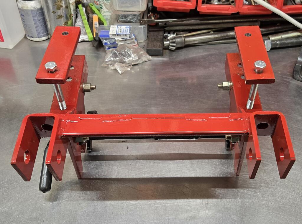

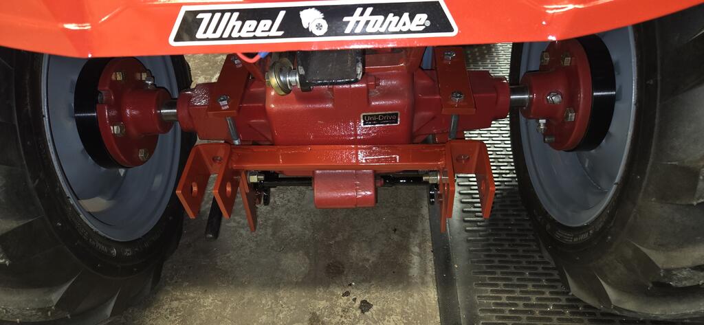

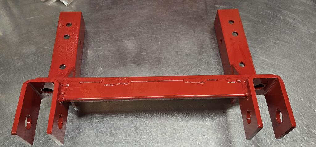

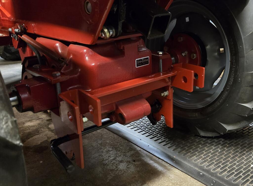

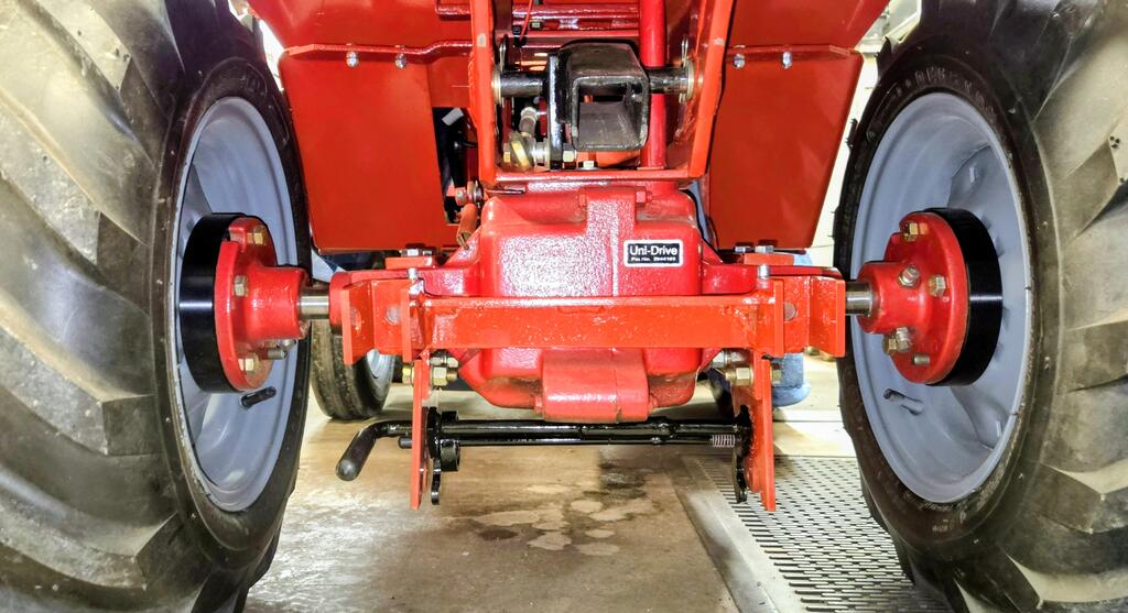

kpinnc 19,105 #133 Posted October 27, 2025 (edited) Got part of the rear hitch work done. That being said, it's a bit odd... I despise trying to get my tiller mounted with those flip down locker cam things. Get one side in, but never both. I need a third hand. So I transferred a belly hitch to the back for my tiller. Now just flip the lever and she locks in place on both sides. I had to make the lock mechanism wider, but it works so far. It is 1/2 inch lower than the OEM rear hitch from the axle but I think that will be ok. The Deestones make it look lower as well. It's also an inch further back towards the rear than OEM, so I'll need a new belt. Mine was shot anyway... The other part of the hitch will be the lower pivot for the 3 point arms. More on that in a few days... Edited October 27, 2025 by kpinnc 6 Share this post Link to post Share on other sites
"Manic-Mechanic" 1,486 #134 Posted October 27, 2025 1 hour ago, kpinnc said: Got part of the rear hitch work done. That being said, it's a bit odd... I despise trying to get my tiller mounted with those flip down locker cam things. Get one side in, but never both. I need a third hand. So I transferred a belly hitch to the back for my tiller. Now just flip the lever and she locks in place on both sides. I had to make the lock mechanism wider, but it works so far. It is 1/2 inch lower than the OEM rear hitch from the axle but I think that will be ok. The Deestones make it look lower as well. It's also an inch further back towards the rear than OEM, so I'll need a new belt. Mine was shot anyway... The other part of the hitch will be the lower pivot for the 3 point arms. More on that in a few days... That’s ingenious! 1 1 1 Share this post Link to post Share on other sites
kpinnc 19,105 #135 Posted October 27, 2025 26 minutes ago, "Manic-Mechanic" said: That’s ingenious! Thank you! I hope it works well. This will hopefully be the "go to" machine for all my gardening stuff. 3 2 Share this post Link to post Share on other sites
"Manic-Mechanic" 1,486 #136 Posted October 27, 2025 24 minutes ago, kpinnc said: Thank you! I hope it works well. This will hopefully be the "go to" machine for all my gardening stuff. Looks good & strong, you have your lift arms? Share this post Link to post Share on other sites

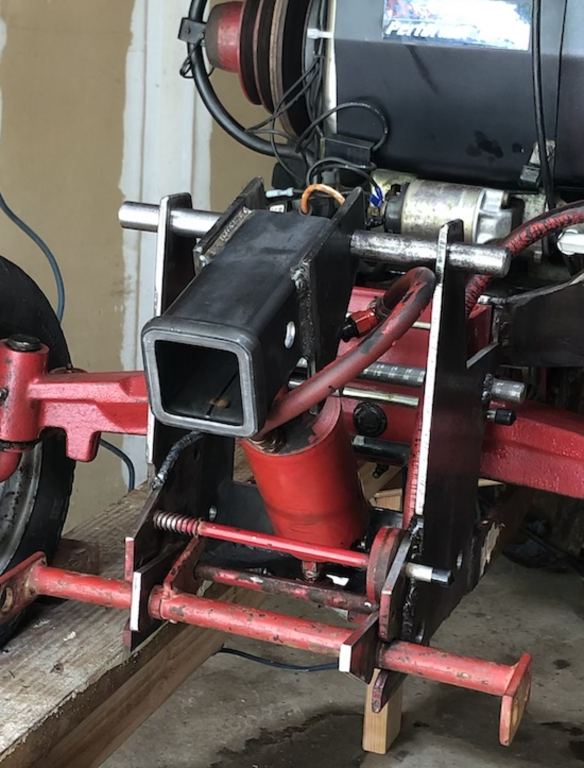

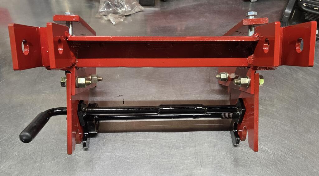

Handy Don 17,735 #139 Posted October 27, 2025 (edited) 10 hours ago, "Manic-Mechanic" said: The mid-hitch mechanism really is versatile and this was a great idea for an application! I used one on the front lift I added to our 518-H++ oriented to handle heavy “down and back” loads. Here it is during the build. Edited October 27, 2025 by Handy Don 5 Share this post Link to post Share on other sites
"Manic-Mechanic" 1,486 #140 Posted October 27, 2025 4 minutes ago, Handy Don said: The mid-hitch mechanism really is versatile and this was a great idea for an application! I used one on the front lift I added to our 518-H++. Here is is during the build. Now that's another ingenious idea! 1 Share this post Link to post Share on other sites
kpinnc 19,105 #141 Posted October 27, 2025 55 minutes ago, Handy Don said: The mid-hitch mechanism really is versatile Yes it is. Kinda wishing I had saved more of them. 1 Share this post Link to post Share on other sites
